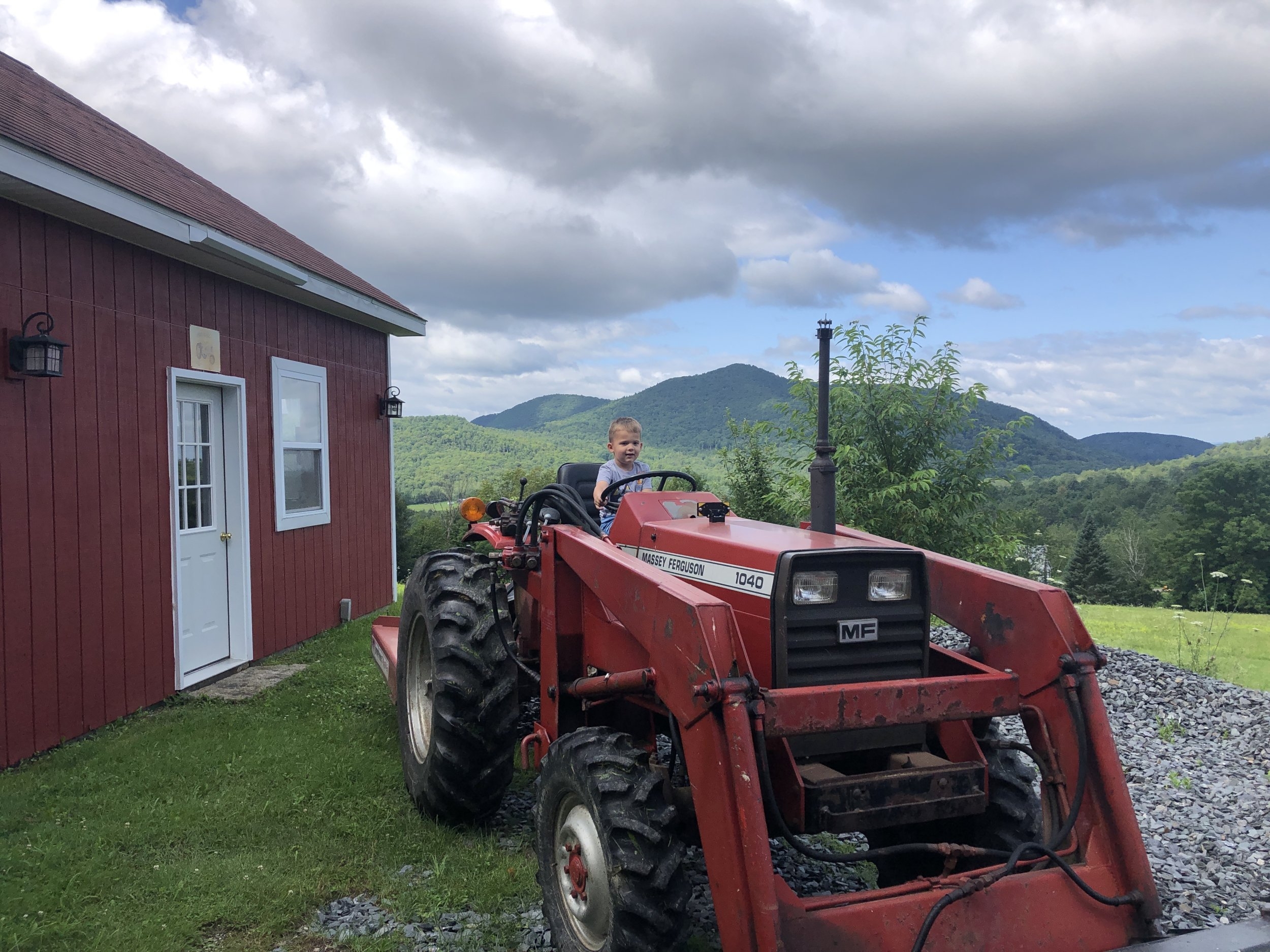

Good Afternoon Grandpa W,
I have owned the big brother to your tractor since 2004. I have the Massey 1040 4WD.I am just wondering if your mechanic checked your fuel injection pump ? On my tractor, probably similar to yours, the pump has three threaded screws on the side of the pump. The bottom screw is to allow you to drain the oil , the middle screw is like a site window that you fill the pump to that level. The top screw is where you put the oil in from. You might try checking that if you have not already !
I bought the tractor with just over 1300 hrs and my hour meter broke about 5 years ago with just over 1700 hours. Im guessing I am closing in on 2000 hours, and the tractor still is running fine.
Glad to hear you got her up and running well again !
