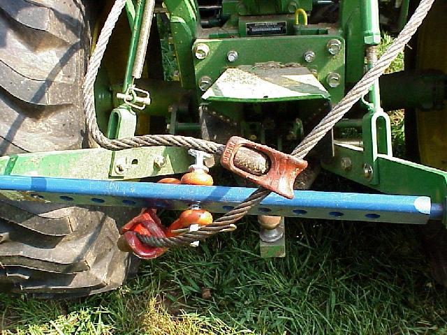

Would you mind sharing your technique for pulling the logs out of the woods with your tractor? Thanks.

Well, I don't have the most sophisticated technique I guess. I've only skidded the ones that were sawed up this go round. But, what I have is a choker cable that I attach to the drawbar. The choker cable is rigged so that when it is pulled on, it just grips tighter. I'll post a picture of the rig with this.
The most important thing, I guess, is to make sure you have a path that is negotiable to and from where the logs are. There were a couple of extremely nice cherry trees I had to pass by this time around because I didn't have a winch to pull them up an embankment that is about, oh, 40 feet or so and there is a gully at the bottom of my bottom land that can't be safely crossed with the tractor.
Other than that, I'd say it was just a matter of making the logs of a size that my tractor would handle. The huge walnut log, for instance, I had to cut into 10-11 foot chunks to make it manageable. Even at that I figure the main trunk portion weighed about 5,000 to 6,000 pounds and I had to clear some underbrush to get to it.
I'll be happy to answer any specific questions if I can.

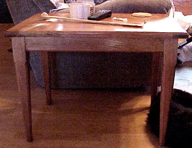

I just finished making an end table for my living room. Replaced a metal and glass thing we've had forever. I made it using 8/4 cherry stock (that I had to buy at $9 a board foot if you're wondering why I wanted the cherry lumber - the CFO puts her foot down occasionally when it comes to $80 pieces of wood.)
Anyway, made the legs with a taper from 2" at the top to 1" at the bottom with a nice chamfer that left the legs octagonal. The top was glued up pieces that I picked for the grain. One piece actually had a little "birds eye" type effect in it. Joined the top with a biscuit joiner and used a polyurethane glue for strength. Chamfered all the edges on that too.

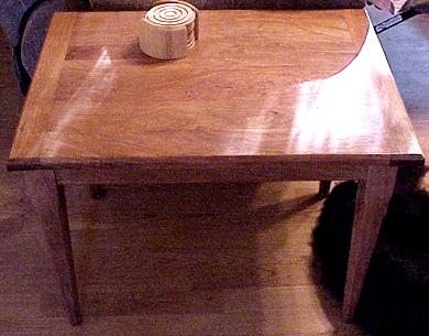

Here's a view of the top of the table.

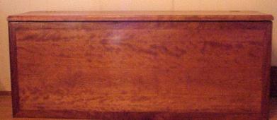

I just love wood. Thanks, and I'm attaching a picture of a window chest that I just made. It's made of 3/4" cherry plywood for the panels set into a flush mounted kiaat frame. Kiatt is an African exotic that, when it is nice, is extremely beautiful. The lighting in the picture wasn't the greatest.
I built it because we just had the picture window put in, it replaced a couple of single windows and I needed something to kind of "center" things.
It serves as a bench for additional seating as well as blanket storage, etc. The top is 1" thick bookmatched cherry planks.
Steve Wells

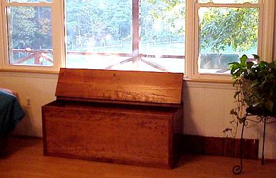

Here's another view with the top open. I recessed the hinges for the top so they aren't too obvious. They are brass and sit in hand cut mortises.
Steve Wells
