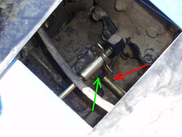

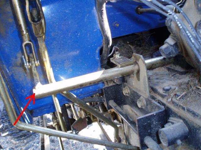

jinman, take a look @ the first pic below. The shift lever when detched from the pto shift rod works great. The red arrow points to where I had placed the visegrips. This is the rod that has considerable resistance, so much so that when the control lever is attached, I bent the control lever trying to move it. The next pic shows where this rod connects to the pto valve. This is under the seat. Two arrows, one green, one red. Are talking about where the green arrow is? Lube where the rod enters the valve?

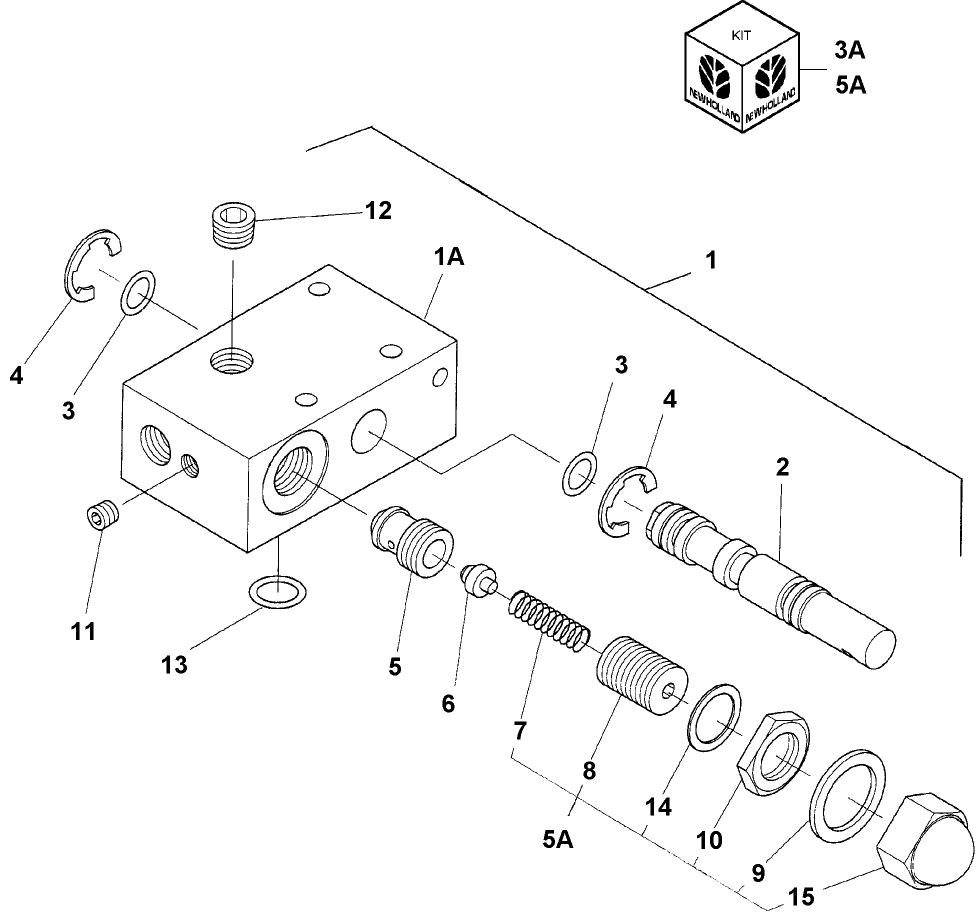

one more pic, this a schematic of the valve itself.
Well, I'm a little embarrassed because I was looking at that hairpin on the top shaft and didn't realize it was the 3PH lowering valve and shaft that comes out under the seat. It's been awhile since I looked directly at the PTO valve.:eek: But yes, the shaft going into the valve at the red arrow is the one that I should be talking about. That small valve on the bottom is the PTO valve. It sits directly on top of the transmission case. You could lube where that shaft goes into the valve, and you could lube on the other side of the valve where the C-lock ring is located. If you can't get it to loosen up, you might have to take the C-lock ring off and disassemble the valve. Since you have the illustration of the valve, you have most of what you need. I would probably clean that area well before any attempt to do disassembly.
Most of the time the binding is in the pivot, but you said that is very loose now. It sounds to me like you are doing all the right things. Of course, you also have to be concerned that the valve's orings and seals are not damaged or you might end up with a seeping leak. You said you could turn the shaft with the vice grips, so hopefully a little lube and working will get it loosened up.
