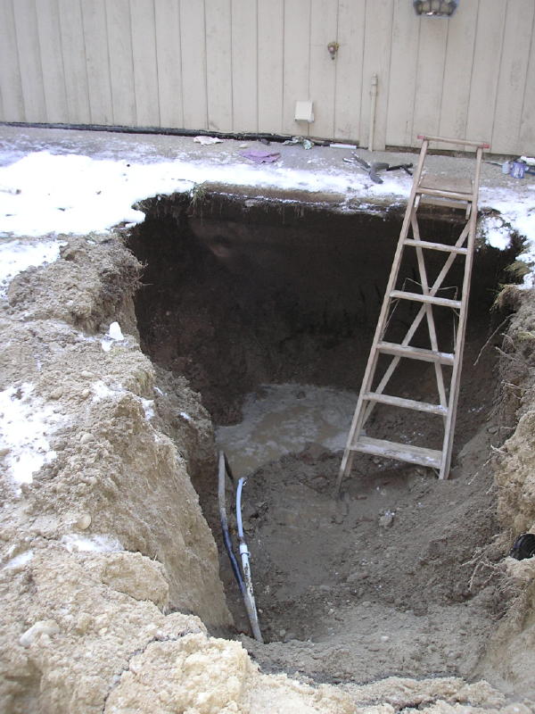

Cover the top of the hole with card board , plywood anything you have to prevent the ground in the hole from freezing. I fixed a water leak at -15C one winter and the dirt pile got froze solid all I did was put a piece of fiber glass insul. over the pipe and cover the hole with plywood until the dirt thawed in the spring.
   / Frozen fill dirt on water line? #12
Cover the pipe with something - sand then insulation or straw. Cover the hole with plywood. This should prevent the pipe from freezing. You should not have to run the water if the hole/pipe is properly insulated/covered. Back fill the hole when the dirt thaws.

Cover it with about 4 inches of blueboard or styrofoam and then sand if you have any. The styrofoam should protect the line form hard frozen chunks and it will keep it from freezing and make it easier to find later if it needs to be dug up.

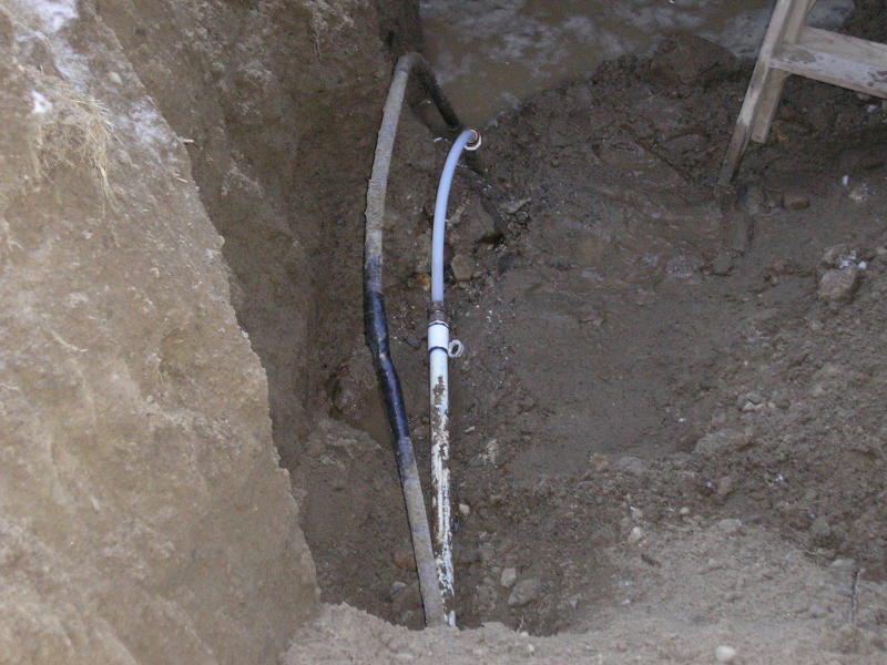

   / Frozen fill dirt on water line? #14
This is the repair I made that waited until spring to get back filled & not leaving the water running with just a couple pieces of 2" blue sm Styrofoam and covered the hole with plywood. In the spring back filled to within a 1' of the surface with sand then top soil. This avoided setting.

I checked the sand this morning and it's pretty hard/frozen - perhaps just buy a bag or two of top soil and combine with insulation and plywood?
   / Frozen fill dirt on water line? #16
I'm concerned I might give you advice then that darn thing freezes. If you cover the insulation with some 6 mil. poly then use some chunks of froze dirt to seal the edges and cover the top of the hole with plywood you should be good to go. I'd didn't have poly on hand so if I remember correctly I used cardboard which also has some limited insulation effects.
   / Frozen fill dirt on water line? #17
If you have a backhoe you could find a spot to dig down deep to get some warmer dirt. Put this over the insulation and call it good. Watching the weather I would get this done quick.
Rereading the thread I see the hole is only 2'x3' and about 40" depth. If you add an additional layer of insulation board you should be able to use any dirt you have that is not frozen and will tamp down tight.
   / Frozen fill dirt on water line? #18
Depending how worried you are about this, i have rented and used automotive steam cleaner to thaw frozen groung in the past. Works like magic. Its amazing how fast it thaws frozen ground.
