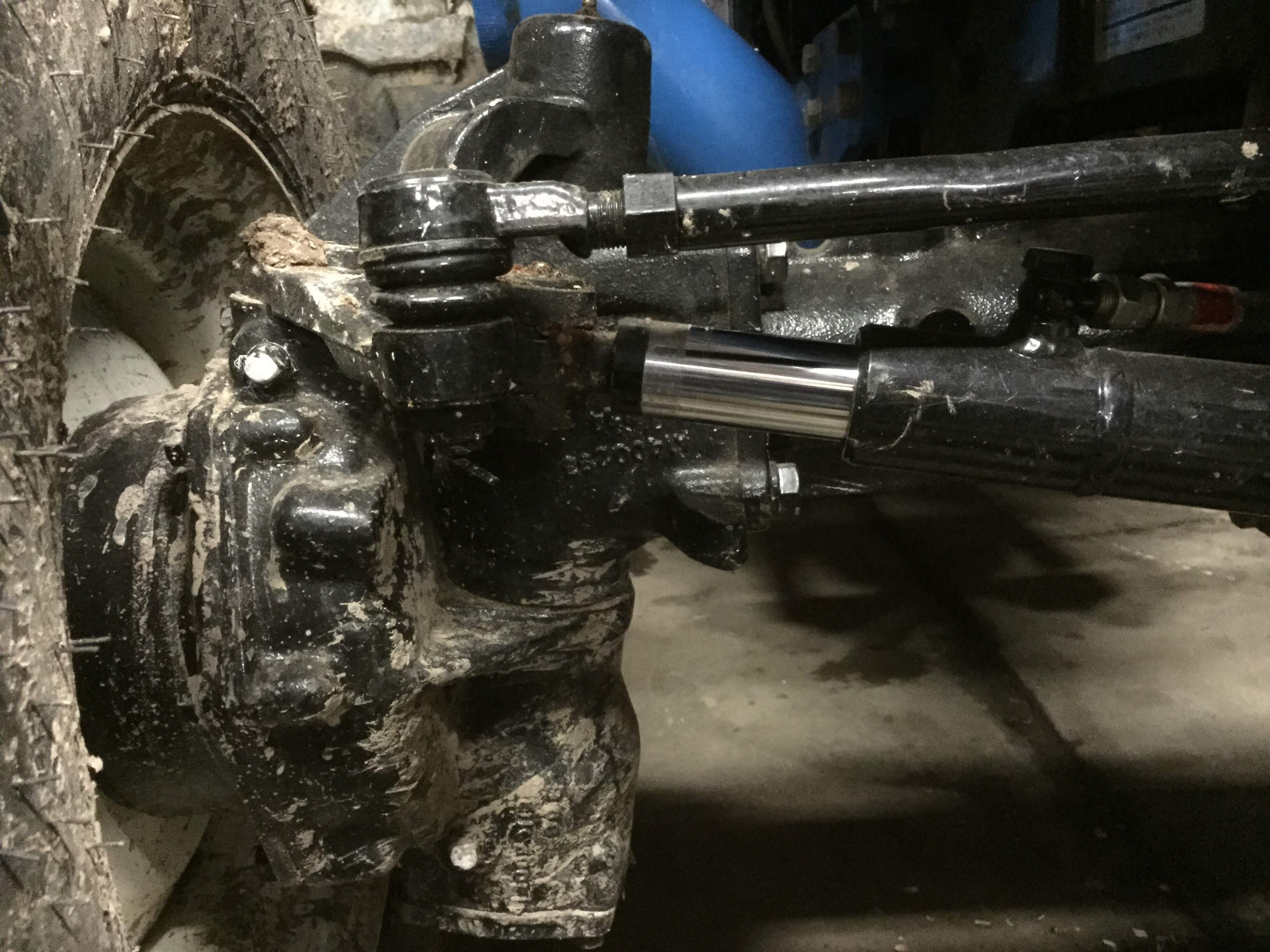

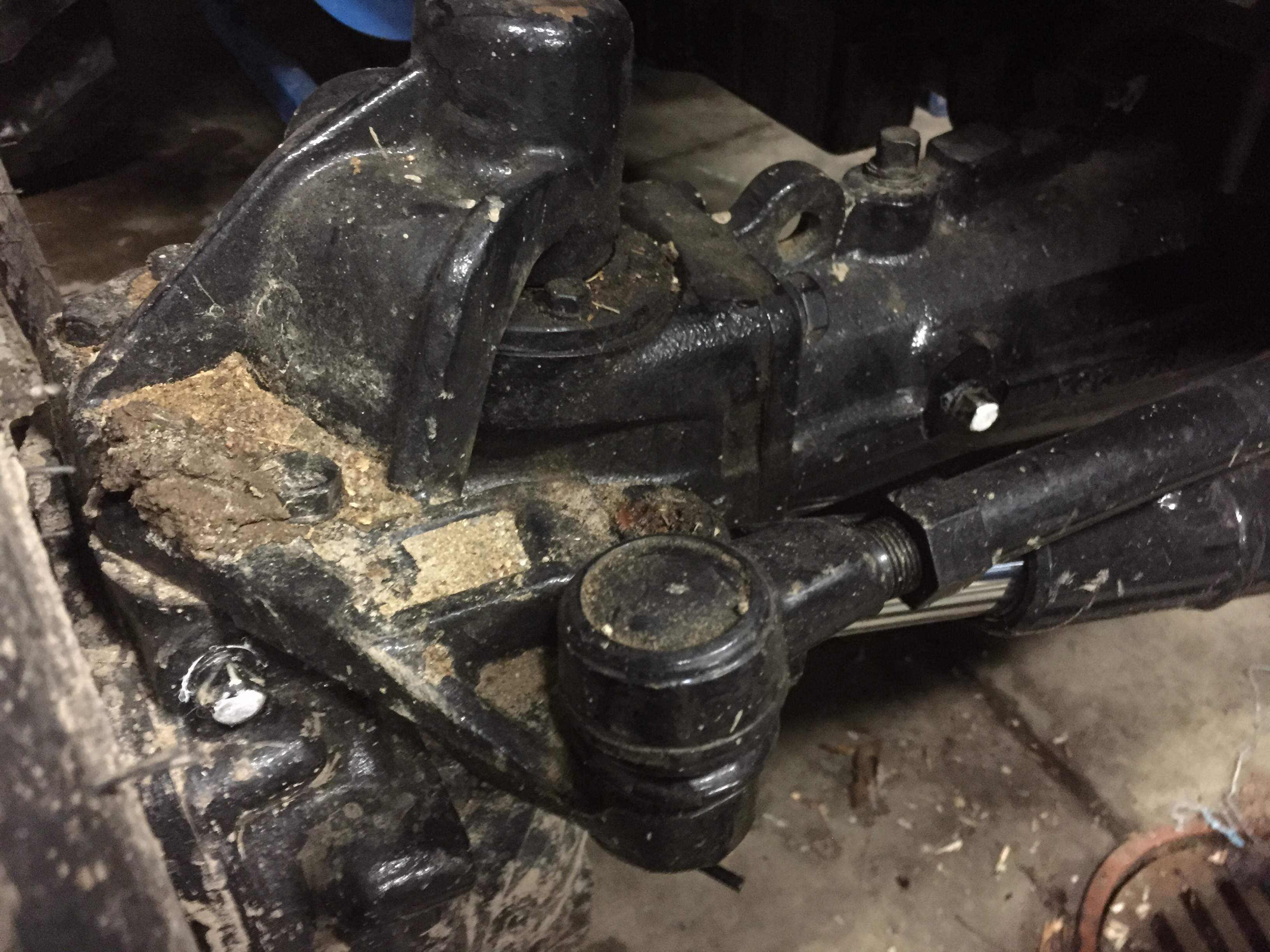

While we're on the subject, there are 2 more plugs out by the wheel. I know the bottom one is a drain but I took the top one out and the oil level was down about 2" , it was the same on both sides. The plug on the right of the pic (towards the center of axle) was full. It appears the plugs out by the wheel are at a higher level than the one towards the center of axle.
Question is;
Is that all the same as the axle or should the plugs by the wheel be filled up to the plug?
I'm having a hard time explaining this, I hope the pics show what I'm trying to ask! :)
Question is;
My axle is made a little different than yours but the oil level where I check mine at is down about 2 inches as well.

the oil is all shared in the front axle the top outer plug is for air release when filling the center plug on main housing is the proper fill level
/ front wheel seals #14
Thanks, that was the answer I needed! :thumbsup:
