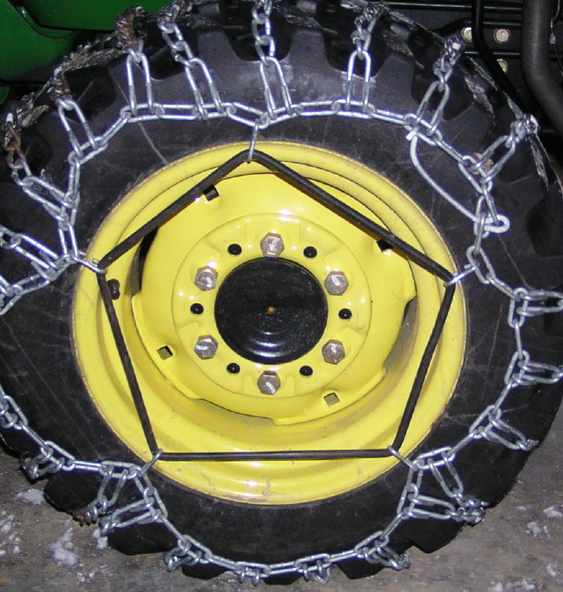

On my 3320 there are two sets of holes: one for normal and one for reversed mounting, see photo. The two sets of holes have the chamfers and rim supports on reverse sides. If you don't have the two sets of holes, the wheels may not have been designed with reversing in mind.

I was thinking about the same set up as yours with front chains, do you only have them on the fronts or on the rear also? at first I thought the 3 link spacing was the way to go, but after seeing yours I think 1 link spacing would be better.
I have a 4310 with R4's and it looks like there wouldn't be a problem with clearance, did you have to reverse your rims, yours tires look to be about the same size as mine.
I do loose traction some times on steep drive even with 4x4 so I thought a little help up front would be enough, as opposed to the cost and work involved with rear chains.
Sorry for hijacking your thread jdgreg.
