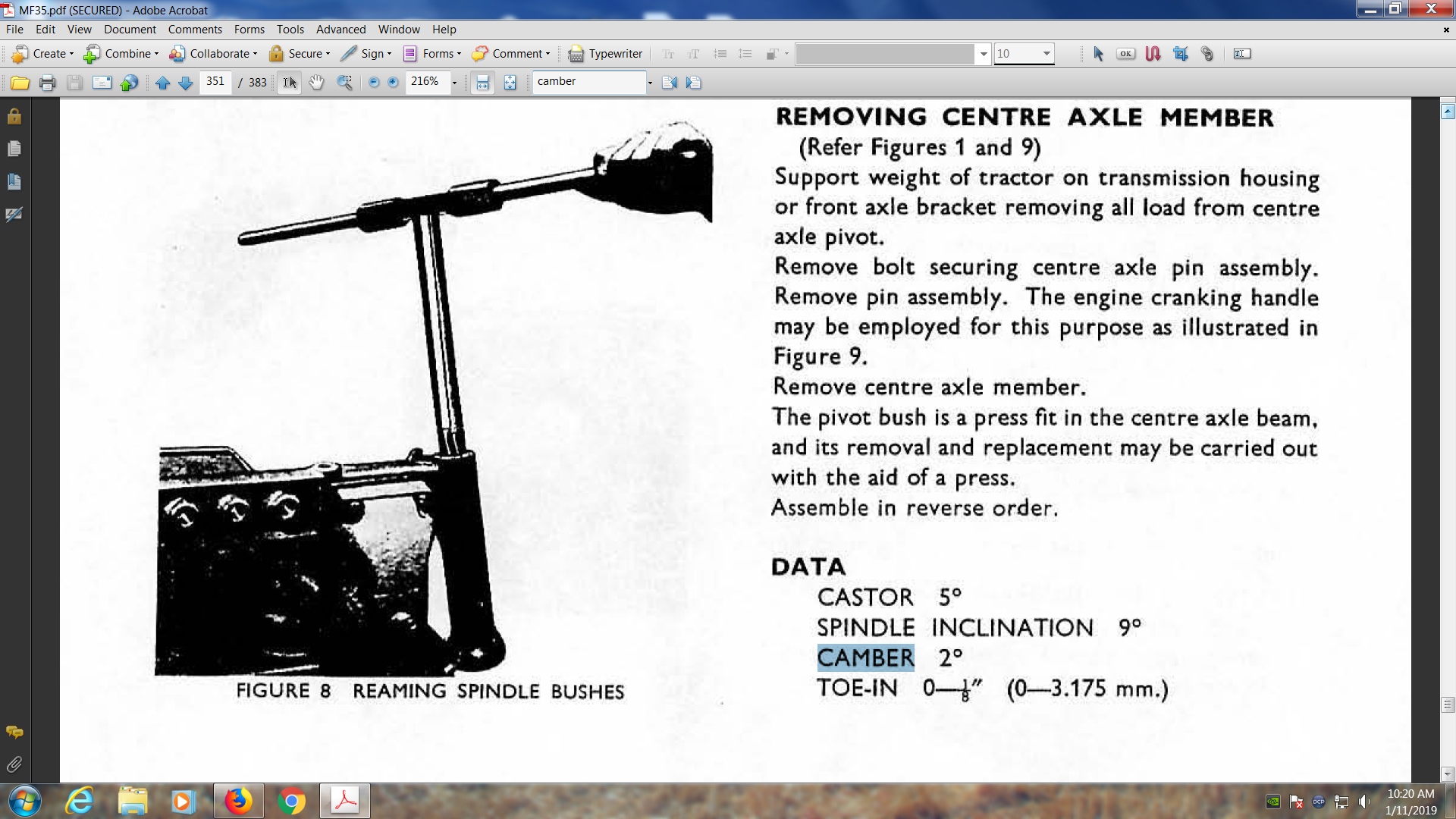

After downloading the manual and converting to text I found the toe instructions on page 348.
ADJUSTING FRONT WHEEL TOE-IN
Front wheel toe-in should be 1/8 in. (3.18 mm.)
To adjust toe-in proceed as follows:-
locate tractor on firm level ground.
Place front wheels in straight ahead position.
Using a suitable track gauge. check toe-in.
If adjustment Is required the pinch bolts clamping
the drag link ends to the drag links should be slackened
off and the drag links rotated clockwise or
anti-clockwise to increase or decrease toe-in as
reqUired. Adjustment should be made equal ly to
both drag links. This may be checked by noting the
relationship of the rear drag link ends to the footrests.
When the front wheels are in the straight
ahead position the distance between the rear end of
each drag link and the adjacent footrest should be
equal. Tighten drag link pinch bolts when adjustment has
been completed.
Remove track gauge.
Move tractor until front wheels have rotated 180°.
Re-check toe-in.

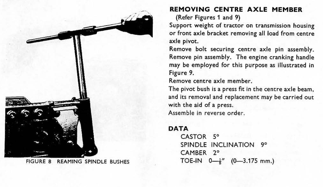

I also found the full front end specs.
