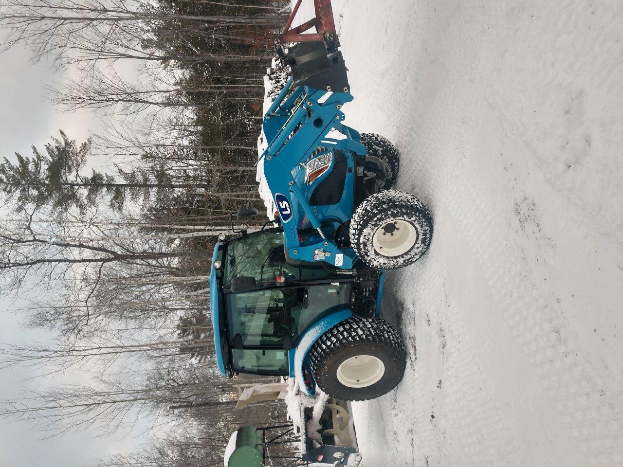

I use a rear blade mounted on a SSQA adapter on the FEL and a pull blower on the 3ph. I get 120-140" a year...flat driveway...80'x80" area to clear between drive and pole barn...loaded turfs. Last year was first year. Never had more than 10-12" to deal with. Worked very well.

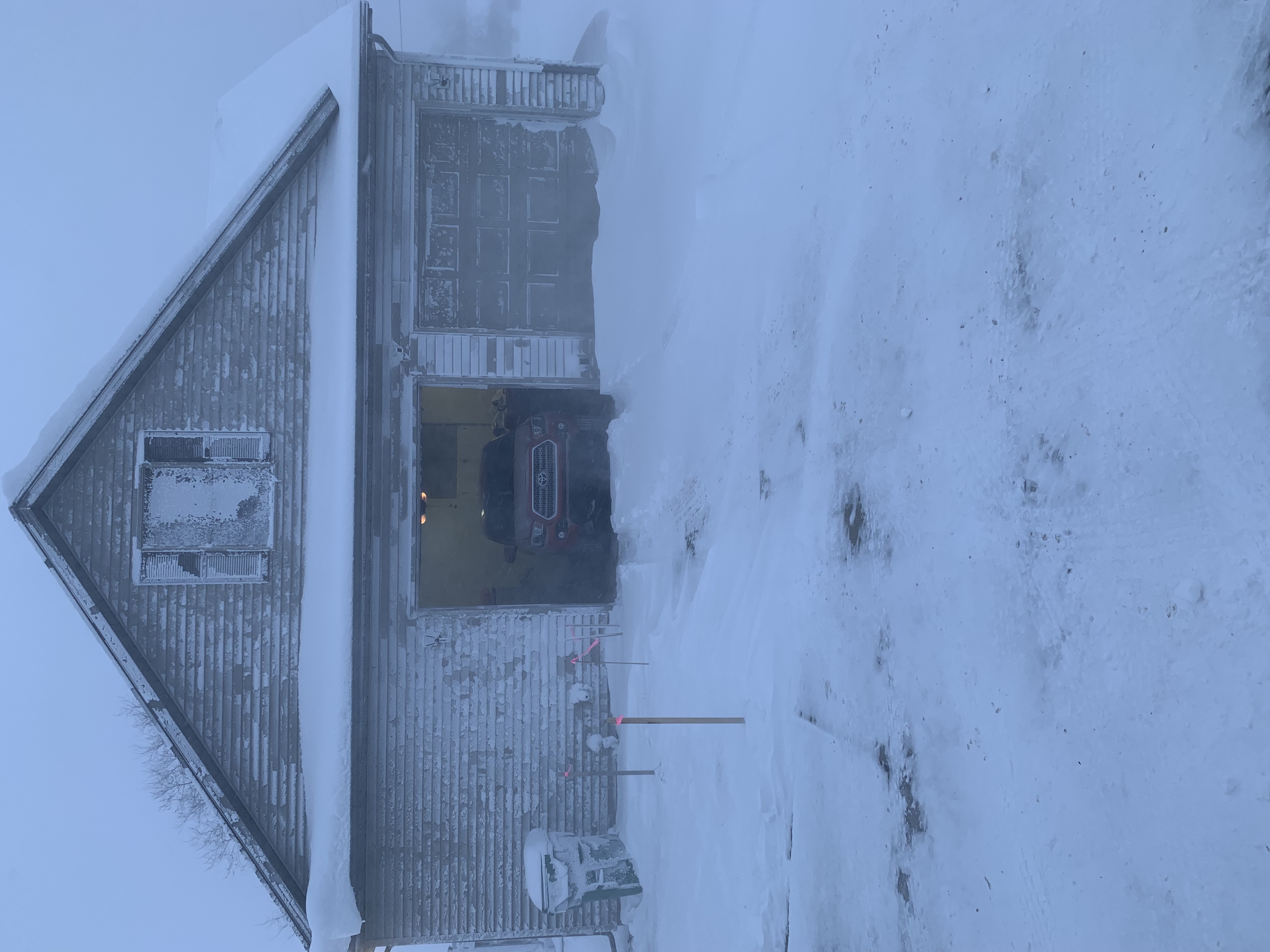

My “plan” is to use a pusher and back blade although admittedly I won’t be plowing gravel drives. Back up to OH doors, drop back blade and pull snow out far enough to use pusher. I won’t have to change directions which will save a ton of time. I live in Lake Michigan snow belt so I have to be ready for anything. If really deep I’ll head out with bucket. Wind is crazy here. Last year was a bust but this is a pic from 2019.
I PM’d someone on this site that uses a pusher on gravel I think and he liked it.

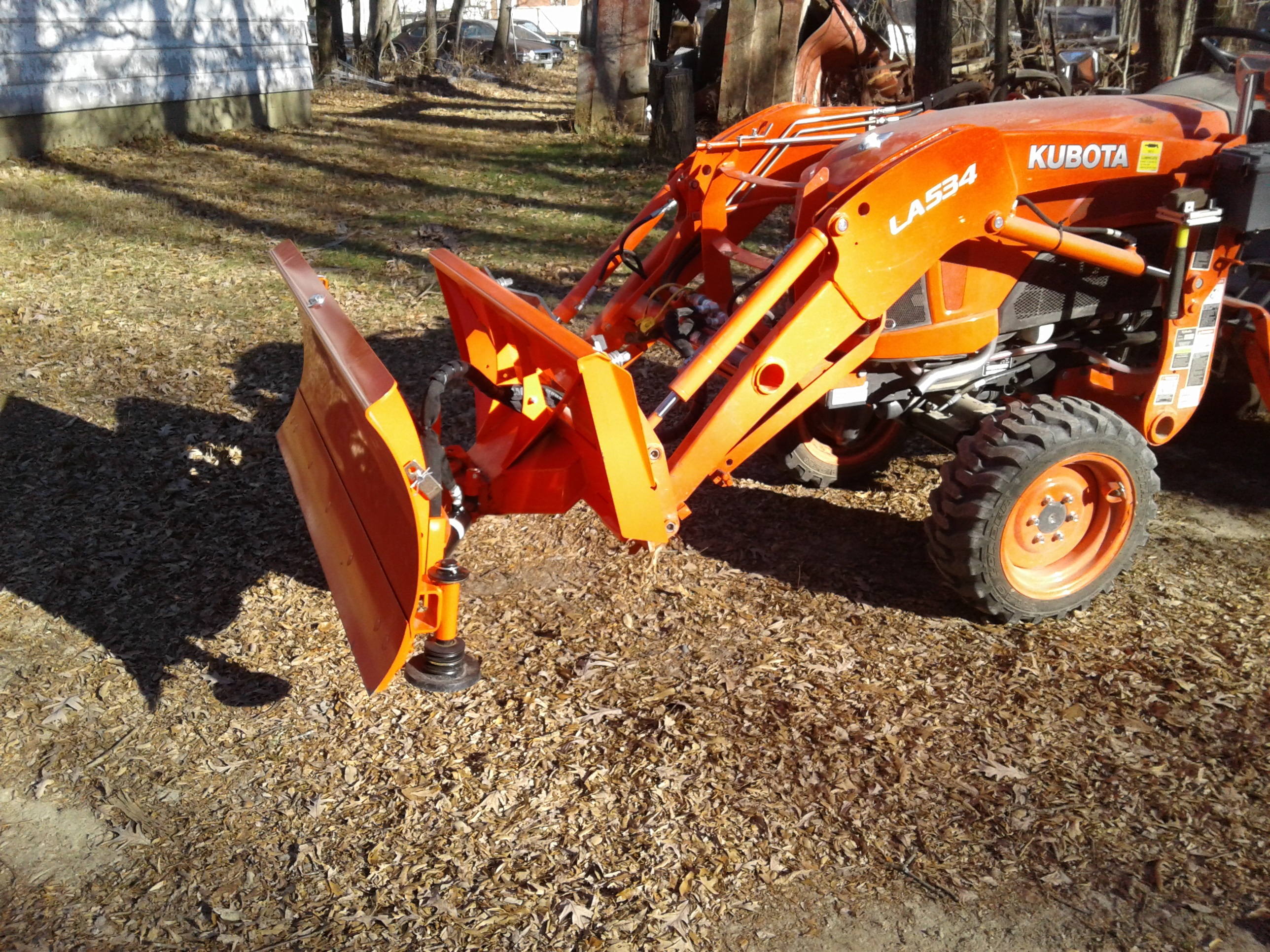

Funny thing with FEL plow when you angle the blade it also tilts. You have to adjust curl cylinders to make blade level again. The skid shoes on the plow keep digging into my gravel, think it needs wheels like a state truck has. It maybe years of only having a rear blade but I just use rear blade now, less hassle.
If you set the plow frame parallel to the road the blade will stay level at any angle.

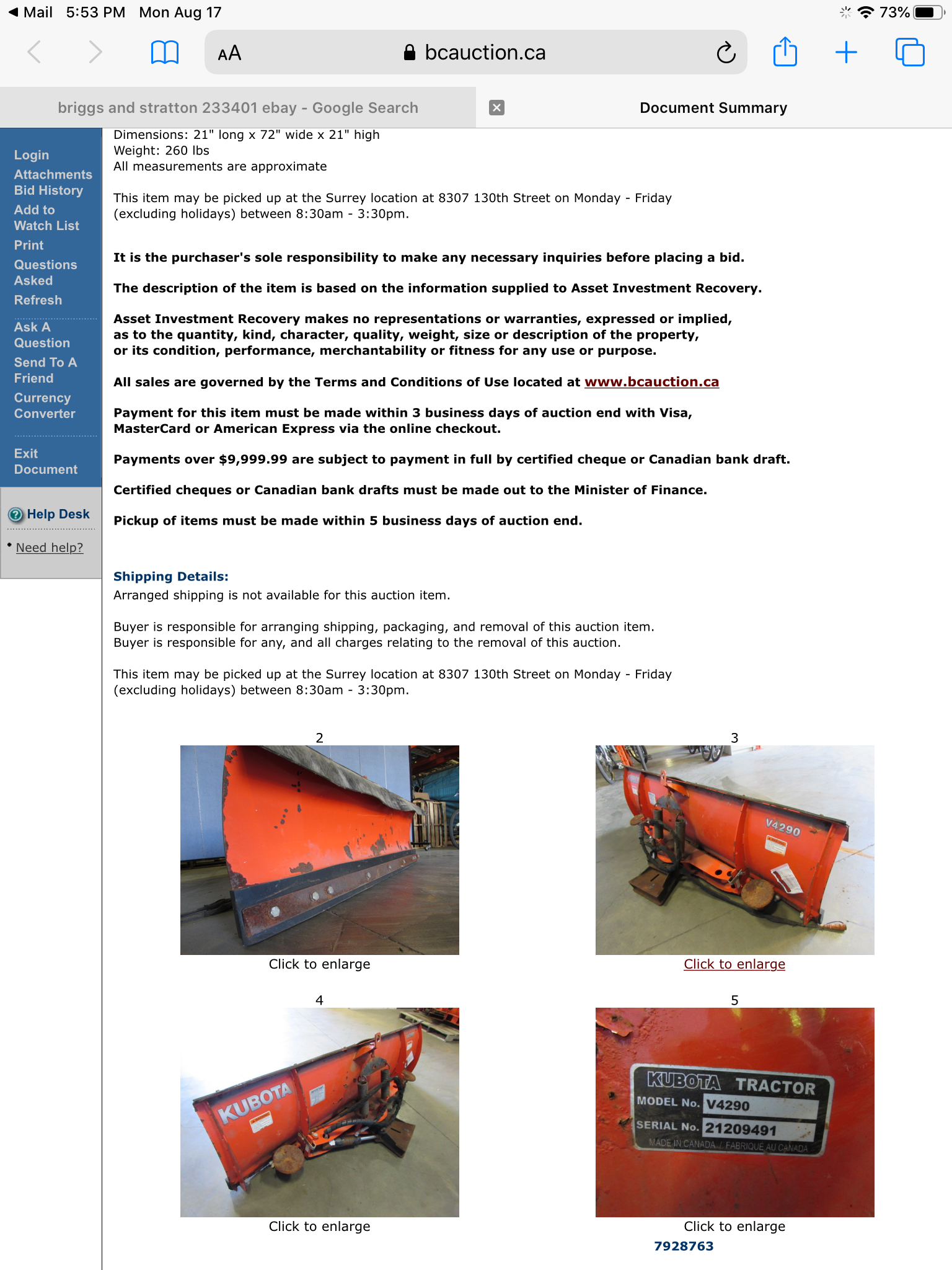

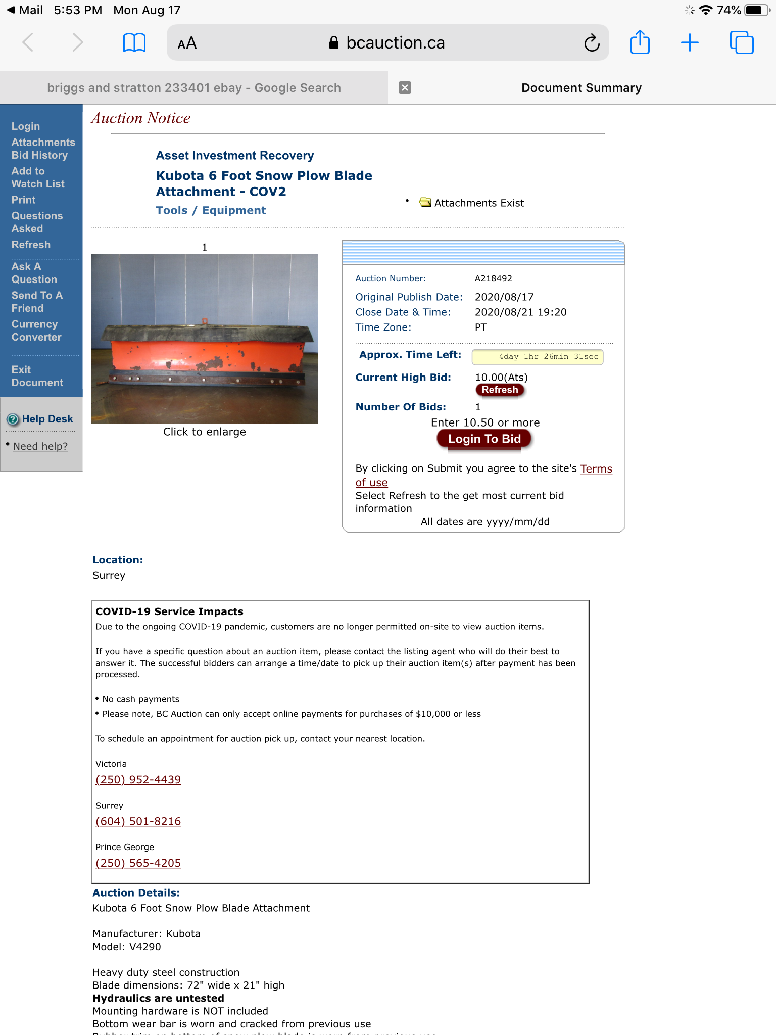

Not certain if this link is viewable or not but may be of interest to any members in BC.
Document Summary
