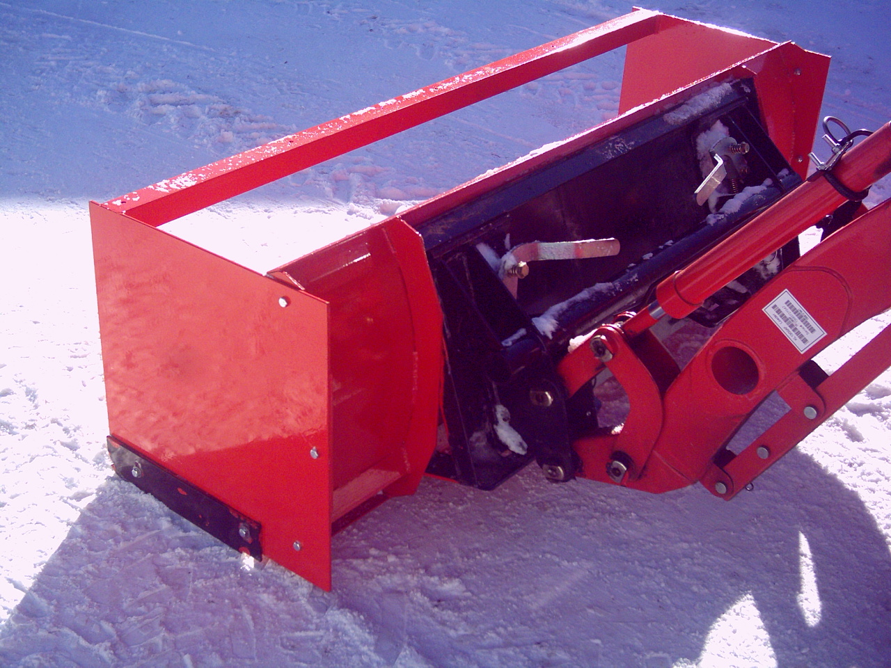

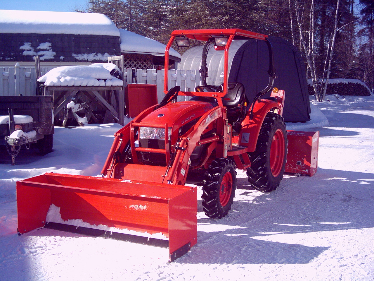

I have a front blower on my 17hp kubota and does a good job but now i also have my CK30 HST and would like to use it, Im thinkin a box blade that quick tatches . I,m going to make my self. Anyone have one Size and pics would help.
   / Front snow blade for a CK30 #11
Here is one i have made myself, it's a push/pull type with a skid-steer attache. The blade is 66'' wide and 22'' high. The side-plates are 21x21 1/4 thick. All this cost around 300$cnd to build.

   / Front snow blade for a CK30 #12
Thanks you did a very nice job:thumbsup:
Did you roll the back or just brake it?
what did you use for the blade edge?
I was thinkin of making mine so it could float in case one side needs to
be higher as my ground is rolling and uneven?
Its alot more work though.
HB
   / Front snow blade for a CK30 #13
HB
Thanks, glad you like it. I did brake the blade, had to do with the tools i have. The sides have floating shoes, and i used T-1 steel for the cutting edges and side shoes. This is the 2nd snowplow i make, so next time it will be even better, probably add a trip edge.;)
