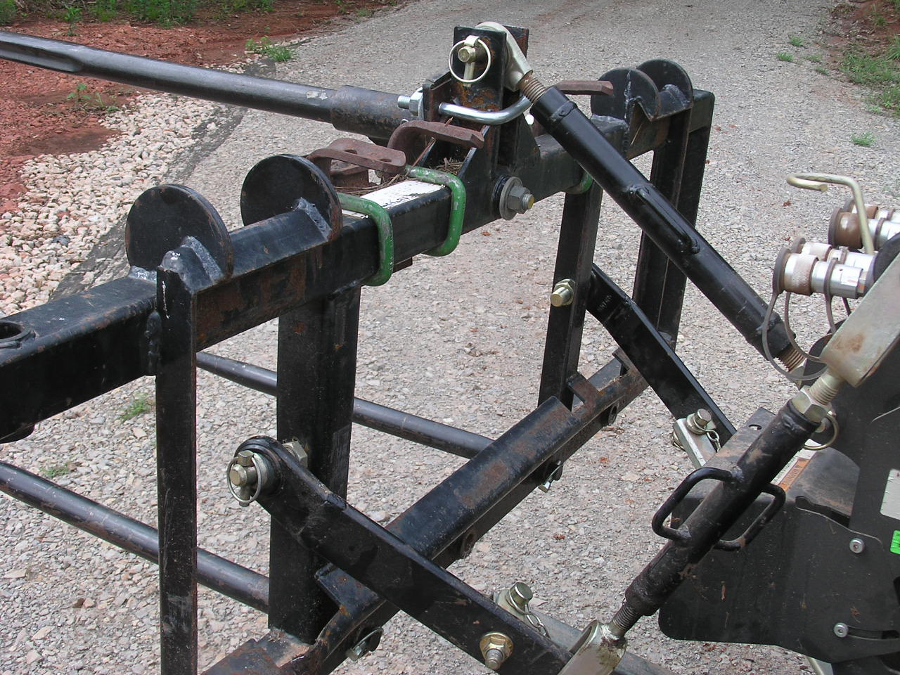

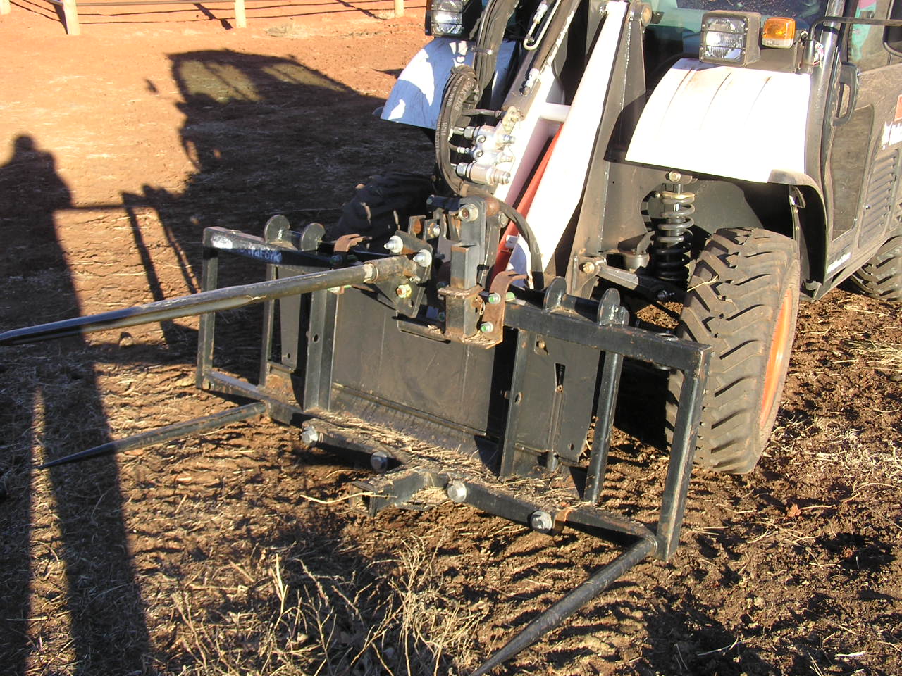

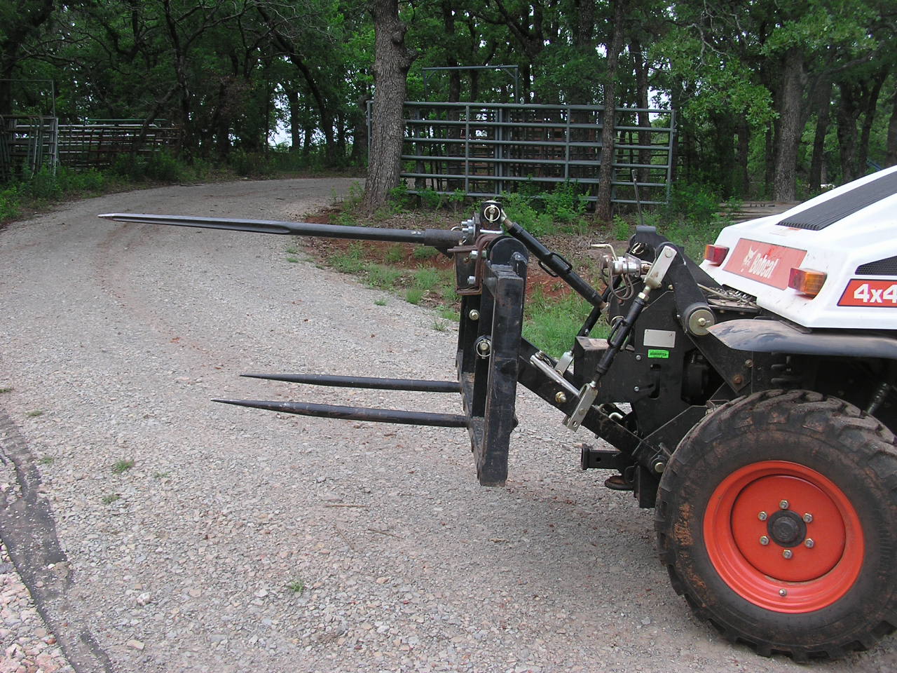

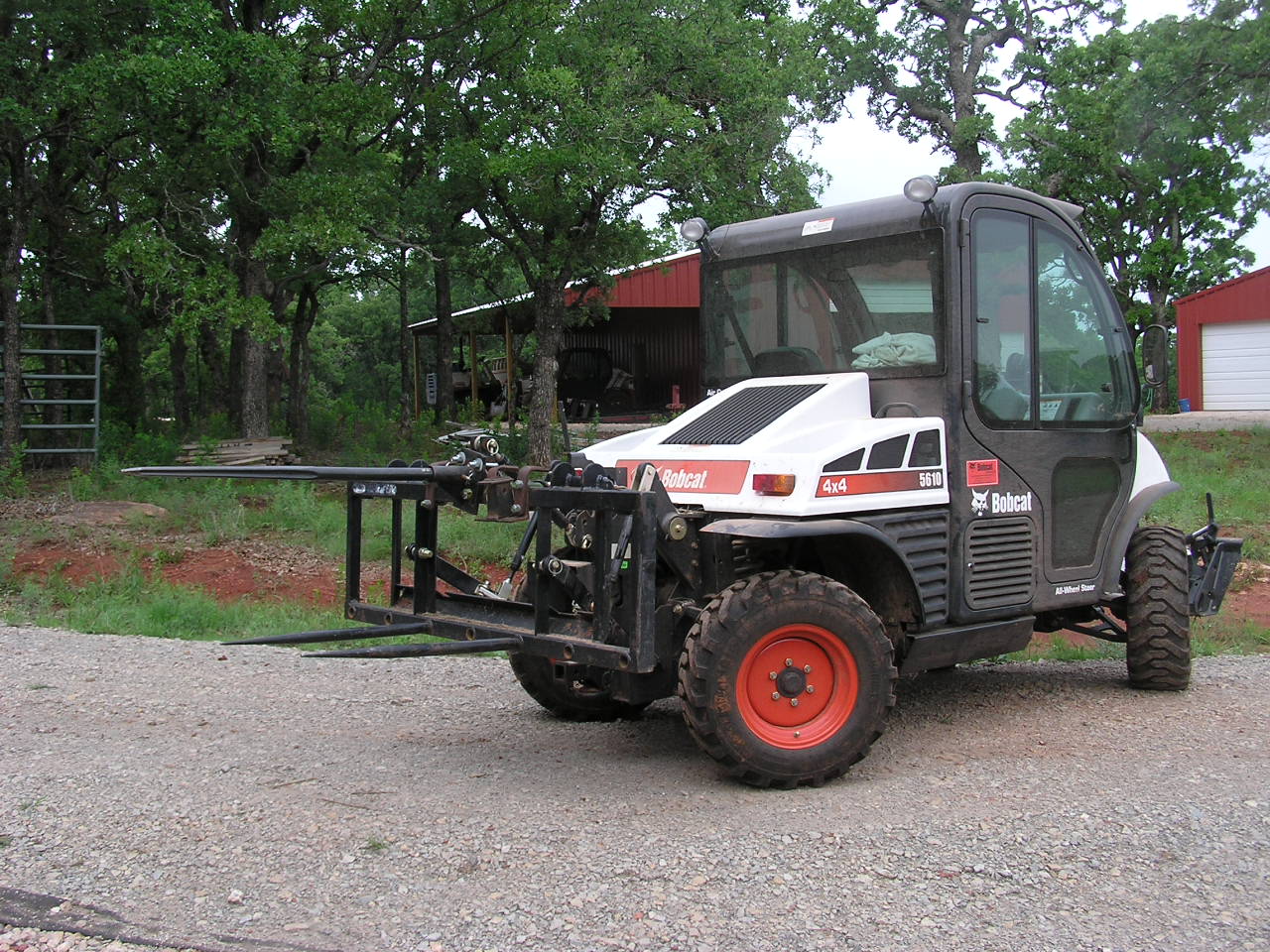

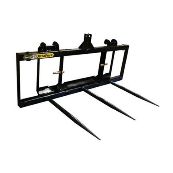

My two way frame might give you some ideas on how to do it.
On the rear 3 point hitch:
And mounted on the front SSQA:
   / Front pallet fork frame also for 3 point hitch #7
   / Front pallet fork frame also for 3 point hitch #8
By having the forks that far forward you are losing most of what you gained by not having forks on the front of the FEL bucket like we all do. To make a significant weight gain the forks need to as close to the tractor frame as possible like the fork attachment for a skid loader.
Ron
I edited my previous post to clear up your confusion. No problem with 5x6 round bales:
The front bale is on my 6' pallet forks.
