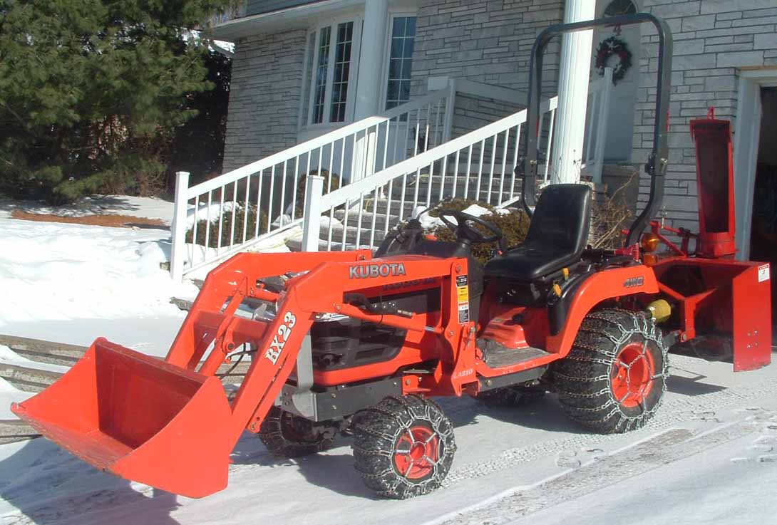

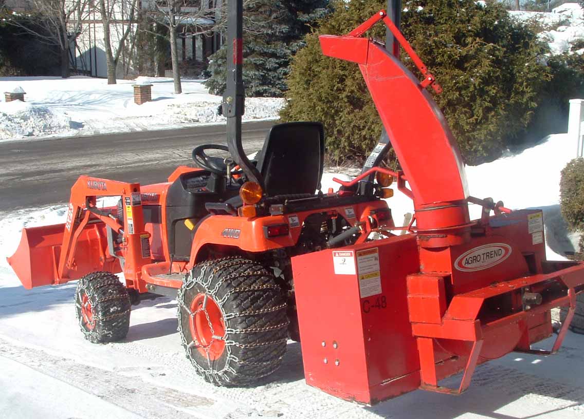

I recommend a new type of rear snowblower – it is referred to as the “pull type”, or the “reversed” or “inverted” snowblower. The reversed snowblower is easy and pleasant to operate compared to the conventional rear mounted 3pt design which I was using previously. The inverted design has the advantage of doubling as a type of boxblade to scrape a light snow fall away very quickly. I especially like the ability to use both the blower AND the loader options in winter. The inverted design works well, and there is no problem with packing the snow with the tires. I also like being able to drag the snow out of difficult spaces where blowing is not feasible.
