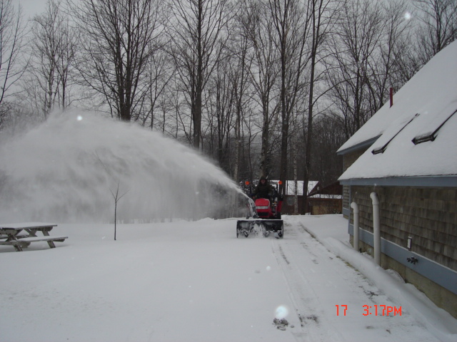

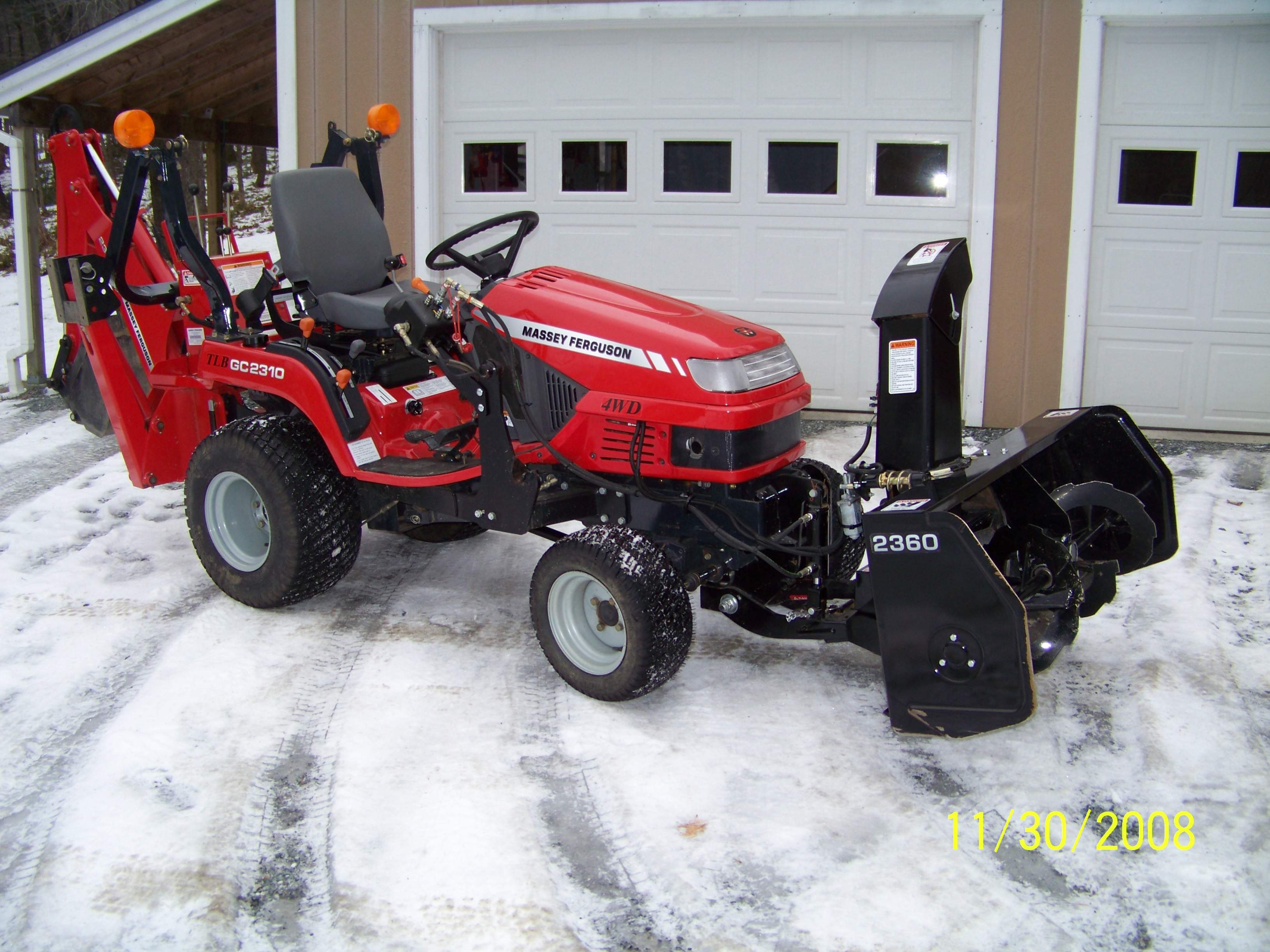

I got the front blower for my GC --yes, it's expensive-- but never looked back. It works very well, I have no snowpiles to try to see around, and, occasionally, if I need the FEL, it's not that hard to remove the blower and put the FEL back on. (The blower's attachment sub-frame & driveshaft extension can stay in place while using the FEL, though they don't take much time to remove, either.)
My drive is about 200' long and uphill, and I also didn't want to face rearward. For really tight places alongside house and garage, I either shovel by hand --really doesn't take that long to kick it back 2-3 feet-- or use my ol' walk-behind blower. I haven't felt the need to use the FEL but once or twice a winter, the blower works so well. I also believe the blower's also a heck of a lot more efficient that the FEL at getting snow out of the way.
There are many who swear by the front blower/rear blade set-up, or the rear blower/front blade or FEL configuration, but I've been very happy with the front blower.
BTW-- $3000 for a M-F 2360 blower is very good; mine was $3900 (installed) when I bought the tractor a year ago.

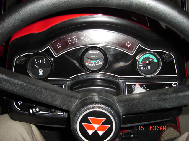

Paystar (nice truck!)-- Mine came with the electric controls (dealer-mounted), and they mounted the switches on the dash.... The 2310's dash is a bit cluttered to begin with and that made it even more so; if you're getting a 2410 or a 2610, they've improved that a lot. If you did it yourself, you could probably put the switches wherever you wanted. (The switches are hard to see, but one's just to the left of the fuel gauge, and the other's to the right of the RPM/hour meter. They're good quality-- rubber-coated weatherproof double-throw momentary toggles.)

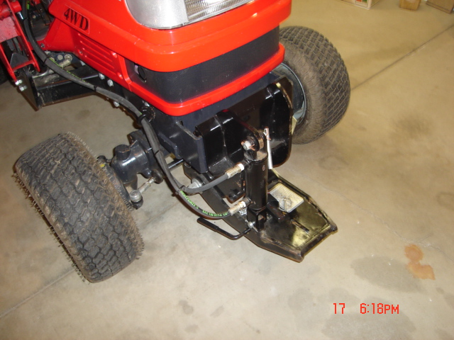

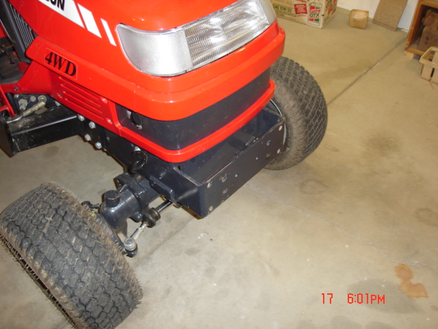

Yes, the grille guard has to be removed to attach the front quick-hitch subframe (4 bolts, nuts & locks); again, on the newer models that's different, as they have a hinged grille guard-- but I suspect it still needs to come off.

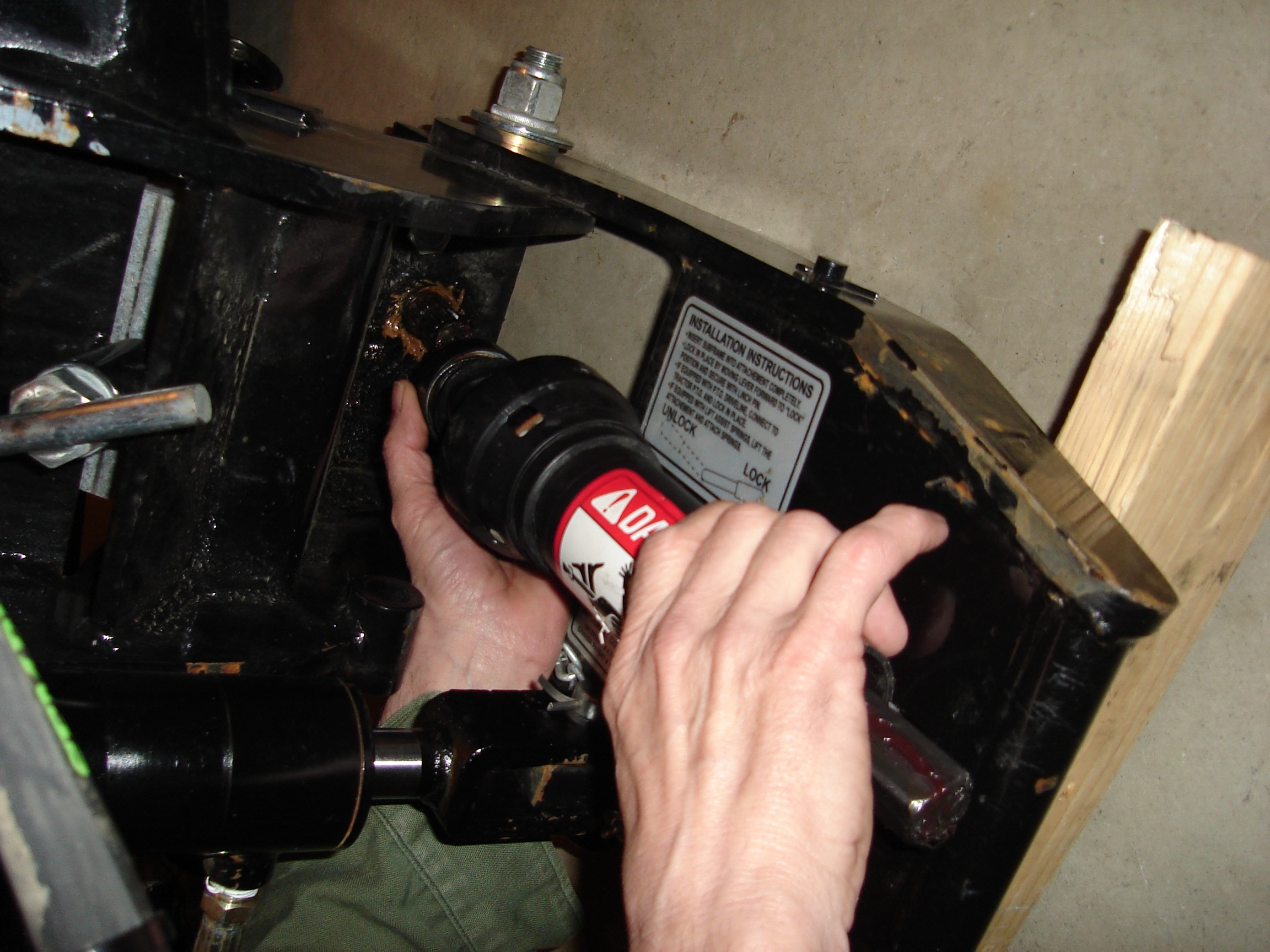

The only other thing I do if I need the FEL is to remove the front stub-shaft coming out of the quick-hitch subframe; it's not "advertised" in the manuals as being possible, but there actually is a quick release for that, way back in. It prevents driving snow into the open end of the coupling. (Sorry for the sideways pic!)
