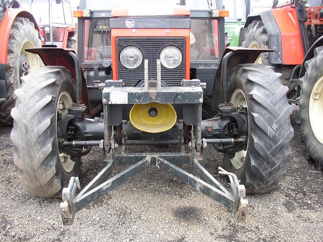

Hey dourobob,
You need this

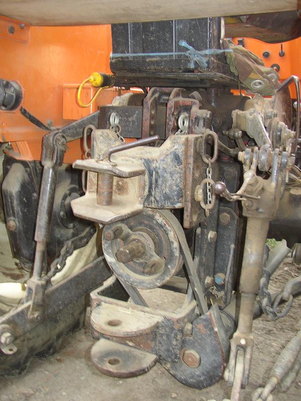

   / Front Mount Snowblower decision (I hope) #9
By the way, you can use V-belts, like on mower we use.
