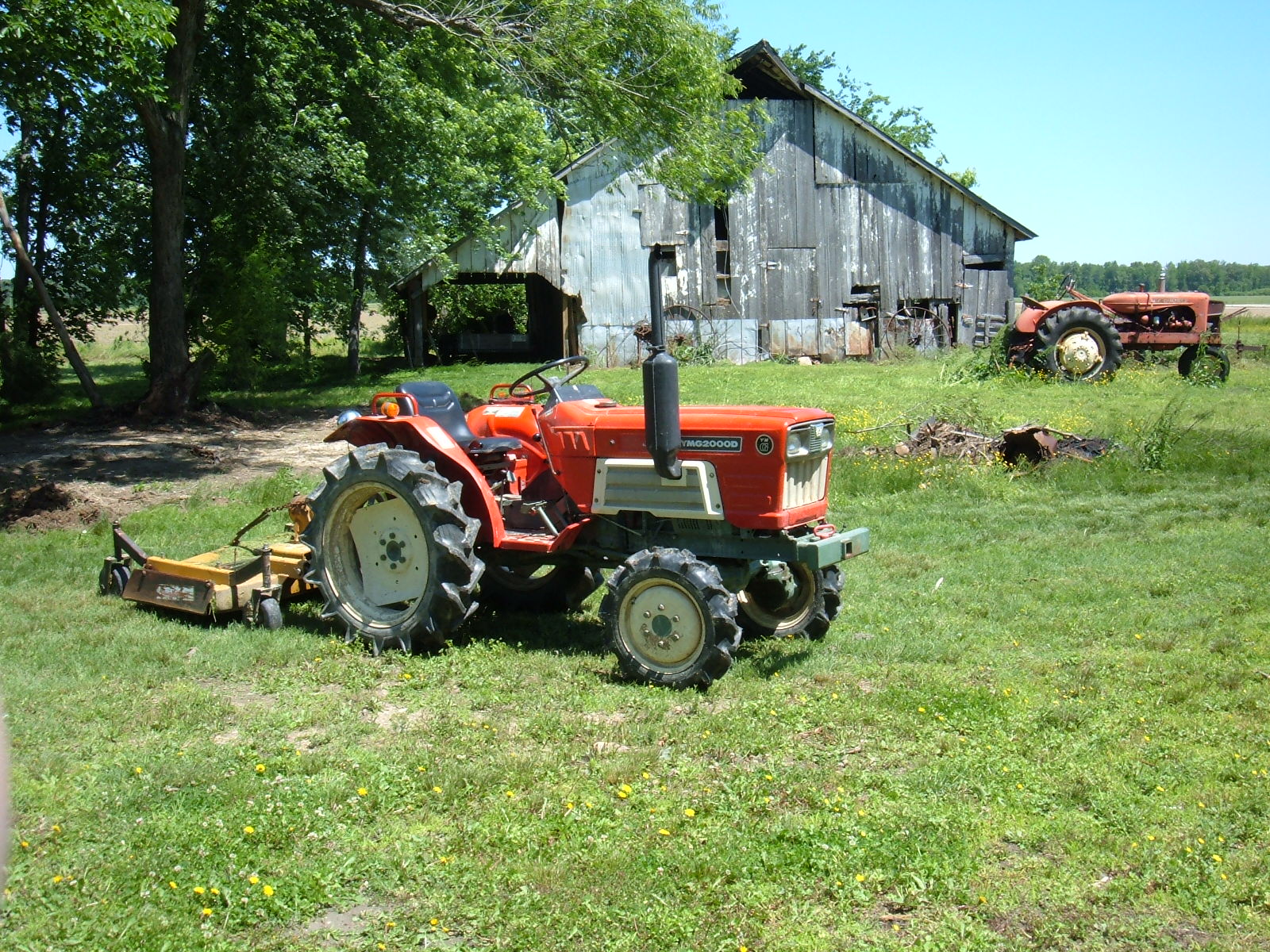

I made a front bumper for my Yanmar that has a 2" reciever welded in it. I made the bumper out a 2x4 pcs of tubing. I welded a plate on a pcs of 2x2 tubing. Then bolted the 15gal tank to the plate. I put a switch on the dash to be able to turn it on and off. I will post some pictures next week showing it. I have just bought a front end loader so it will be taken off. It has worked real well for me for two years. big dan
   / Front mount for sprayer tank #4
Here is a picture that I had on file. This is just the bumper. I will take picture later. big dan

On my sprayer I used the front mount but mounted the boom on the three point. I put a air quick disconnect on the hose and use the boom or the wand for spot spraying. big dan
