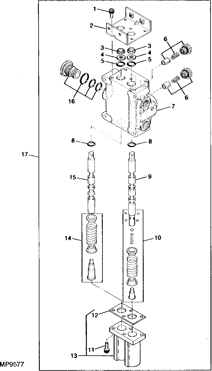

JD 790 with 419 loader. If try to feather the load up, it drops, pull a little farther on the control and it works as it should. Same going down, its like it's going in "float" mode.
Any suggestions?

Dropping while trying to raise could be a load check in your control valve stuck open.
While lowering are you saying you get better control by moving the lever further Vs trying to feather?
like /pine states, check all the mechanical stuff first

Like said before the load checks stuck open and it could be that it doesn't even have any. Show a picture of the valve.
/ Front loader problem #6
X3. Load checks.
What he is describing is exactly what a load check is for.

The load check sounds like a good possibility, is it hard to get to?
I miss posted, it only does it for raising the bucket.
I have had the hoses off, the loader is replaced with a front mount snowblower every winter. All the motions of the joystick are same as before, ie pulling back raises the loader.
Also, I put a shim pack in pump for more pressure, I removed them yesterday with no change for my problem.

Depends on the style of the valve. If this is a stock JD part then the JD parts break down shows them being accessible from the same face as the work ports. I would suggest you look at the parts break down or talk to you local dealer. They should be able to verify where they are located.
/ Front loader problem #9
I believe this is the correct drawing for your valve (came from JDParts: Unsigned Landing Page its free, check it out). Luckily this is an older machine and shows the breakdown for it-the newer ones don't show anything but the valve itself.
SELECTIVE CONTROL VALVE
Cart key PART NO. PART NAME QTY SERIAL NO. REMARKS
1 M801517 Bolt 5
2 AM117917 Bracket 1
3 ...... Seal 2 (A)
4 ...... Washer 2 (A)
5 R51603 O-Ring 2 (A)
6 AM100201 Valve Kit 2 LOAD CHECK (INCLUDES R26448 O-RING)
7 ...... Housing 1
8 R51603 O-Ring 2 (A)
9 ...... Spool 1
10 AM117317 Kit 1 SPRING CENTER FLOAT
11 M114910 Screw 4
12 ...... Gasket 1 (A)
13 AM117327 Cap Kit 1 END CAP
14 AM117325 Kit 1 SPRING CENTER REGEN
15 ...... Spool 1 REGEN.
16 AM117366 Plug 1 (A), (SUB AM117916)
17 LVA802784 Selective Control Valve 1 NLA; ORDER LVA803422
LVA803422 Selective Control Valve 1
.. AM117916 Seal Kit 1 (INCLUDES PARTS MARKED (A))
