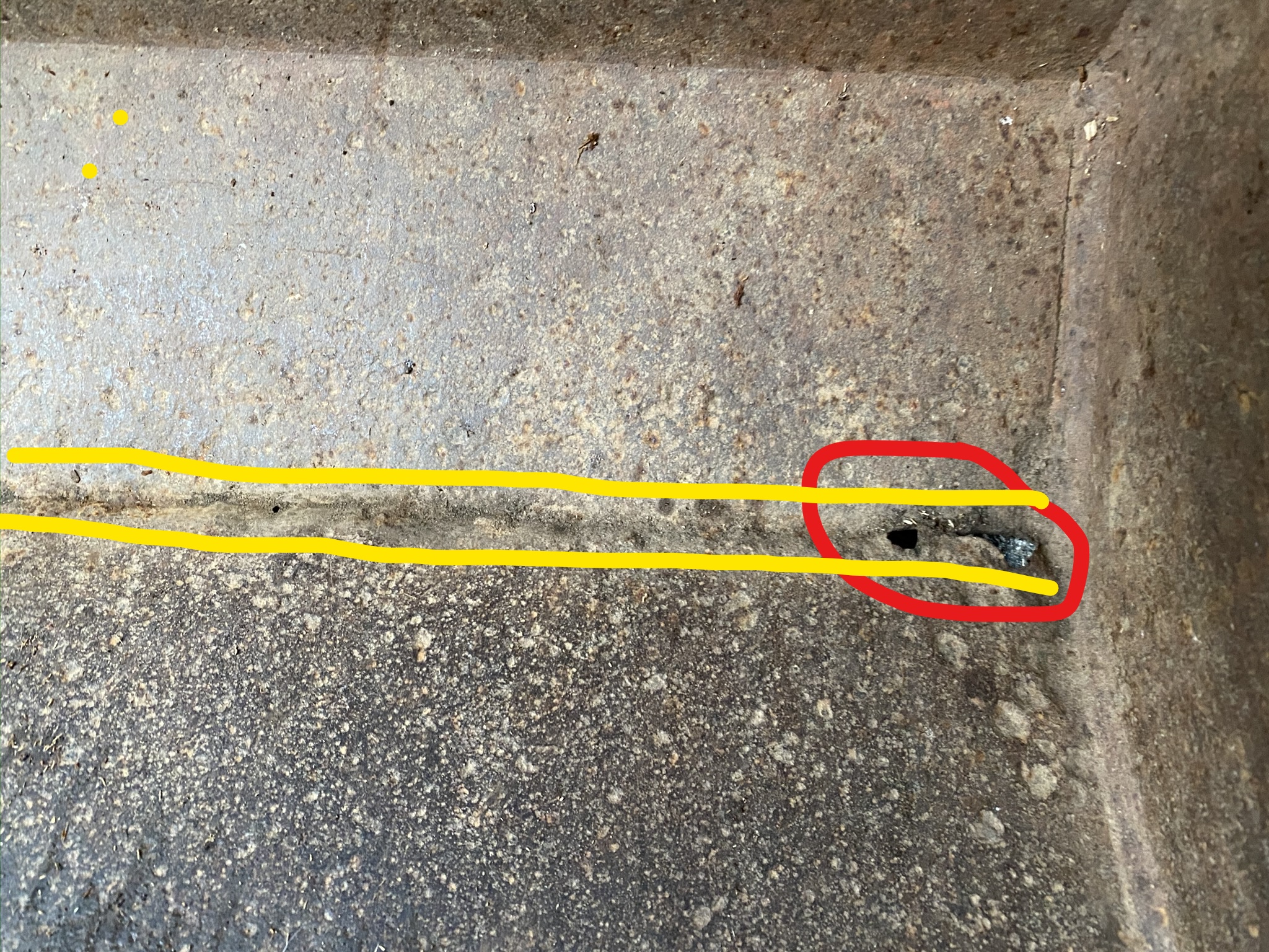

Weld a complete new sheet to the bottom of the bucket and then add some wear strips to that. Also make sure the cutting edge material is thick and not worn out. Adding some cutting-edge to the vertical sides of the bucket will also help.

My front loader bucket is getting pretty thin at the end of the bottom section to the point where I'm starting to see some holes there (see attached picture - red marks). Any suggestions on how to best fix it and extend the life of the bucket (I really don't want to buy a new one anytime soon).
Stitch weld some flat bar to fit the affected areas. I cant tell from photos what size you need, you might get away with 2,3 or 4 inch x 1/8 thick mild steel. One piece along the whole length might do it. Looks like you will be welding to Swiss cheese. Apply thick paint liberally and when you park your bucket dont let water accumulate anymore.
If the existing bucket welds and bends are corroded badly I wouldnt waste too much effort in patching. Keep an eye out for a used replacement bucket.

Got a quote from a local welder - $1100 - $1500. New bucket costs $1000.
Shopping for a stick welder now :)
