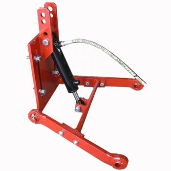

Can only be used with clevis-style pins on the implement. Needs another hose.

Single acting is OK, but a "lift" that only pushes?
Fixed width. Why the ball ends? Someone must have pulled their ideas from pictures on the internet. ;-)

Most front hitches are rigid and have hooks, but if it is used with a quick hitch, US or Euro style, it could be bolted or pinned.
The cylinder looks like a double action without a bottom hose installed.

Has all the looks of the beginning of another Rube Goldberg - to me. The attempt to combine multiple ideas into one final product.

I may be wrong, But I can imagine that most of us know the design features of "most" three point hitches ;-)
The image shows an exception.
How does a single action piston differ from a double acting? A plugged port here, a vent port there. Internal seals perhaps?

If it is a double action missing a hose, no problem. If that is a double action cylinder used as a single, the hose is on the wrong end. If it is a single action cylinder that can only be used as shown, it won't work.

Maybe I'm a bit dense here, but is this really a front mount? Almost seems like something that goes on to a machine that isn't 3pt at the rear. I suppose that this is moot though...
Looks like there are two ports on that cylinder. If another hose were hooked up it might not look so puzzling?

It has rigid arms (spacing) but should have centering chains/links because ball ends are going to be tough to get on implement pins unless there is some slack/movement.... But one could unbolt "centering" bar, install implement and then bolt back up bar....
Looks like once implement is installed it is not meant to be removed....
