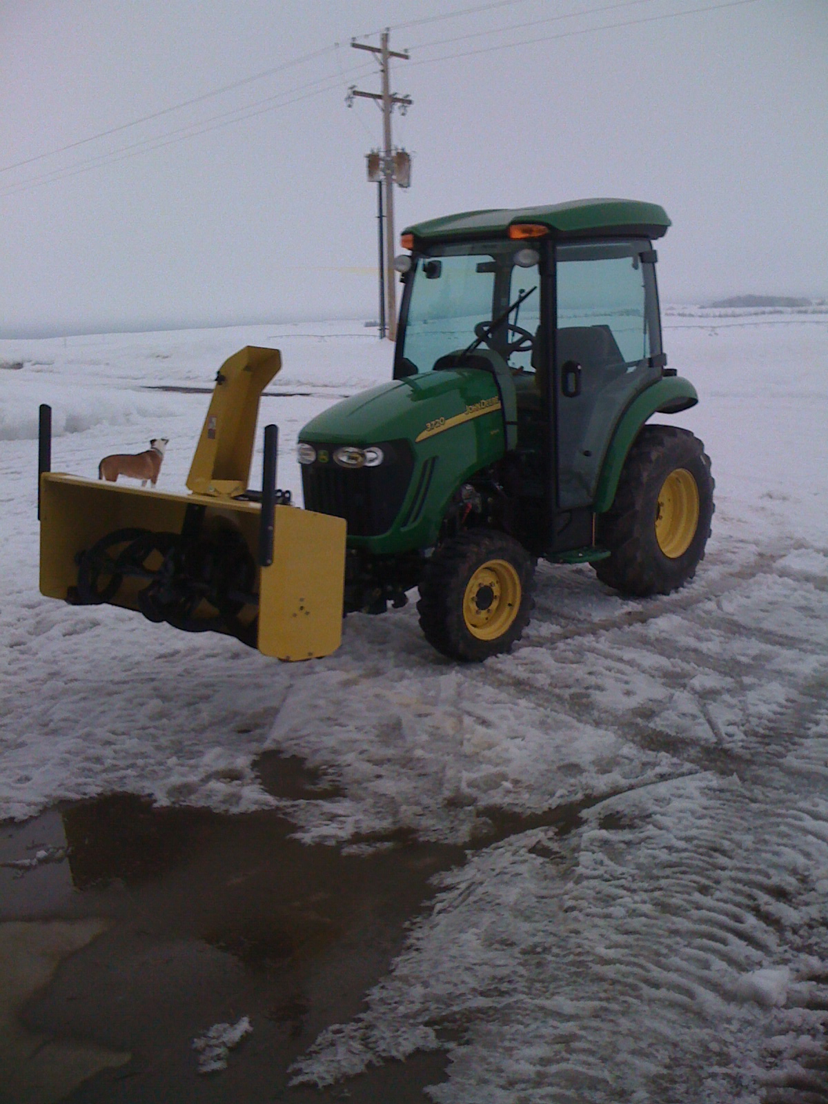

Both will throw rocks and junk equally. The front is just easier on your neck and back;) Here's my old rear blower and the new front blower..... Really no difference in the 2.
