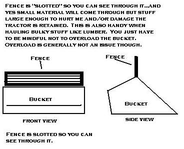

I am a former heavy eq. operator...I worked in an above ground rock mine for years and ran various loaders ranging from a skid steer to a Cat 992G...we always had the back of the bucket "fenced" to prevent spillage when loading shot rock...I may do this to my BX bucket as well. I attached a rough drawing. Thoughts?

Agreed Bob...if some those guys had ever seen a Komatsu WA900 laying on her side they would be believers! /forums/images/graemlins/grin.gif

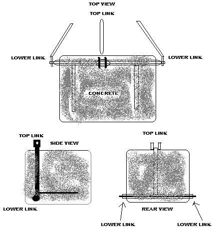

The attachment is the plan I used to build my ballast "cube". The real thing works great. I found the plans here at TBN about 50 pages back in the DIY forum...I had no real use for a box blade and the weight boxes I looked at were not a good deal compared to the $35 I have invested in the cube.
