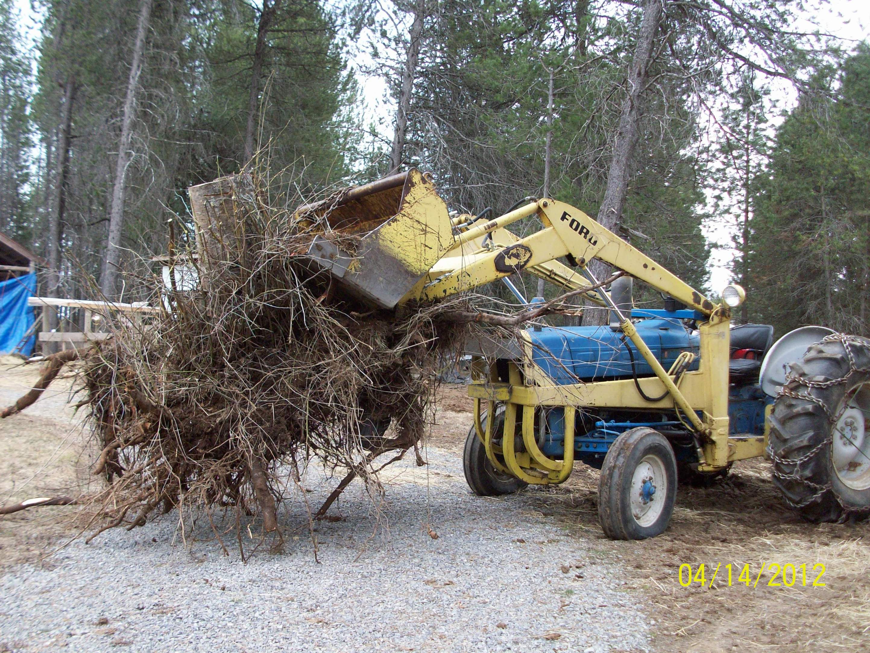

Here's a pic of mine moving a stump i dug out with it March APRIL 2012 008.jpg
The loader frame is basically one piece- which mounts to the rear axle and then to an adapter that attaches to the front axle cradle.
In most cases the adapter mounts a crankshaft driven pump.
I like this feature because as long as the engine is running the FEL has full power and speed,also the pumps used are generally between 11 and about 17+ gallons per minute which makes for a very responsive loader with almost to fast action, this does help when needing to really get er done in a hurry tho :)
for the OP there is nothing wrong with the factory loaders other than being more of a permanent mount- and sounds like the price is even better for a loader you know will fit.

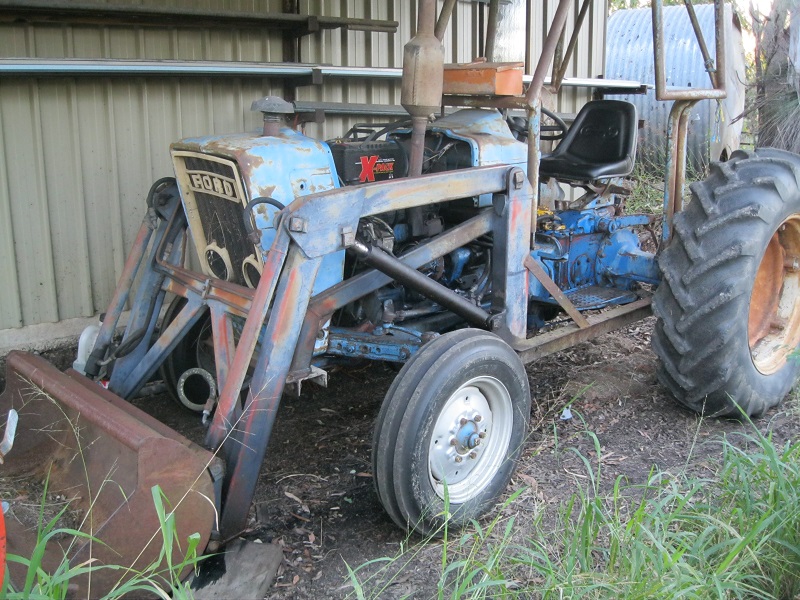

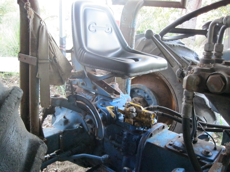

Many years ago I bought this loader. I think it was off a Kubota or similar. Bit small but I managed to fit it OK.
I had to cut a bit off the loader cross bit on the frame to clear the grill.
Tractor is laid up just now untill I get motivated to remove the cover to change the hydraulic filters.
