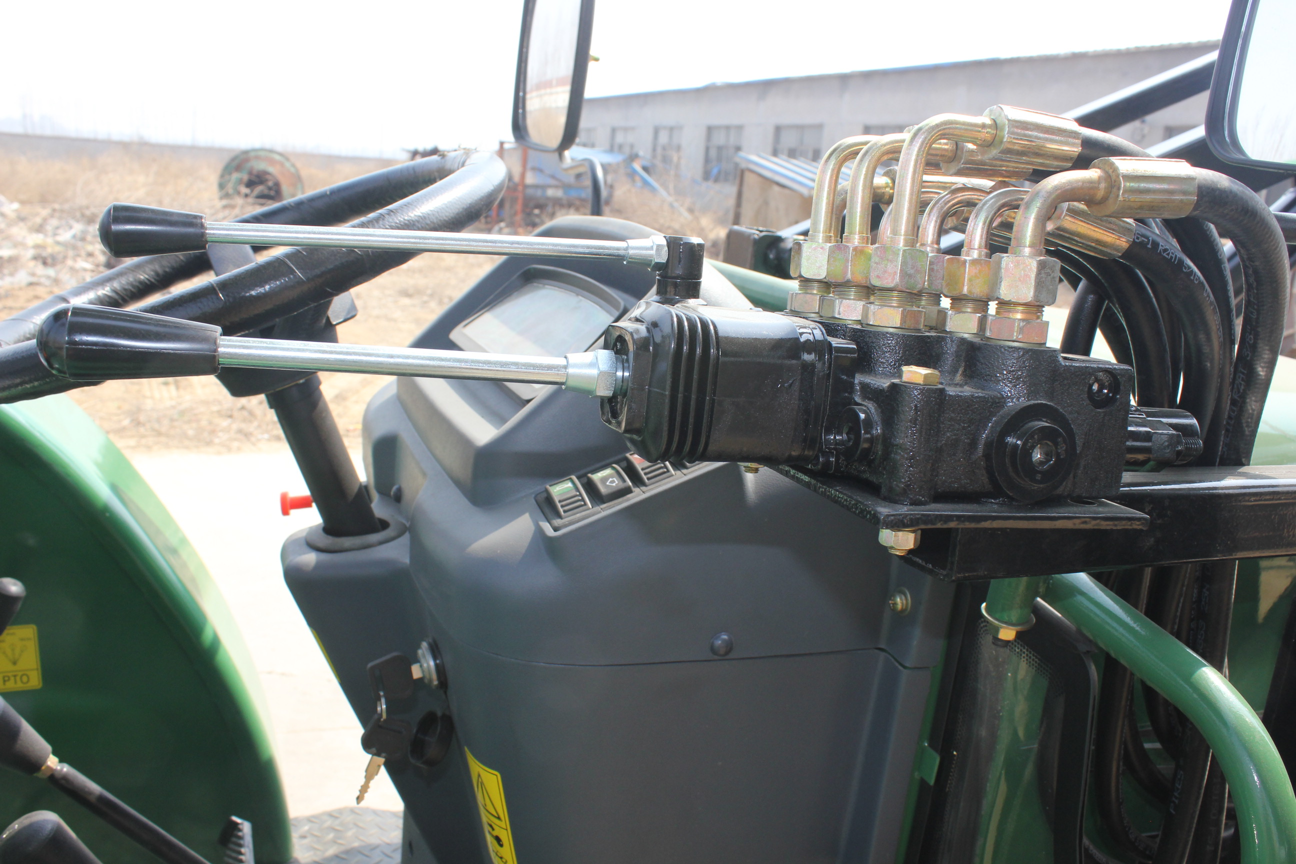

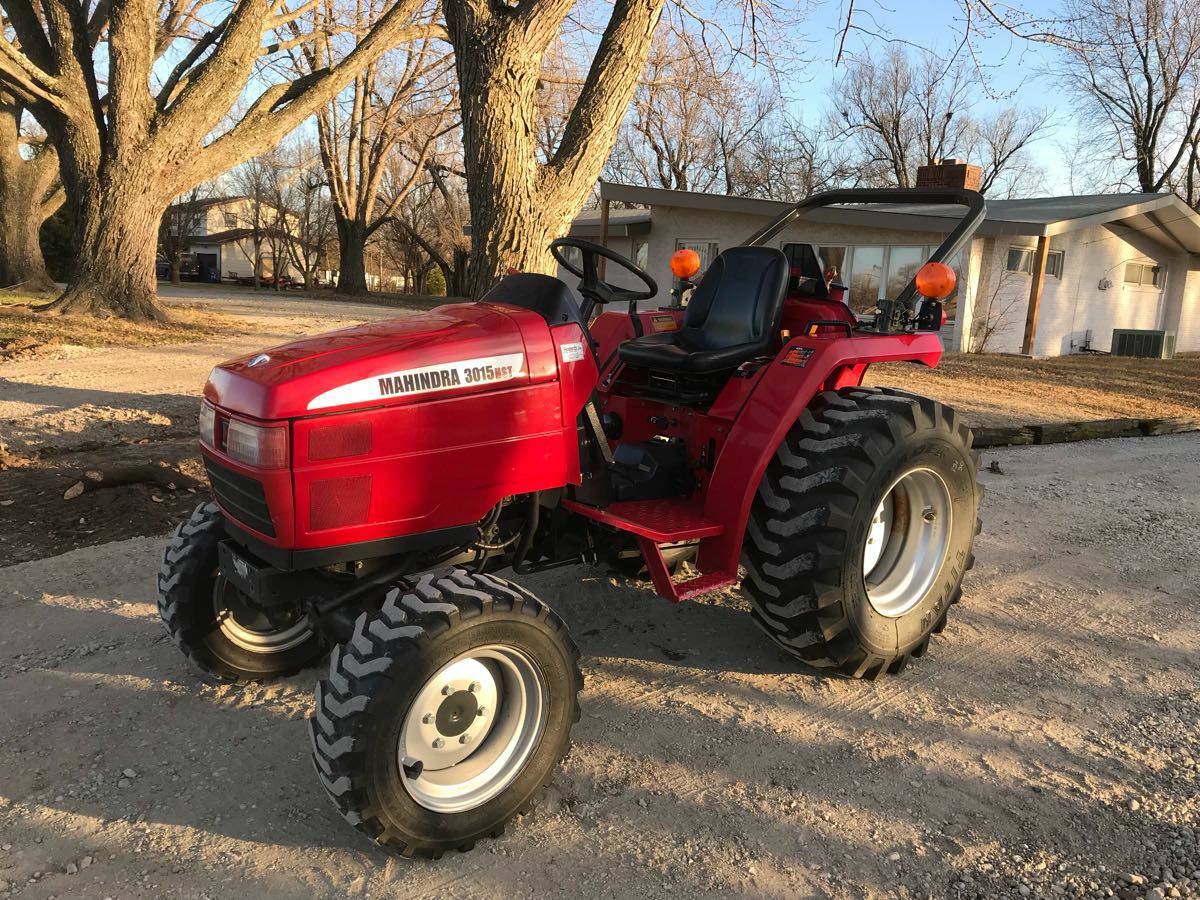

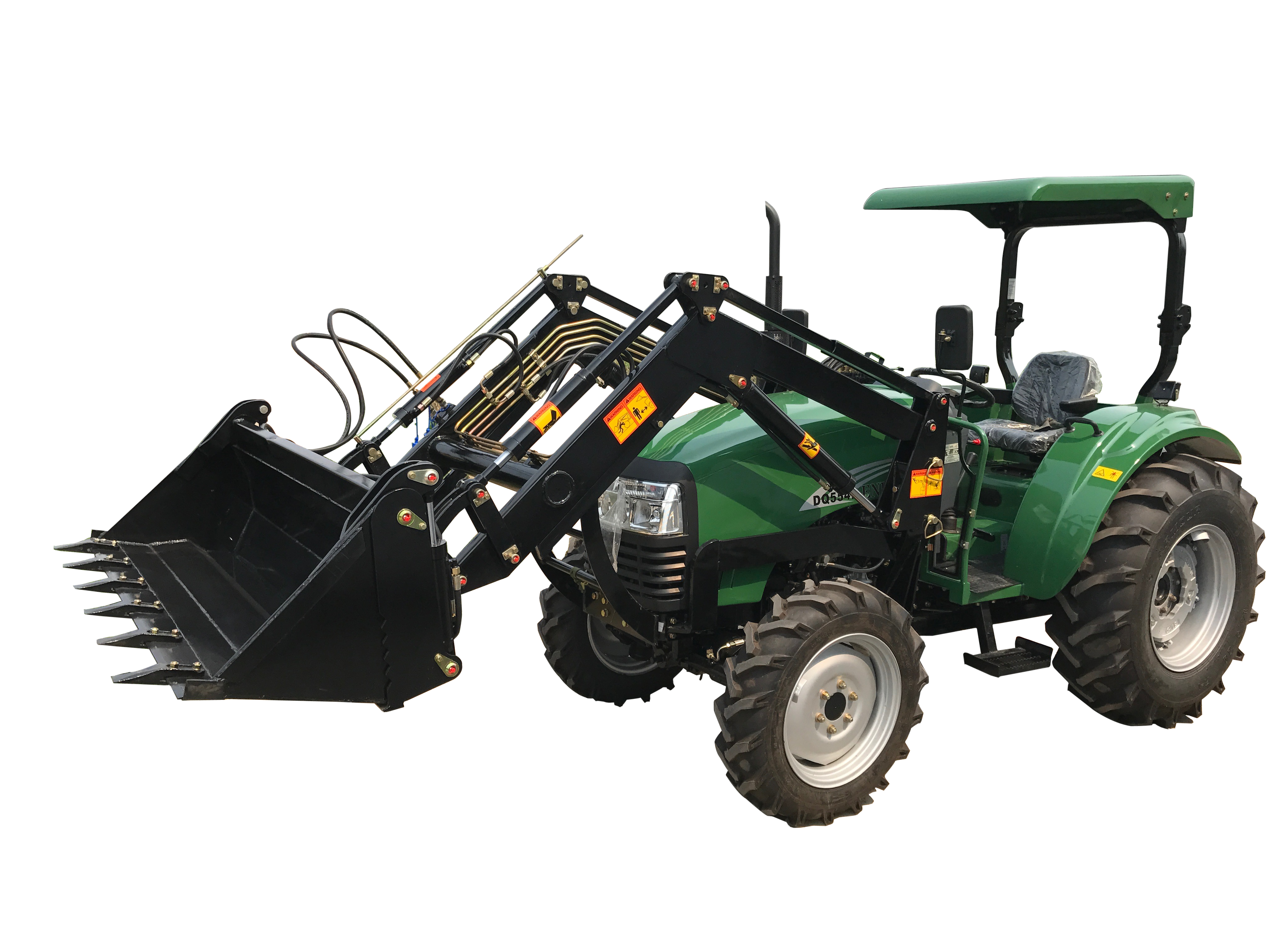

I've priced domestic loaders for my Mahindra 3015 (30HP) and seeing prices from $4000 to $5500 and none have mounting brackets to fit the 3015 which was built from 2004 to about 2008.

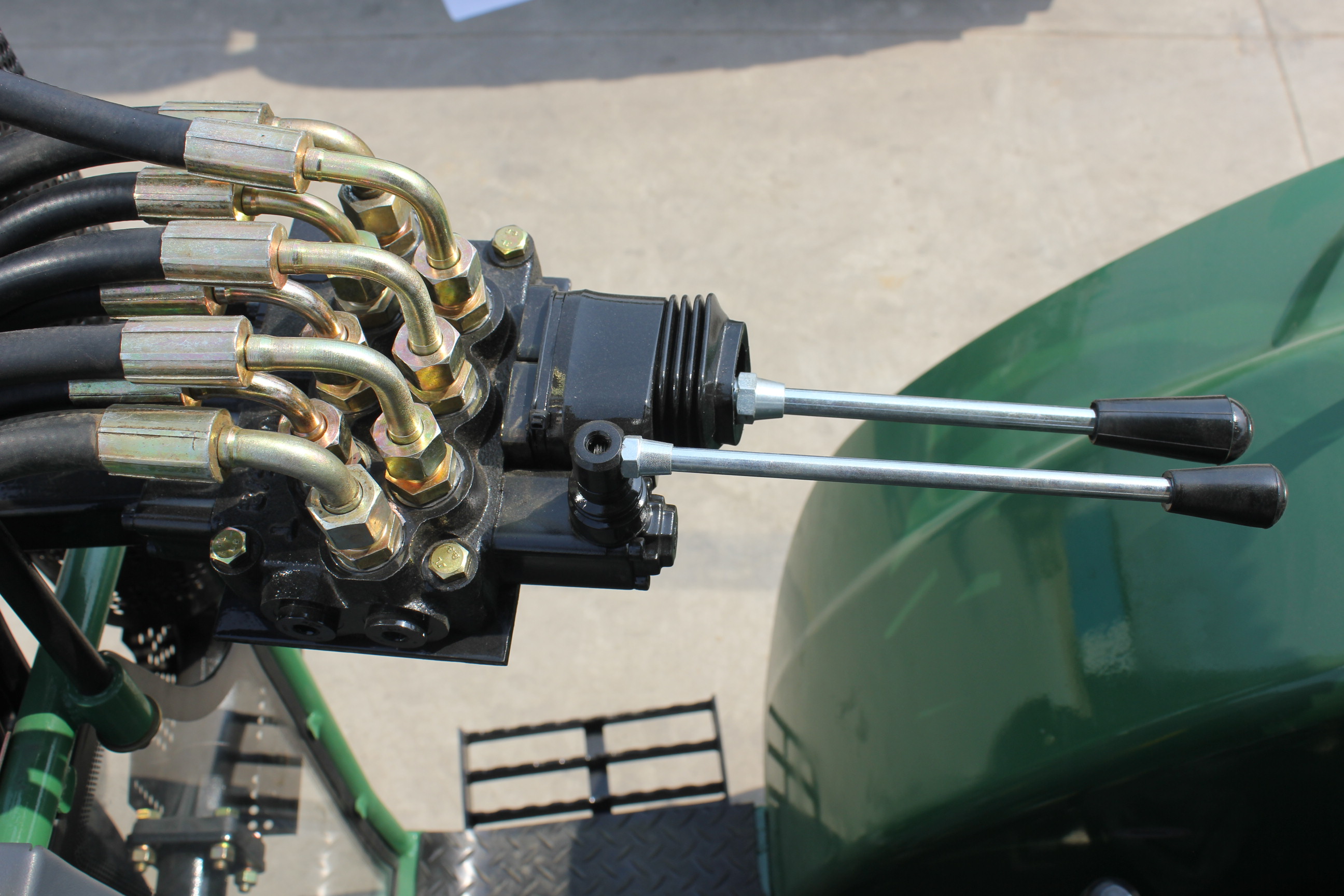

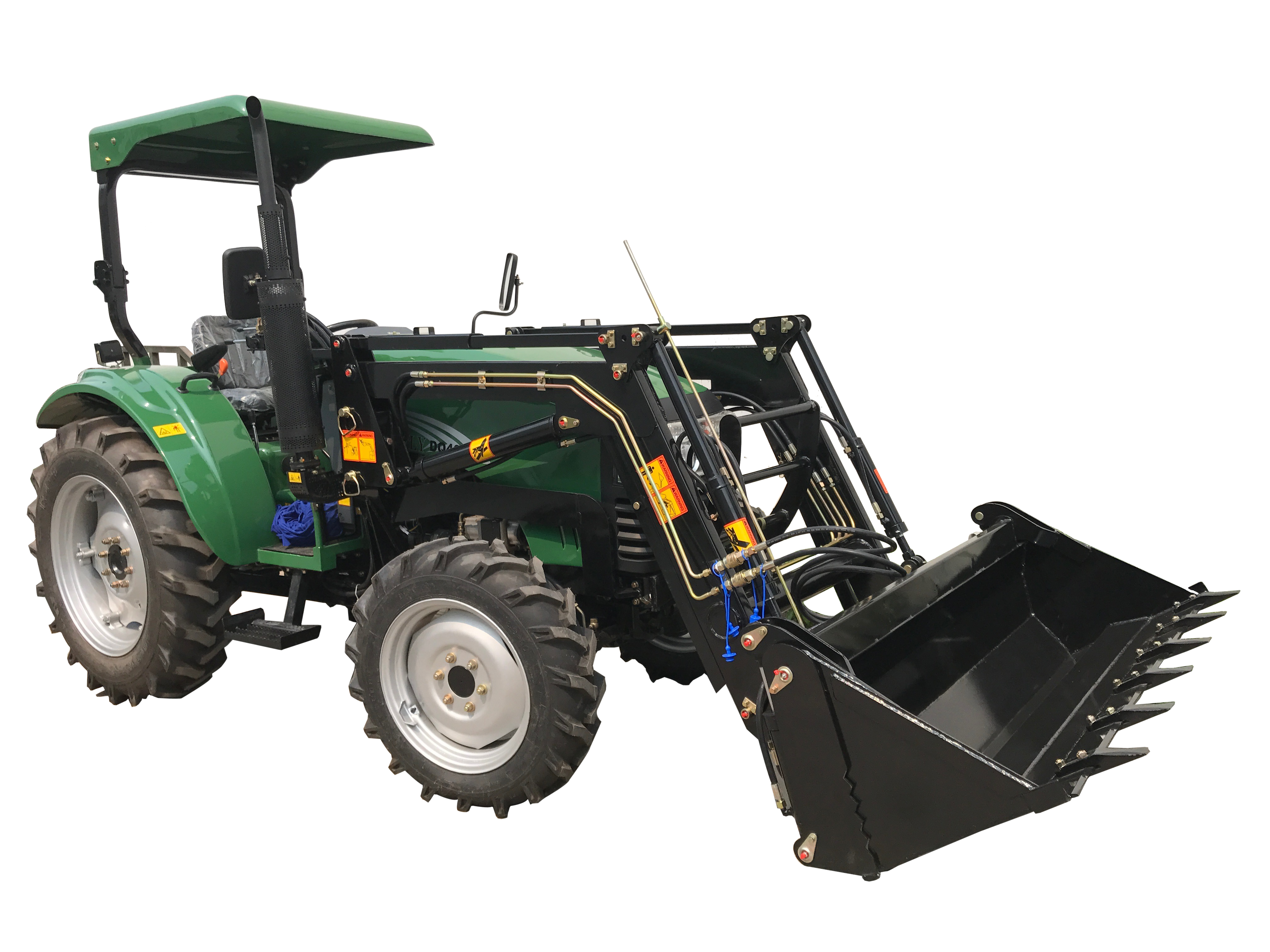

So now looking at options such as foreign made (regretfully) and getting a price on the unit shown in pics attached of $2399 FOB San Francisco. It looks like the next size smaller loader would be a better fit as the one shown is for 40HP to 50HP tractors.
The price includes third function valve and self-leveling as well as four in one bucket as shown. I believe the loader is available with SSQA (skid steer quick attach) but not sure on that.
I'm needing feedback on experiences with importing including duties, freight to the midwest U.S., and hassle involved etc. Not wanting to start a "buy U.S." debate.

Thanks very much for your feeback. Not sure what you mean by "there should be no customs issues". Will I not have to pay a import duty fee based on the selling price of the loader?
I assume that I should go through a customs broker?
Edit: Which US port would you consider the cheapest considering the ocean and inland freight to Kansas? I chose San Francisco just for the seller to get me a ballpark FOB price.
