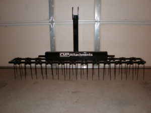

Sorry--can't help with a front dethatcher, but after owning mine for a couple seasons I wouldn't want any other. The obvious downside is you can't vacuum at the same time, but my brother and I team up--I run the dethatcher on my tractor and he follows behind with his tractor and the vacuum. This particular one is 5 feet, but the guy who builds them has 6 to 10 foot models as well.

What brand is that made by???

It's made by a very small company (1 guy working out of a pole barn) called CMP Attachments. I stumbled across his ad on Cragslist and he actually supplies a few of local JD dealers with them (they paint them green and add some margin).
The weight of the unit itself combined with the weight of the 3 point system (you leave the control lever for the 3 point in the down position so the dethatcher "floats" and can move up or down) provides the necessary downforce.
It really does an amazing job and with 5 feet per pass it takes very little time to dethatch.

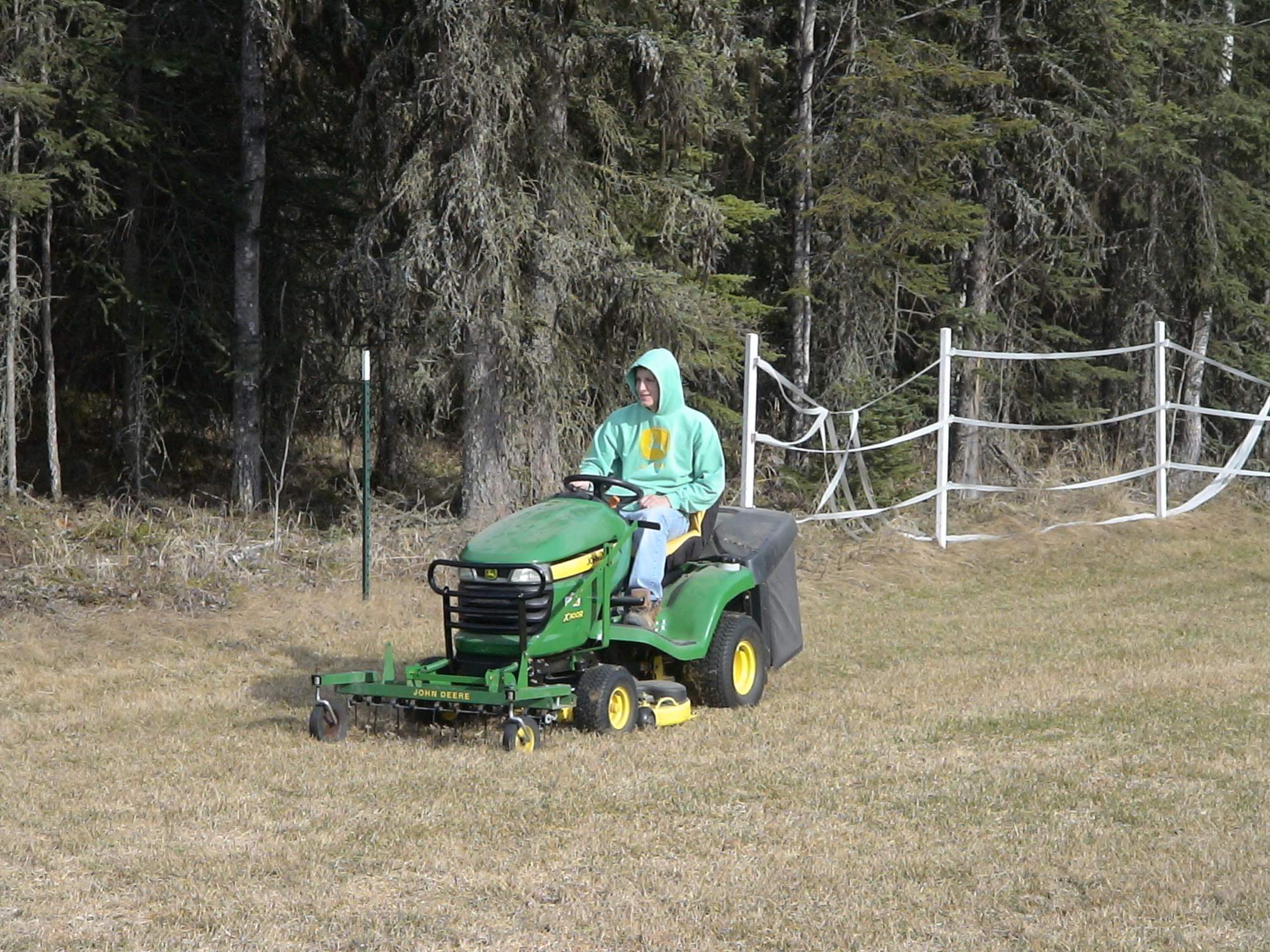

I've been using the JD front-mounted dethatcher on my X300R for 2 years now. Works super in combo with my mower deck and rear bagger!! Makes Spring cleanup a sweet sweep... (say that real fast 4-5 times!) :D
Regardless of the manufacturer - a front mounted dethatcher with a mounted bagger is the hot ticket - IMO.
(There's always a but.... watch out for dried grass buildup on top of your deck - it's not a good situation with fast moving belts and pulley's!!)
