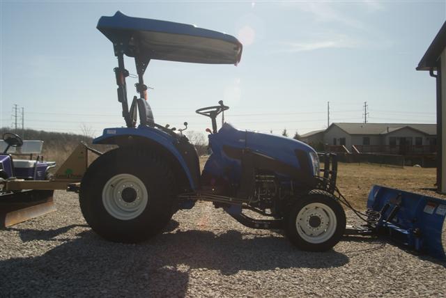

I am looking for a front blade for my TC-25D and was wondering what my options are? Do different companies make such a unit for this tractor? I am hoping to find something used but don't know what is available and from who. I currently have a front loader installed along with a rear blade for snow moving and it's a pita to keep turning around. Sure would be nice to drop the loader and push snow with a blade.

Lots of TBN guys have adapted pickup snowplows to their loaders and push a lot of snow with them, me included. You just need to find one the right weight for your rig. It's nice to have one on the back at the same time - I use a box blade for dragging away from doors, etc.

I bought my front blade (72cb) from my dealer 6 years ago paid $2000 new, Front blade, subframe, cylinders and hoses, uses same valve as the loader
$4-4.5k seems way to high. I bought my tractor in the fall of 04' Greg

The front blade mounts to a subframe that goes under the tractor, my loader mounts stay on the tractor. Midmount mower brackets have to come off for subframe to be attached. Subframe can be seen in these pictures. Subframe mounts to very front of tractor and to the middle.This is the best I can do for now as far as pictures go. Your model may be alittle diffrent mounting than mine.
