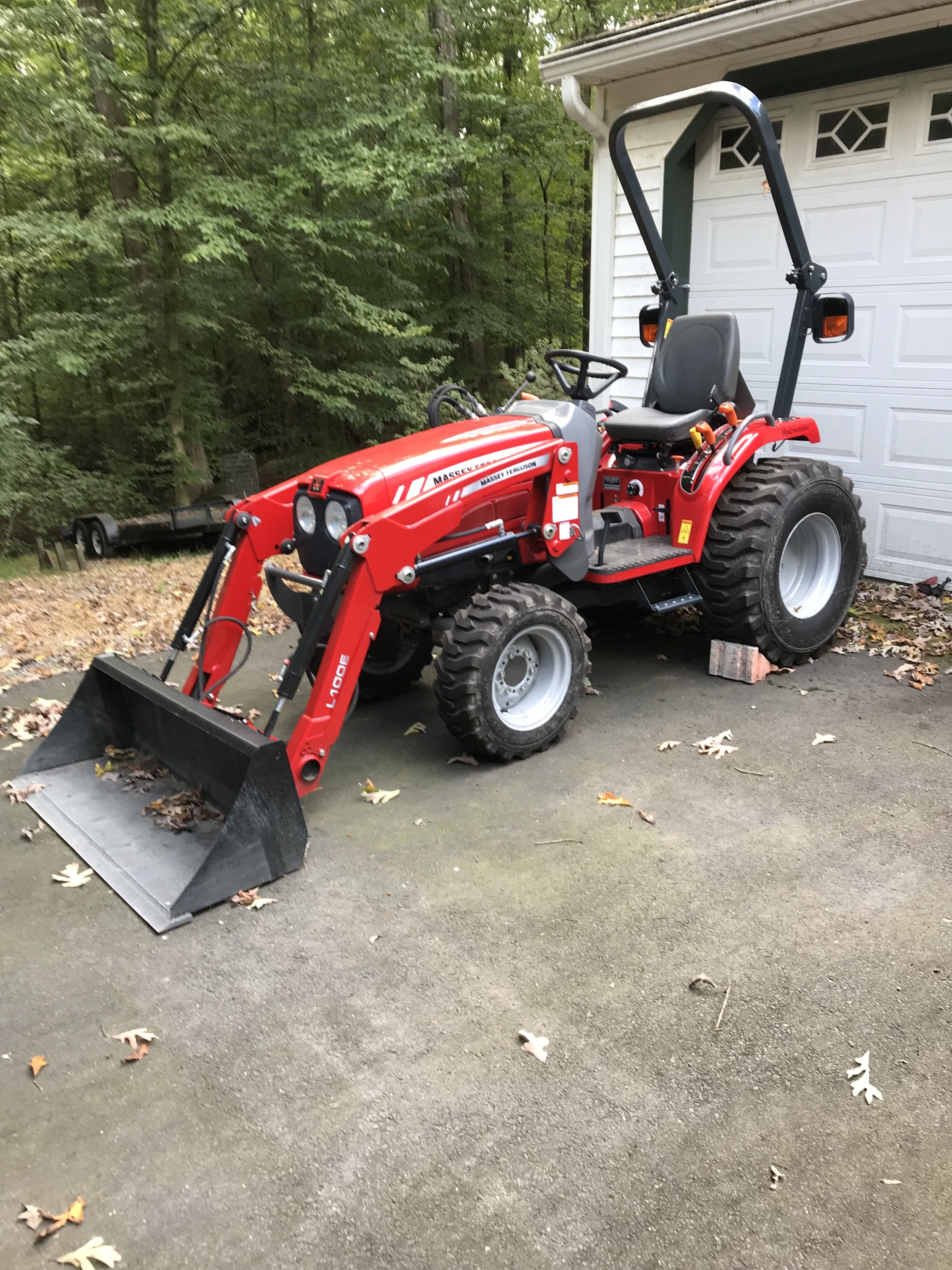

The manual to my 2018 Massey Ferguson tractor (1726E) says to check the front axle oil level regularly. It has always been good. But recently I started seeing yellowish spots in the snow. Upon checking the front axle oil, I found that it was low. I read that the seals sometimes start leaking, and that in such a case, it can be helpful to start adding GL4 80w-90 gear oil rather than the transmission/hydraulic oil normally used. I bought a quart for $21, and started adding it, periodically checking the level. I ended up adding the whole quart, and it still seems to be low. My mechanical knowledge is basic. Does anyone have any tips for me? Thank you.

you're correct in that hyd oil is thinner than GL5 80/90. unfortunately, i feel that although the GL5 will reduce leakage, if you already notice leaking, the seal has been compromised & will need replacement. You may be able to DIY given all the utube info. let us know what you decide, regards
   / Front axle oil #3
It would be best to drain the hydraulic oil out and refill with 80/90 gear oil to have a chance to work. How bad is it leaking?? (how many "yellow dots" in the snow)
   / Front axle oil #4
I would also drain and refill rather than just add gear oil, unless you plan to replace the seals anyway.

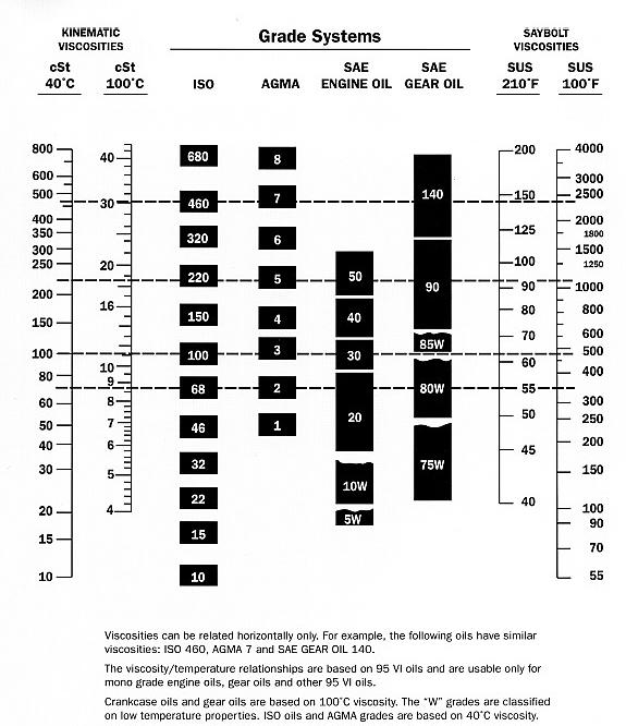

Though it is a popular idea to switch to gear oil for leaks, 80W-90 is not substantially thicker than hydraulic transmission oil, at normal temperatures.
Transmission oil is measured on the motor oil scale. But, gear oil is not. It has it's own scale.
Different products will have different viscosity's, even at the same weight. But, there is not going to be a substantial difference between any of them in these categories.

Normal temperatures?? We are talking about yellow drops in the snow?
Even AI could get this question correct... Which oil is thicker at 32* and below...

Just a few yellow dots here & there. I went ahead & changed it out to 80/90 gear oil, so we'll see how things look next time I plow.

I have a MF 593 that front axle seal was leaking. Removing the fill plug I noticed a hissing sound, like it was under pressure. The vent has a spring in it to maintain a 1.5 psi or so pressure. Mine was stuck. Fixed that and am no longer leaking out the seal.
