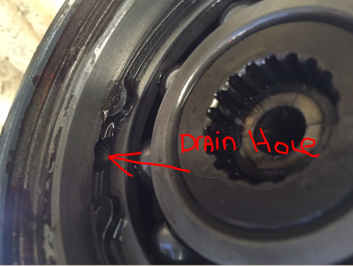

here you go, arrow points to the drain hole, in this case the cir clip is in correct location and oil will drain, but if cir clip rotates the hole will be blocked and oil can not be drained.
I hope this helps.
cheers
Thanks for posting. Now we all know why.
