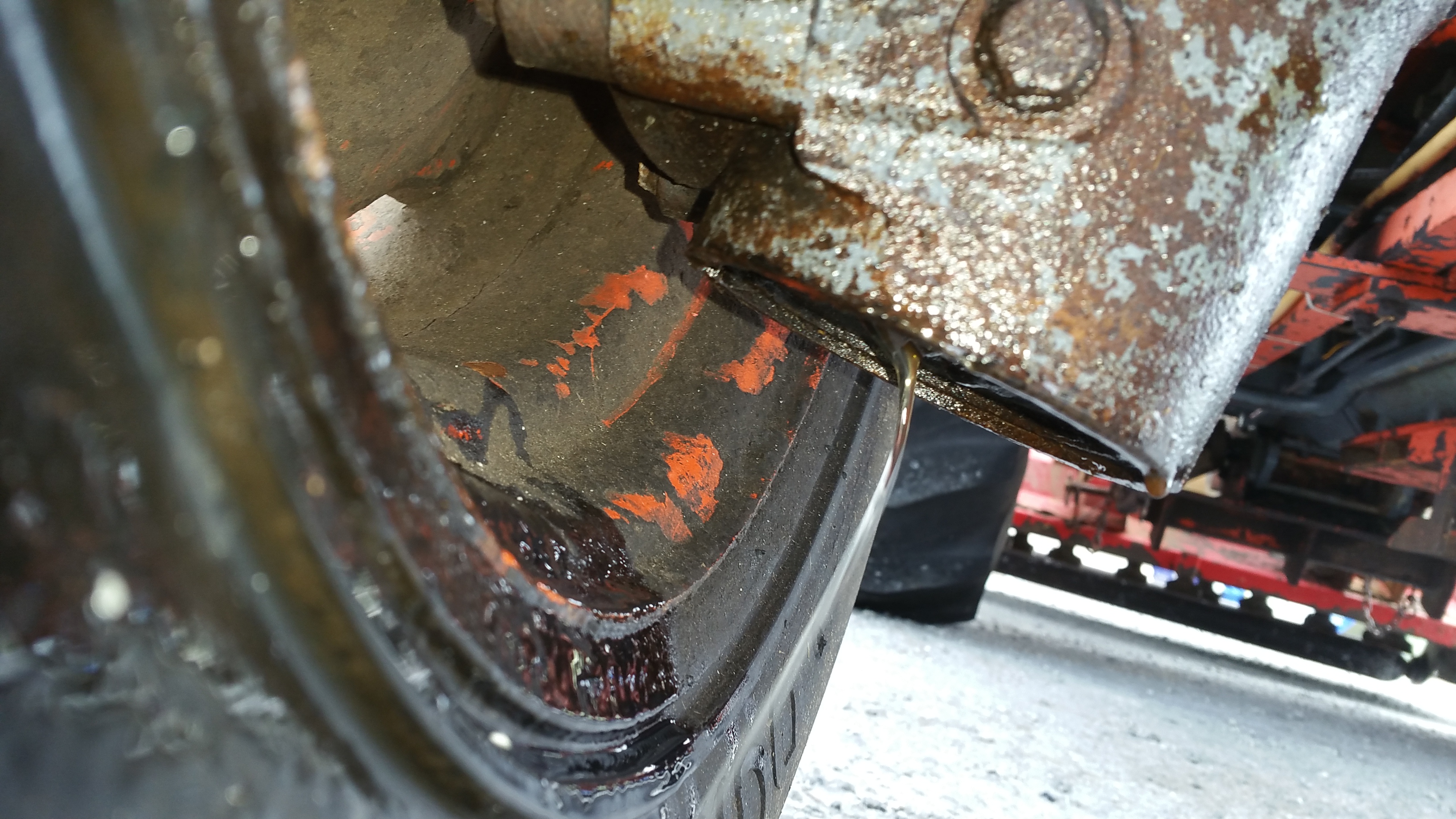

Mar 30, 2017 / Front axle bevel casing plug for DK45 #1 C CajunRider Platinum Member Joined Jan 5, 2005 Messages 688 Location Cajun Land Tractor Kioti DK45 The bottom of my front axle bevel casing is leaking oil severely (see attached picture). I think there is a plug there that has corroded through from the outside. I'm now looking for help in replacing that plug.
Mar 30, 2017 / Front axle bevel casing plug for DK45 Thread Starter #2 OP C CajunRider Platinum Member Joined Jan 5, 2005 Messages 688 Location Cajun Land Tractor Kioti DK45 Well so far this is what I've found. Kioti Parts It appears I'll need the plug and internal clip. Am I right? I went ahead and bought them. I'll find out soon I guess.
Apr 3, 2017 / Front axle bevel casing plug for DK45 #3 MotorSeven Elite Member Joined Aug 17, 2005 Messages 4,301 Location NE TENN (Hancock Co) Tractor Kioti DK40SE Hydro Yes, plug and clip, you will need to dump and replace the axle oil too. Check the other side, it may be rusted too.
