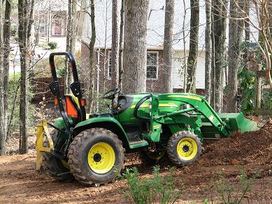

ok guys i have a question. I have had my 3120 for about 6 months. It is in at the dealer right now because axle fluid is leaking out from the area around both front tires. The dealer says it is the seals that are in this area. Is this a common problem on these tractors? I have been using the tractor in heavy mud and snow this past winter, but i do try each time to clean the mud from around the front tires. I have the R4 tires on this tractor. My last tractot was a JD 650 with R1 tires and I never had this problem once. I am just curious whether it was just defective seals of if this tractor does not like the mud? I hope this is not the case because the mud is not going away. Just wondered if this problem is common becasue of a defect or if mud is not good for these beasts? Let me know guys, thanks.

I haven't had problems with my 4300, and have not heard that it is a common problem.

Good luck with the new seals. Careful that pressure washing isn't blowing them out, but I can't imagine that happening.

I have had no problems with my 3120 front axle and gone through 2 Ft of snow and about 1 Ft of mudd but I wash it everytime I use. I do work nights at John deere dealership and have not heard anything on the front axle leaking.I have had my 3120 for 2 months. /forums/images/graemlins/grin.gif

Have your Dealer check with his service rep at Deere, we've had several come in both XX10 & xx20's and they told us to use regular gear oil instead of using the Hy-guard the book shows to use. None have been back yet

no prob like that with my 3120 either
