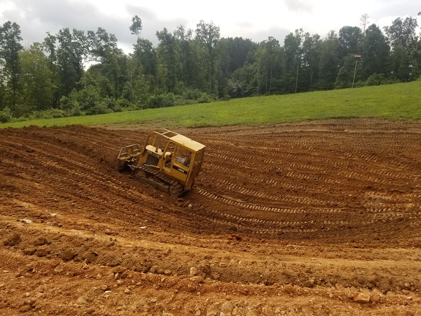

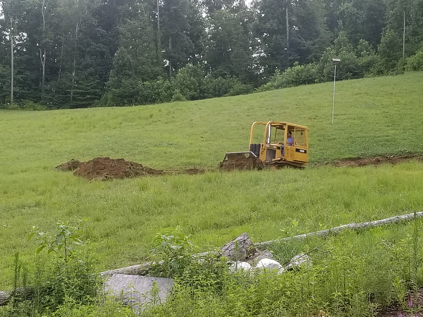

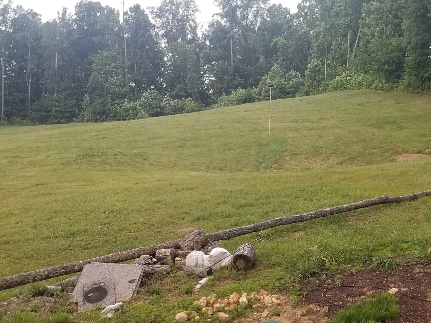

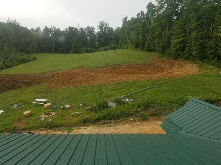

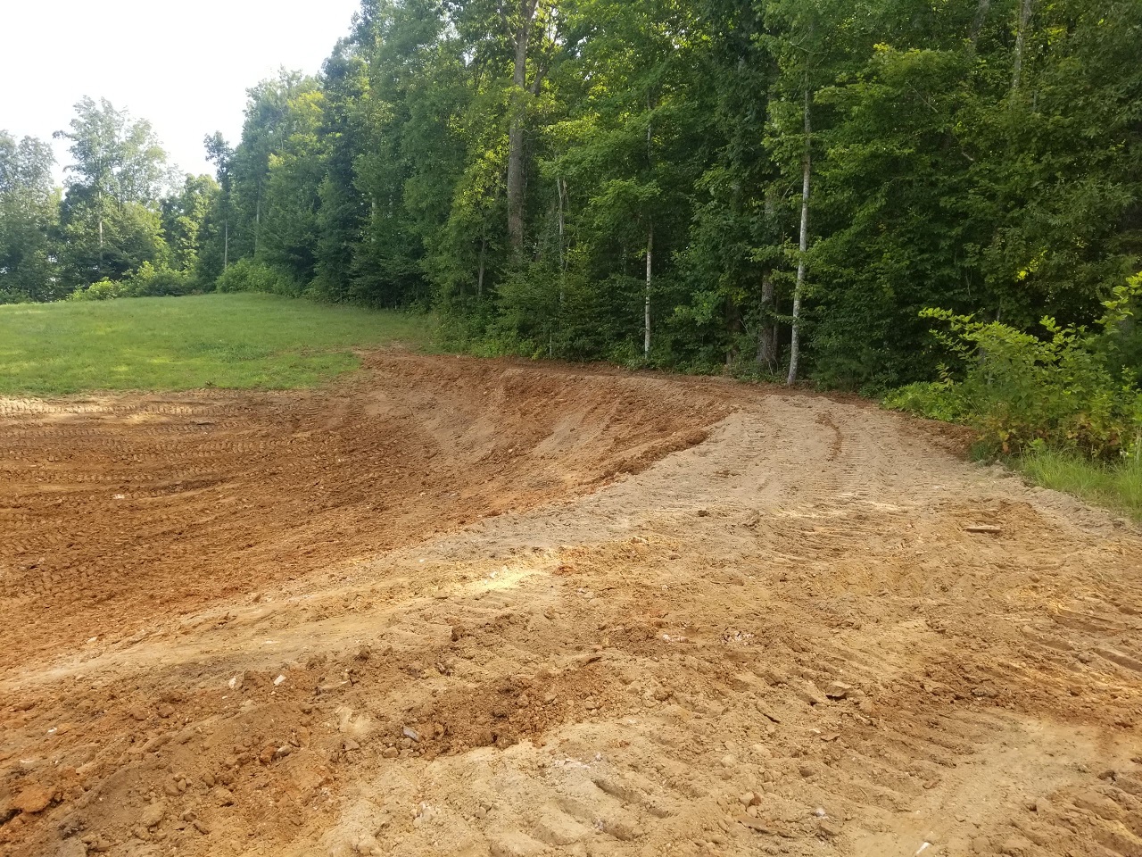

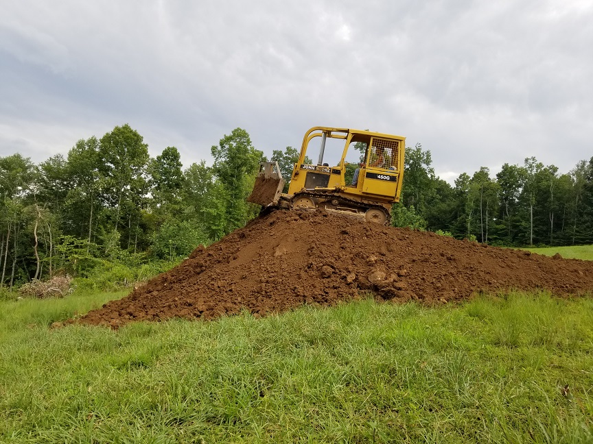

He finished late yesterday. Planned water level is against virgin soil, freeboard added to about 3 feet where needed. Overflows will be added sometime next year, it is expected to take over a year to fill (we missed most of this year's good rain).
Getting the topsoil out was tough. It was like a big funnel, and the topsoil was pretty deep in the center. Finally got to where the soil turned into a sticky clay mess, still darker than surrounding red clay but no longer loam. Scraped red clay from around the top to bury the center under 3 - 5 feet of clay. Should be enough. Pushed up some of the fill to level the road along the woods to the west. Made a shallow slope into water on the side closest to house for easy access by kids of all ages.
Pics came in out of order, so... The dozer on top of loam pile is deceiving. That pile is a good 40 feet wide. The pic where he has pushed up just a little soil is fun. 2 hours later he pushed the soil pile 50 feet back and then it just kept growing. Took the DONE pic from upstairs. We shot the expected water line with a transit. Pond is 12 feet deep in the center, and 95 feet across at the high water level.
