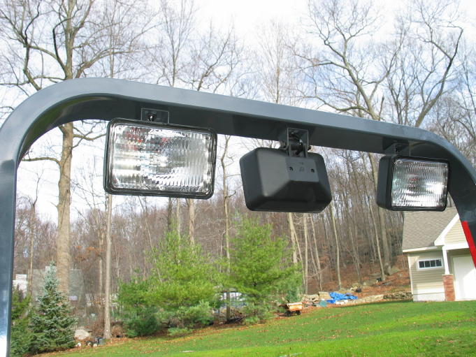

Decided to sell my beloved Deere X585 and move up to a BX24.. Had the BX for 3 weeks now and it is awesome, although the Deere was more comfortable to sit on.. oh well, it is a tool, not a highway cruiser.
The first thing I did was put lights on the ROPS, 2 forward trapazoids and one rear flood, seperate switches. OK, I disregarded the decals for idiots that do silly things and welded the light brackets on the bar, snaked the wiring through the ROPS for neatness and drilled three 1/4 inch holes through the center of the light brackets to pull wires through. I have an engineering backround, and those 3 little holes in those locations wont do squat to the bar strength.

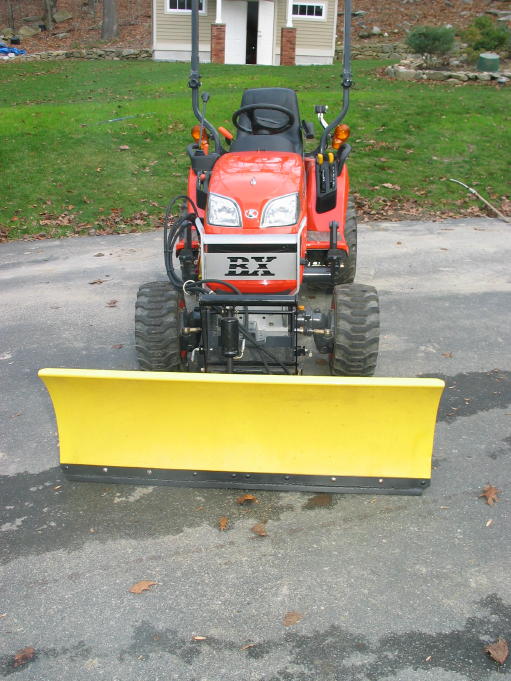

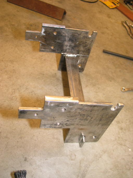

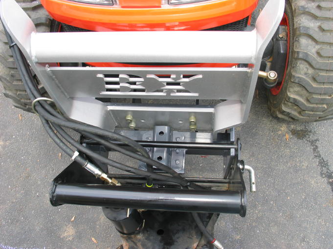

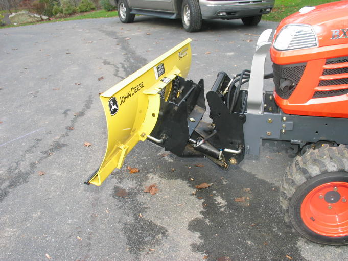

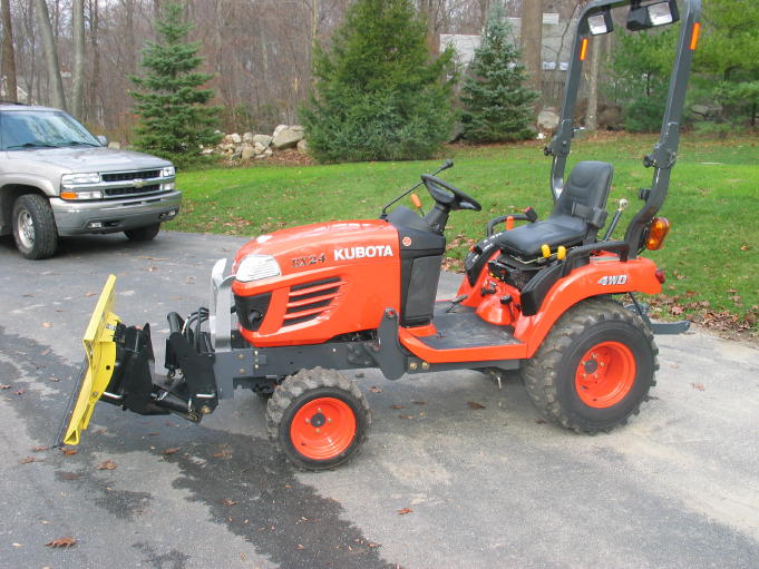

Rather than spend close to $2K for the Kubota power angle plow set up (and have to remove the grill guard!) I adapted my Deere plow set up to the BX24... Some steel, welding, kubota grey paint and hyro hoses.. works like a charm! Also welded on a hitch receiver to the plow frame bracket so I can move a trailer around when an implement is hooked to the rear (like the bagger).
Attached some pics ..
Am now in the process of converting a tow behind dethatcher to 3pt, fabricating a 3pt for an electric ATV spreader, 3pt ball hitch and some lift forks..
What do you think? Should I paint the plow orange? or does the yellow give the package character? Ditto for my JD Green dethatcher!

I see that you put the loader on a rolling platform. I am not familiar with the process of taking the Kubota loader off. Do you have to pick up the front end of the tractor with the loader as you are removing\installing?? I like your idea for easy storage.

Looks great. Only thing that I would do with the plow is to remove the Deere decal and put a Kubota one on instead. That should get everyone talking! Kubota making yellow plows...:D
John
The loader removal/install is so easy I could not bielieve it! The instructions in the book are right on the mark, but I cheat and dont shut the engine off the 3 or 4 times as they recommend.. just once to relieve the pressure by moving the joystick before uncoupling the hydro lines. I made 2 dollys; one long skinny one for the bucket part and one for the stand. Because you need to lift the weight of the tractor front a bit and curl the bucket, removing directly on the dollys would be tricky with either a one or two piece set up. I just drop the loader on the ground, then push down on the boom (pivoting on the stand) to lift the bucket enough to kick a corner of the dolley under it. Once there, you can slide it under by hand by slightly lifting the bucket. I then go to the end of the booms again and lift to kick the other dolly under the stand. I used all swivel casters so I can manuver the thing just about anywhere (on a hard surface)
