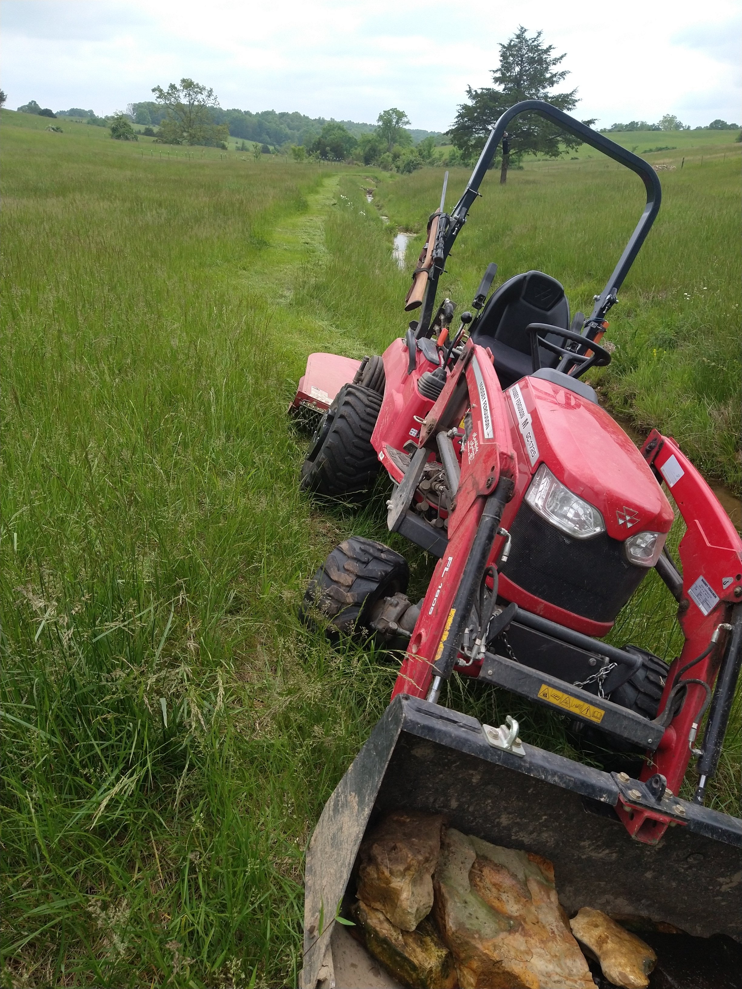

I would use my FEL to scoup up some gravel and keep the bucket low to the ground.

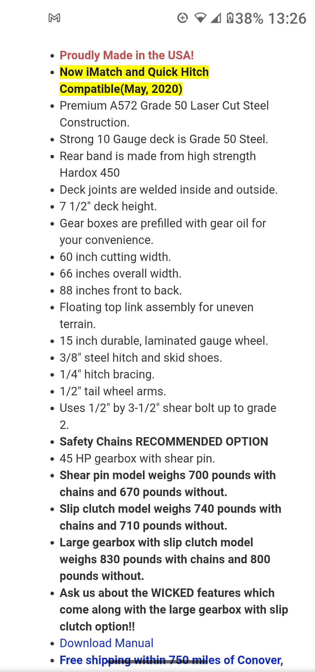

That is heavier and shorter than my 5' Bush Hog BH115 ... Mine's 518. Lb and 96" long, before I hang it off my Quick Hitch on my SCUT ... I prefer to put some rocks in the bucket so I can steer better in certain circumstances ...
From EA's website, only 5' they make now ...
