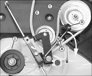

Being new here I would like to see if anyone knows about a Freedom 42 deck.
It's my sisters and what I found is there is a spring that fell out.
This is on a John Deere LT155.
It seems to be to the blade brake but I'm no sure how it goes back in.
The keeper for the pin fell out and the spring likewise, fortunately it was parked at the time.
I am trying to find the correct way to put the spring back in, does anyone have any idea?
It is "B" in the diagram. The spring is under the part shown.
Thank you in advance!
Don
   / Freedom 42 #2
tech manual is lacking on this, pic is from the parts manual, hope it helps
Joe
   / Freedom 42
Well I reinstalled it the way shown. Doesn't appear to do much but the deck is functional.
Thank you.
