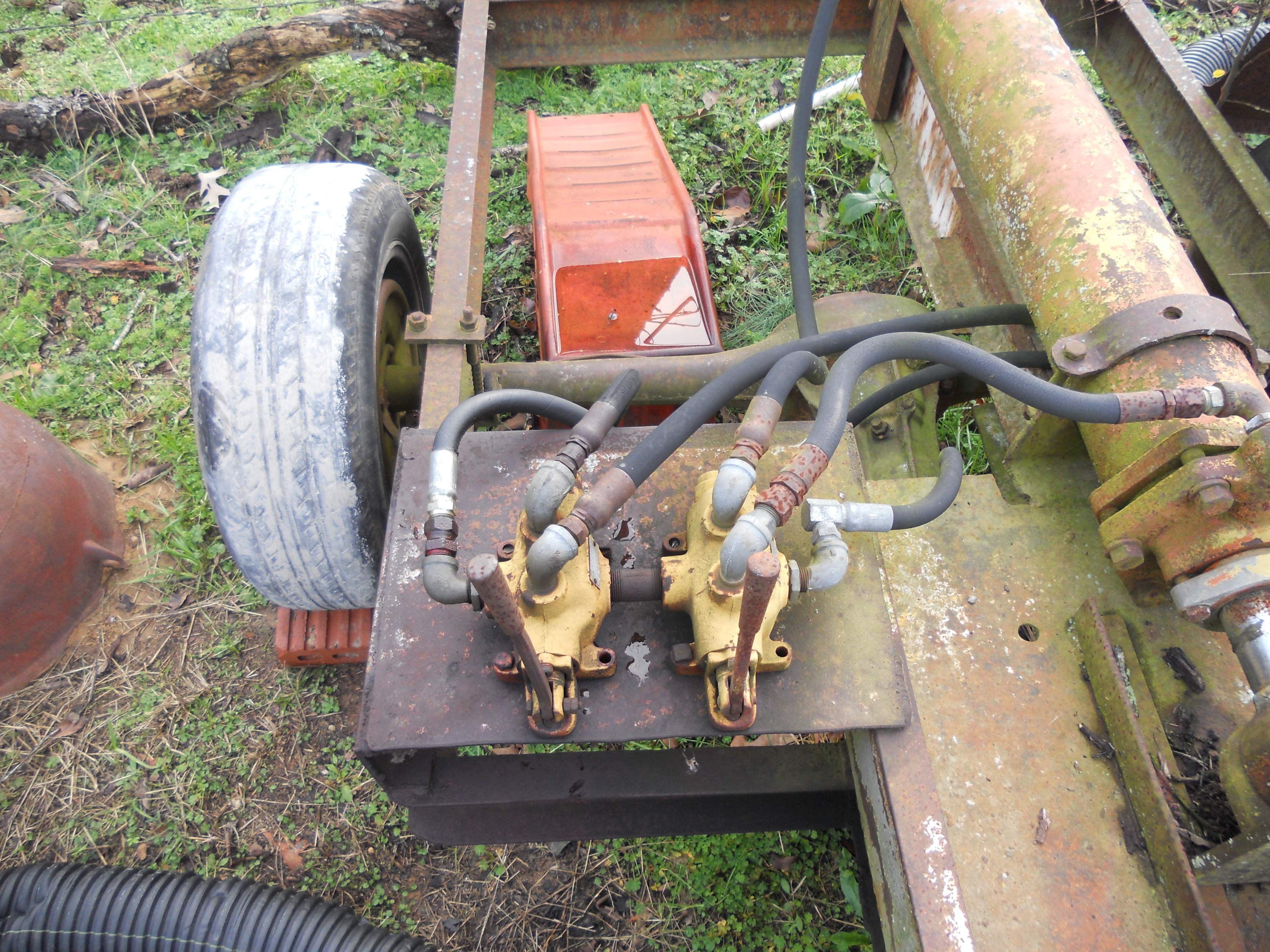

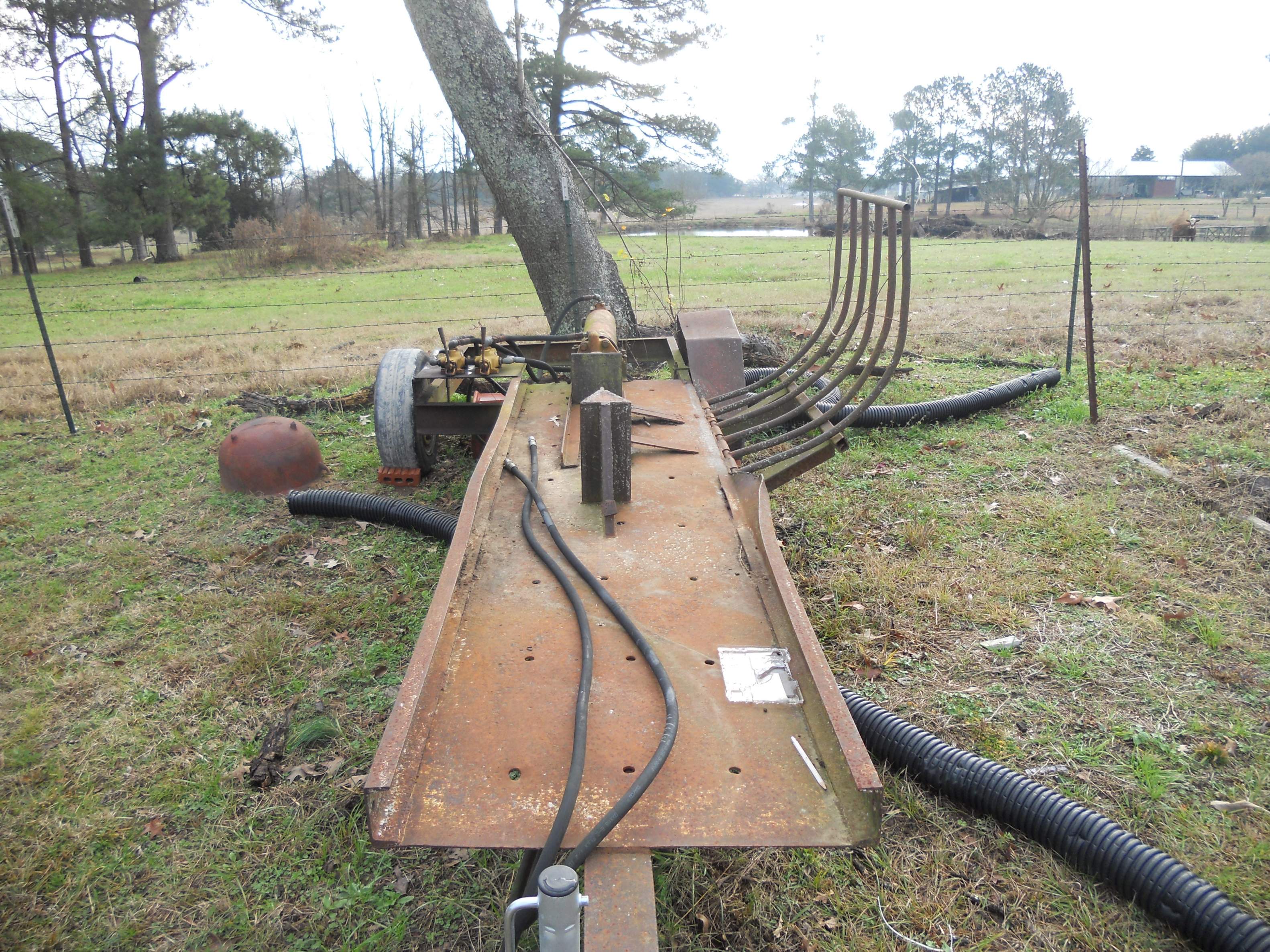

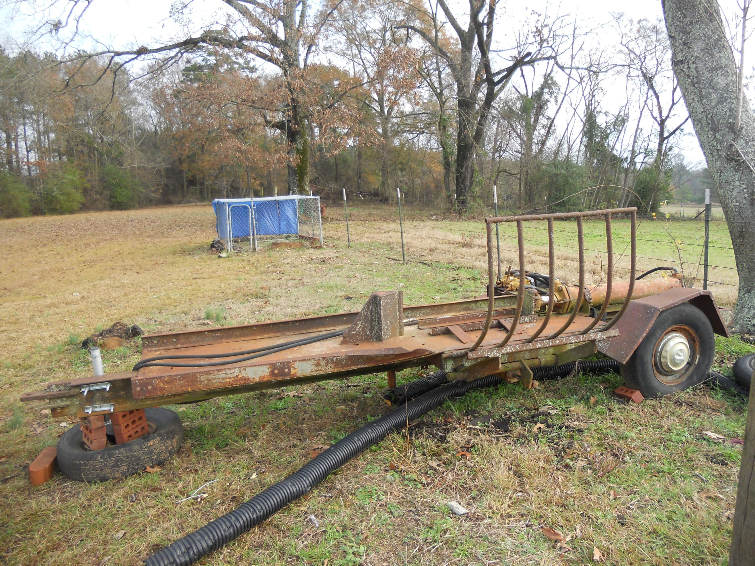

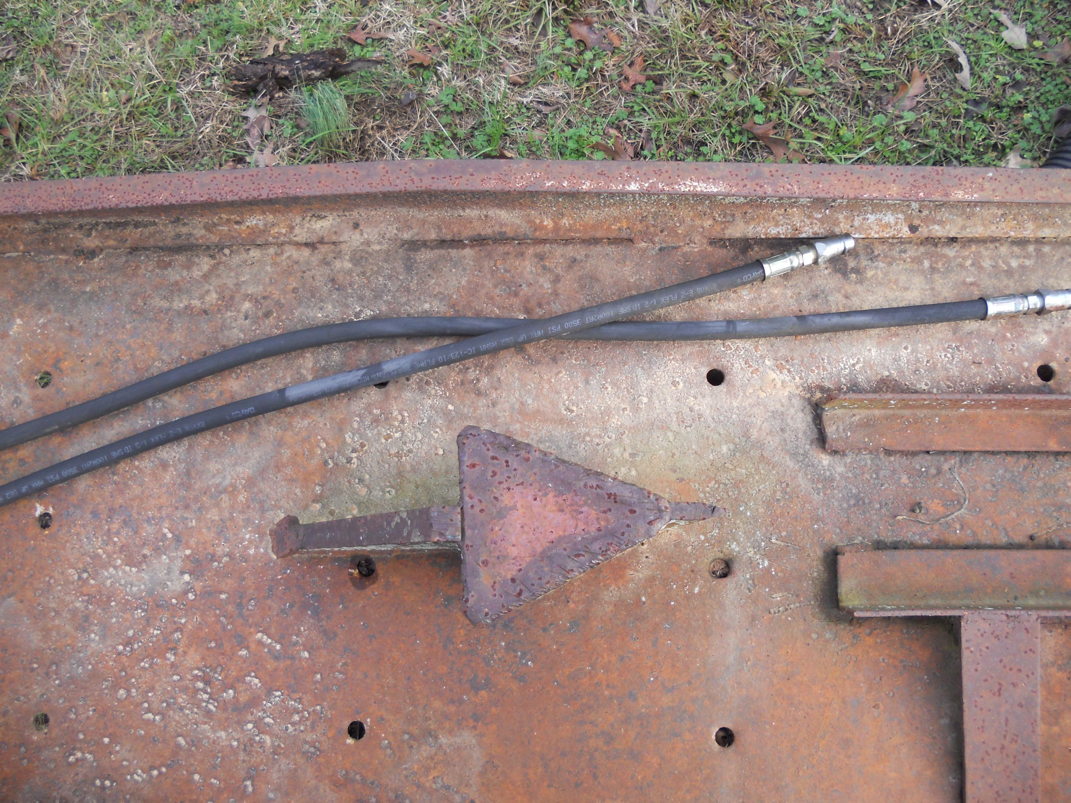

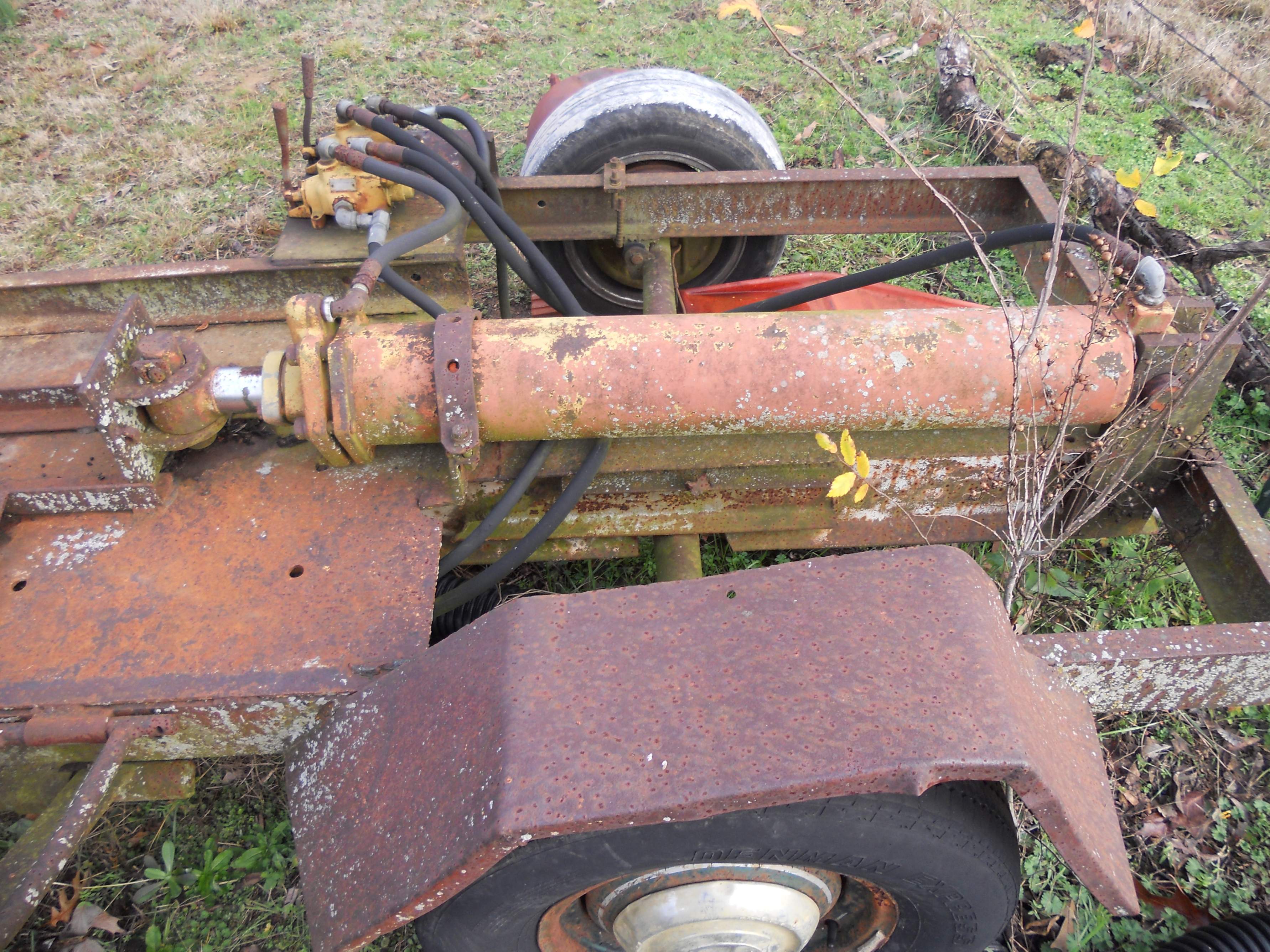

Here are some photos of the homemade log splitter I was given.

Good "buy" ...the price was right. Looks like a fun project !!
   / Free Log Splitter Photos #3
Looks like someone unloaded their headaches on you. I think scrap is about $0.07 per pound now.......
Craig
   / Free Log Splitter Photos #4
I don't know, the long hydraulic hoses alone are worth the price he paid. :) One man's trash is another man's treasure. I say good acquisition!
   / Free Log Splitter Photos #5
If it is currently not in an operable condition, it may require some work on your part in getting it working again. If you have the skills required to get it operating again, then you will have a piece of equipment to help facilitate your firewood chores. Best of Luck in your endeavor and project. Keep us posted on the results.

I like it , but i would replace the water pipe elbows with hyd. rated ones.

Ok hooked it up today and ran it. Someone has to be in tractor engaging the hydraulics for the splitter to work. Tractor has an o-ring that needs replacing as it was leaking profusely when using the splitter. On the splitter, valves were leaking and the main hydraulic cylinder has a small drip. Definitely needs a thorough welding job as a small round of wood had it buckleing under the pressure.

my initial thought would be that since you are asking this question the answer for you might be that it would be easier/better to buy a functional unit at the current time. it's not a personal attack or a comment on the condition of the equipment, but since you ask this it would seem to indicate that you aren't real familiar with resurrecting basket cases made out of tired iron.
a wood splitter is a fairly simple project, but it looks like this one would warrant a redesign from the ground up. the push block appears to be held in place by guides placed on a wide and thin piece of plate that sits on the beam. the block guides should be attached around the beam itself. i'm betting that is the cause of the flex. it looks like you have all the parts,but you just require a little quality time with a torch and welder. it all depends on whether you feel confident in your metalworking skills.
to me having to engage the hydraulics form the tractor is a function of the tractor hydraulics and not the splitter. someone far more versed in the correct terminology will likely chime in as to what this is called and what you need. you do however have a lot of nice pieces, assuming it all works - two cylinders, two valves, hoses, far more metal than you need to build two splitters, etc.

I am surprised that the hydraulics haven't failed due to the water pipe fittings. I also don't think that I would let fluid from the log splitter into my tractor from an unknown source. You may have already contaminated your tractor fluid.

For the education of me and perhaps others, how can you tell the water pipe elbows from ones rated for hydraulic pressure?
   / Free Log Splitter Photos #12
High pressure elbows and fittings are squared off at the ends with something that an open end wrench will grip on to. They are usually made of brass.
Edit- A high pressure straight nipple might not have any wrenching points, but it would be the exception.

The wedge end of the split cylinder is sort-of held down with a strap iron. When the pusher is extended and a knot hits the wedge, there's a lot of strain concentrated there. Agree with poster who proposed a redesign - too much flex built in. The lift looks handy, and the wings on the wedge end. So it depends if you're up to a rebuild or not.

I wouldnt be concerned about the drip from cylinders. It just needs new seals/wipers and o rings. Fairly simple job once its apart. For the cost of small drips vs finding out how well it works, I'd wait to fix it. You really need to put thee splitter through its paces and find out other issues first.
I replaced the seals on my homemade splitter I picked up. I took the internals parts to a hydraulic store and he matched up the seals I needed.
