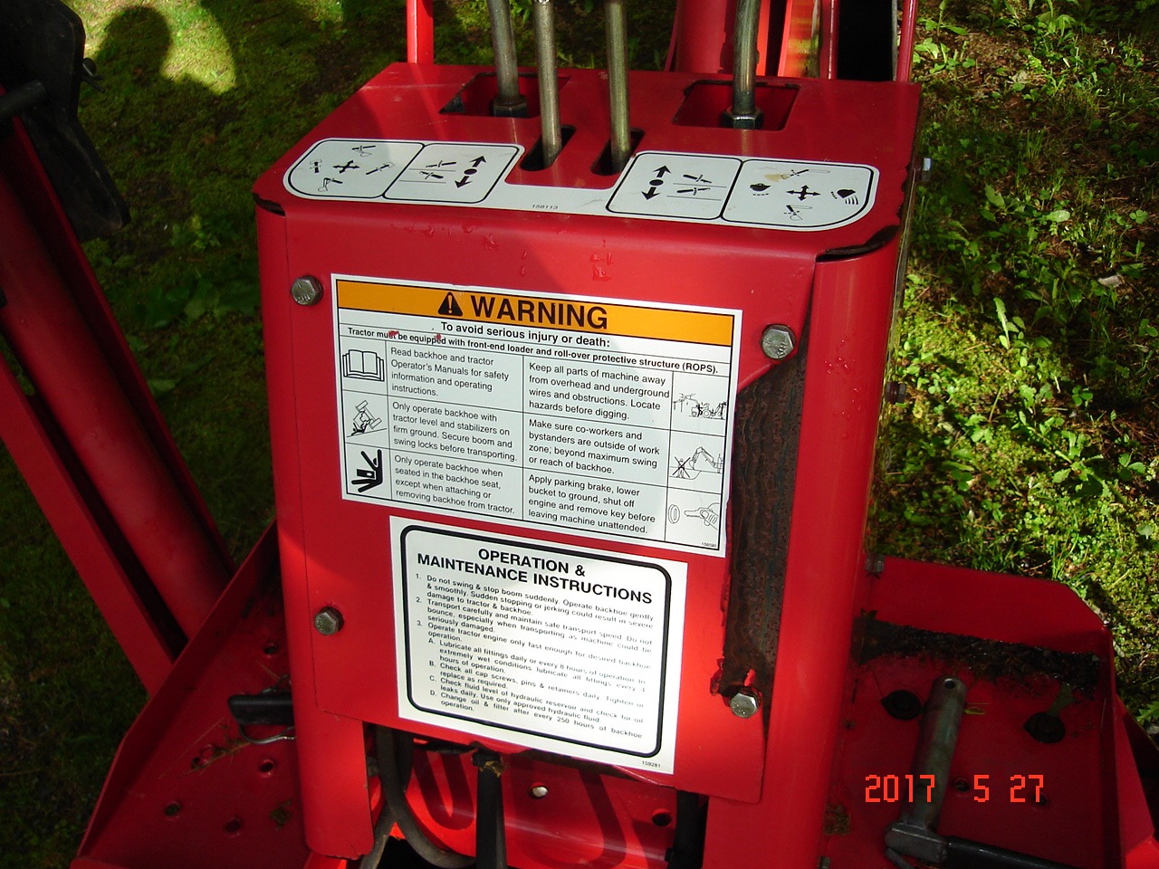

Thanks!! I had read this some time ago, but hadn't used it until today. Worked just like you said: I was able to "get in" as a guest using my 2310's SN. Took me a while to remember you mentioned the sub-chapter(s) Ground Care Equipment and Backhoe/Trencher Attachments, but I eventually got there.
My BH has developed some pretty substantial (though surface) rust on the front panel, due to my mistake of driving it on a paved & salted road in the winter..:guilty: As a result, I'd like to sand it all down & re-paint it.... but it has those stickers on it. Doubt I'll be able to save them for re-use.
Good ol' parts book-- there they were! Have an inquiry to a dealer now as to price & availability; hopefully they're available and won't cost two arms and a leg.

I contacted my "local" dealer, New Boston Truck & Equipment -- New Boston, NH. Talked with Bianca there, and was able to get all the decal/stickers. Not cheap, at between $15 and $25 each, but....
Now I'll be able to re-paint my BH panel and not have to worry about trying to save the original decals. Did also verify part numbers, some of which were incorrect in my research on the above site --most likely my fault-- but the dealer double-checked & got it right AFAIK.
