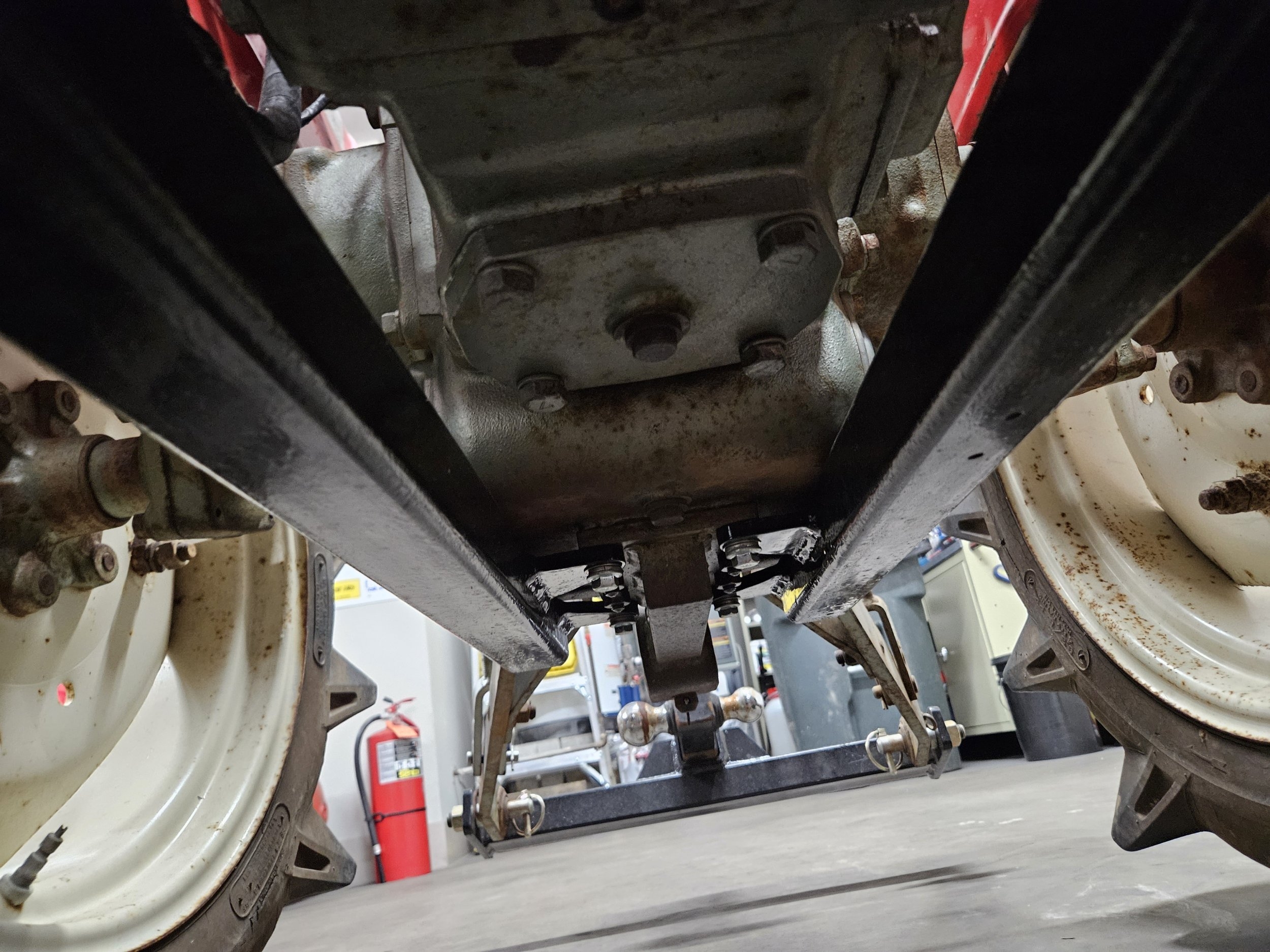

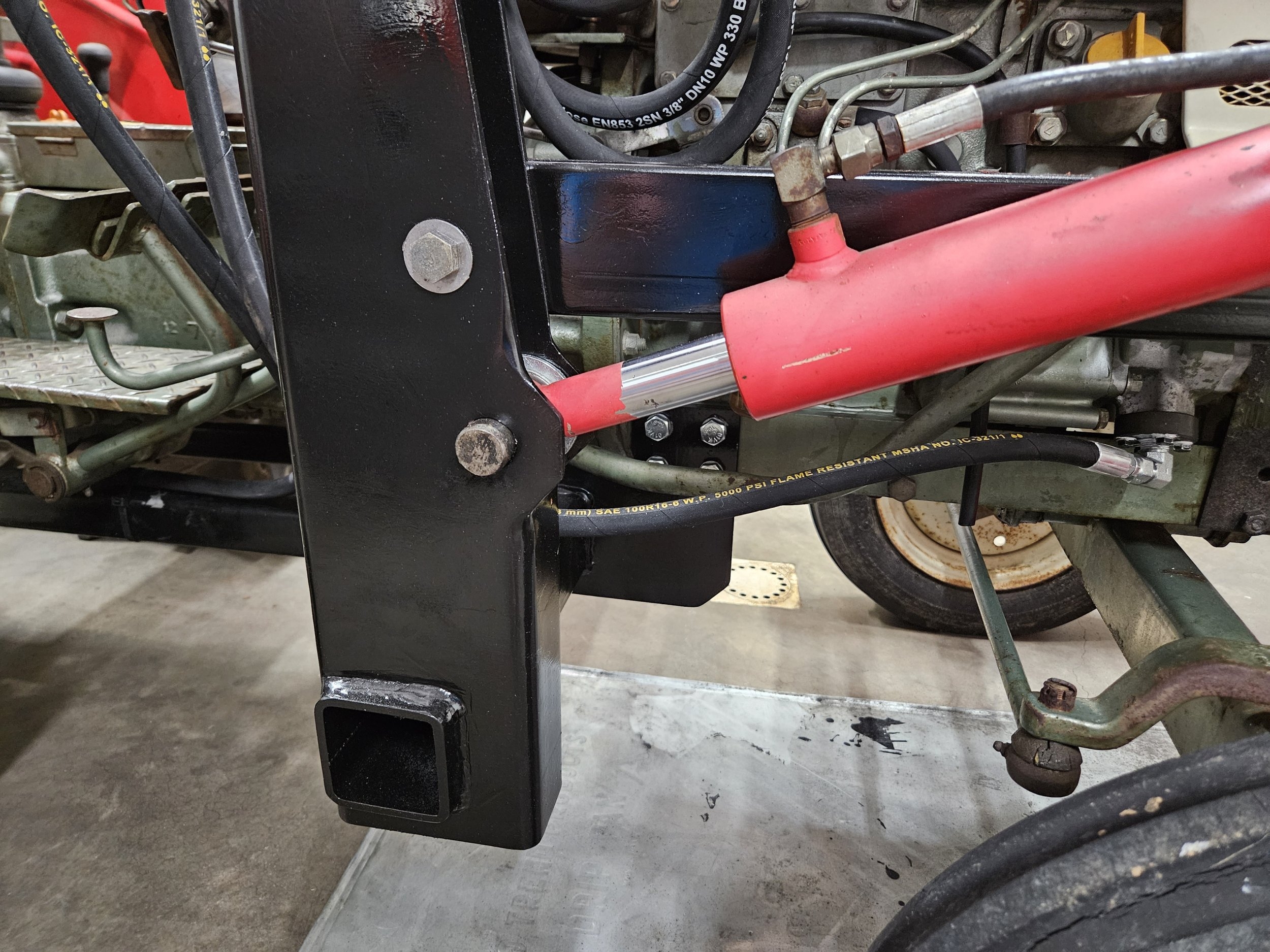

I recently built a frame to adapt a loader to my YM1500. It attaches to the front bumper, the frame in front of the bellhousing, four tapped holes in the cast transmission housing, and four holes at the bottom of the rear axle.
If I wanted to upgrade to a larger Yanmar are there any that would have the same frame dimensions? Looking at a couple 2210s because of their shuttle shift.

From my quick chk. the 1500 Front axle is the only model listed for the Front Axle Housing FAH-4190. The next larger models goes to the YM1700-2000 models.
The Spindle changes for the YM2500,3000,3110,3810 models is all I can find.
   / Frame size between Yanmar models #3
From what Carey said all those 2000 models are the same frame and axle. The 2000,2001,2002, 2020,2010,2210 etc. Not sure if you followed that or knew.
   / Frame size between Yanmar models #4
Nothing would have the same frame dimensions. The 1500 is larger than the YM1300 & smaller than the YM2000
