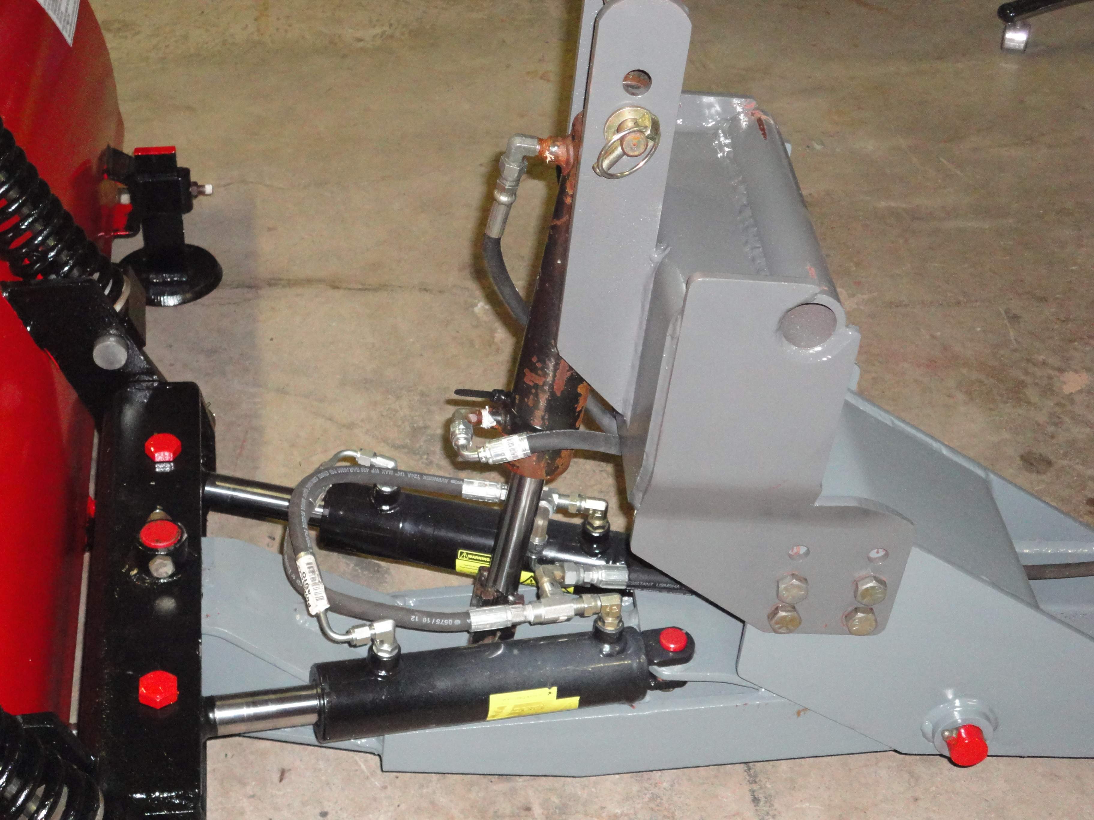

hey guys/people,
at the present i have a fel bucket mtd snoplow blade (jd 4500 4wd). want to remove fel and frame mt blade using ldr hyds. any ideas? actually i saw some very interesting ideas/framing pics a few years back but cannot find them again. i also have another set of "remotes" i use for a 3 pt conc mixer.
i'm open to most reasonable suggestions/ideas.

thanks much DM. most excellent job. i wish i was closer so as to get closer to install. the pics are very helpful. thanks again.
   / frame mounted snowplow blade #5

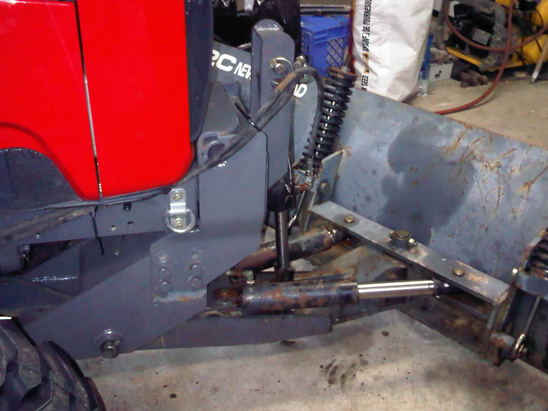

You're welcome. this year I mounted it to my new MF1635, slightly mods required nothing serious.

Not to jack his thread, would you have pics of the 1635 with it mounted??
   / frame mounted snowplow blade #7
I have the loader mounts already on it, so when I remove my loader, it slips on with 2 bolts each side, that massey would have used, takes maybe 10 minutes.
I can take a picture of the front receiver and rear mounts it is slick.

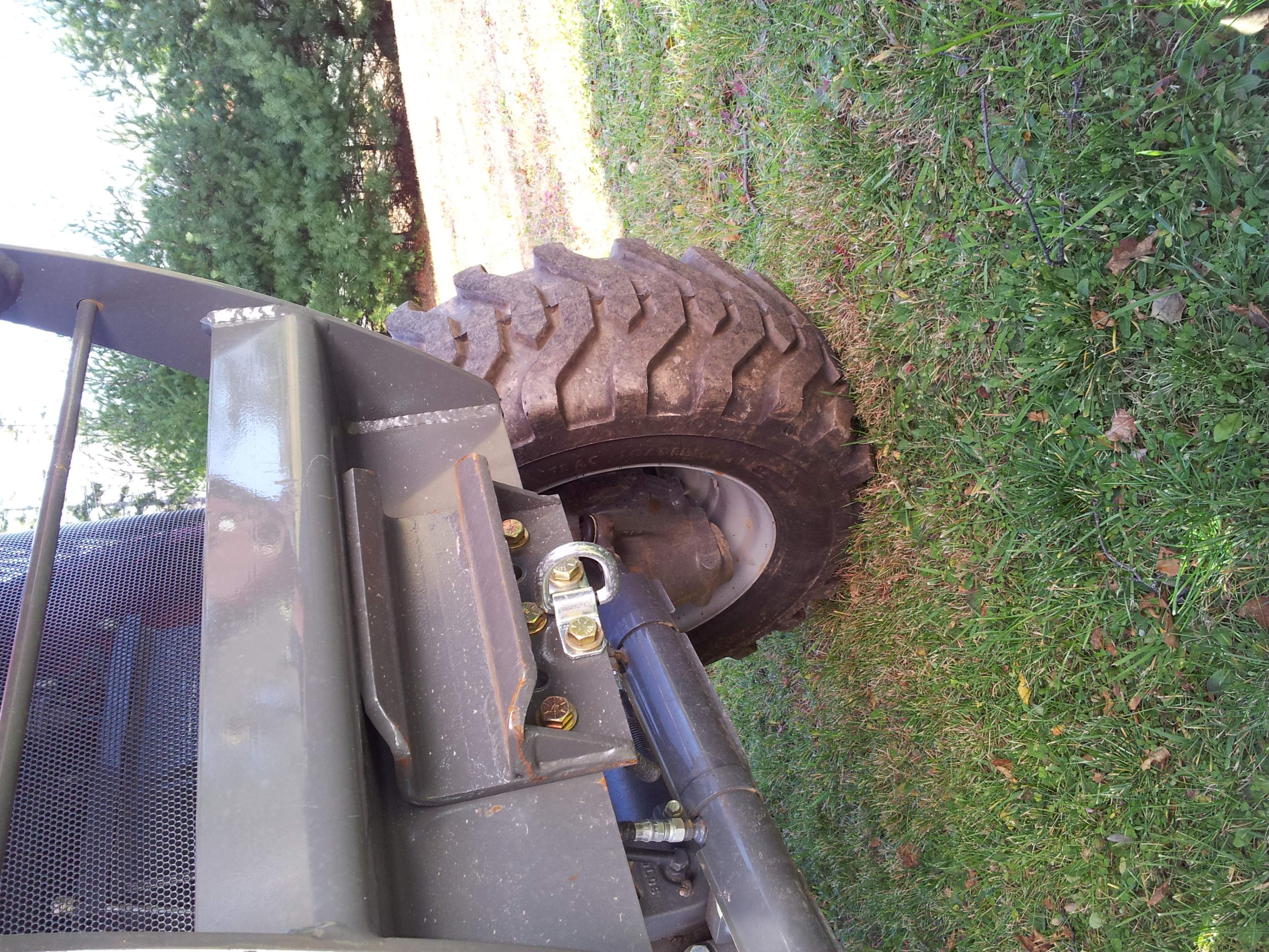

Would you please?? I would appreciate that greatly!! Could you get pics of the harness, and mount points also??
   / frame mounted snowplow blade #9
I added pictures of the front mount bracket and rear brackets. I hope this helps. mounted picture was on my 1532
