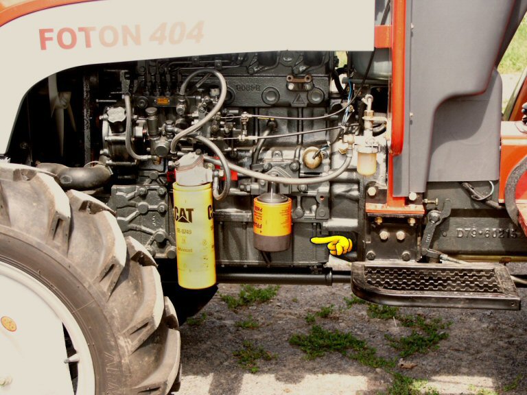

Does anyone have a cross for a Foton CX7065 Fuel Filter for a FT404.
Walter
/ Foton fuel filter CX7065 cross #2
Check to see if yours is metric. I use the carquest 86472 it has a water drain.
Does yours have the metric oil filter ? If so remove the nipple from the holder and have it machined to 3/4 so you can use cheaper oil filters. You can use the wix51515 which is 1/4 the price of the OEM metric filter.

/ Foton fuel filter CX7065 cross #7
That's what I did to my FT404...
Kobi
