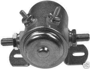

Obviously your "dealer" used the wrong relay or was improperly installed, but his wiring was correct. Properly done, this fixes most electrical starting issues.
I work with relays (which are actually remote operated switches), and breakers up to 4.16 kV on a daily basis, so what do you mean by "carbon build-up"?
The "tumbler" part of the key switch has nothing to do with the contacts within it. Which are you referring to?
It sounds like bad grounds may have been your problem all along. That would account for the relay going bad.
   / Foton 254 starting problem #42
I don't know what "key tumblers" are. The key switches on these tractors are simple 4- or 5-pin barrel cylinders with no tumblers. The contacts are metallic, as are the ones in relays, so I don't know where carbon could be coming from. The relay in the starting circuit is appropriate to keep the key switch from carrying the high load of the starter solenoid coil. If you use a good quality relay, it should last a few million cycles. A high quality, hermetically sealed relay should operate ten million cycles easily. If a relay fails early it is usually due to using an under-sized relay for the load or from having bad wiring on the load side so the contacts see high resistance and arc.
   / Foton 254 starting problem #44
There are literally thousands of different relays, there's always a chance that the wrong type was selected. And they're not all hermetically sealed. A very common and appropriate type used for automotive/agricultural starter motors is the inexpensive Ford type.
It doesn't like water. Power washing will take them out, as will snow/ice if they're mounted in an exposed position. If enough moisture is permitted to accumulate on the end where the wires connect, it can cause an arc between posts. It only takes once, and then it's new relay time.
//greg//

Thanks Greg, I appreciate that information as I believe that probably happened to the relays I had. Diesel and water had been exposed to the relays a few times problably doing something to them like you said. Now that being said I problably will try a relay inline with the iginition again but wired better so I don't hurt the key switch and less chance of wiring problems in the future.
   / Foton 254 starting problem #46
Ok. If you find you'd like assistance getting a replacement wired in correctly, give me a shout. There's always a chance that it was installed incorrectly in the first place.
//greg//
   / Foton 254 starting problem #47
This is the sealed version of the same relay.
