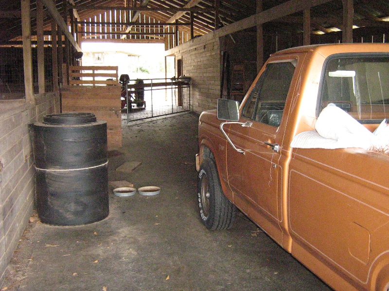

From the back end of the barn. It is a pole barn, 40'x80' with nine 12x12 stalls, a wash area (now storage), a 12x24 tack room now a shop, and an 8' porch area. I had the barn centerway blacktopped when I had the drive done. A very large barn is a most wonderful thing to have.

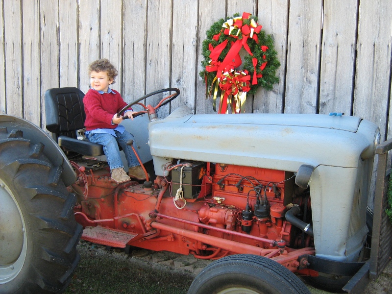

My first tractor, just after I bought the place, a 1953 NAA. I loved it. (You cannot see her in the photo but Mimi is there with a death grip on the Little Dude.) I bought it on a whim, along with a very old very heavy duty MF60 rotary cutter for $3000 10 years ago, and began to learn what splendidly useful and fun machines they are.

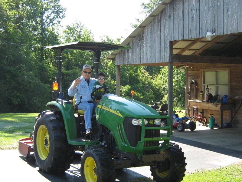

The Blues Brothers on the 4320. It's a 2006 model I bought this year. I know I'm always curious: the tractor, FEL, forks, 175hrs. evidently in excellent condition were $19,500. I've no idea if it was a good deal. Now has about 270hrs, no problems of any sort.
