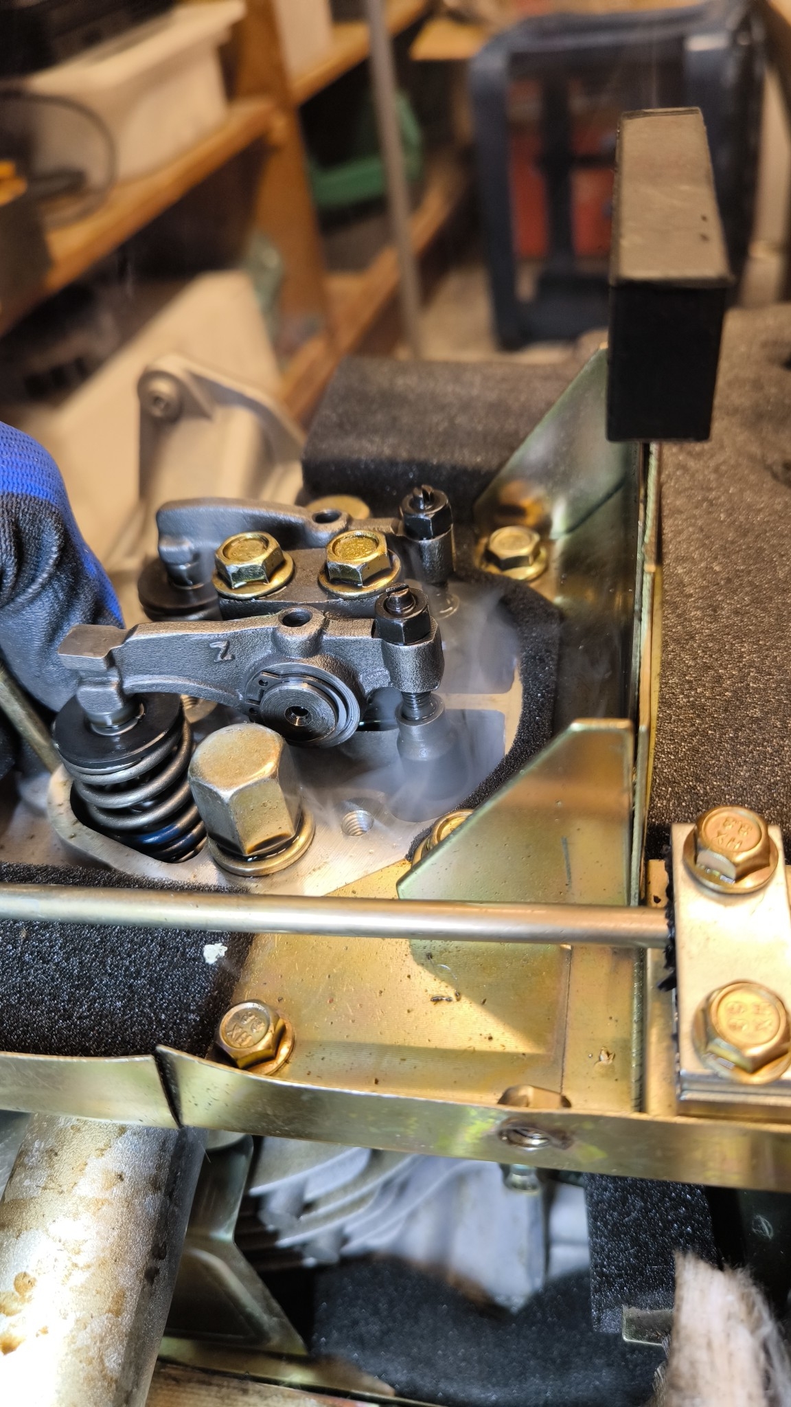

Thank you for your replies.
The valves are checked for clearance and are ok and tight.
Pushrods are in place. The decompressionlever works correct.
I attached a picture with the smoke leakdown detection

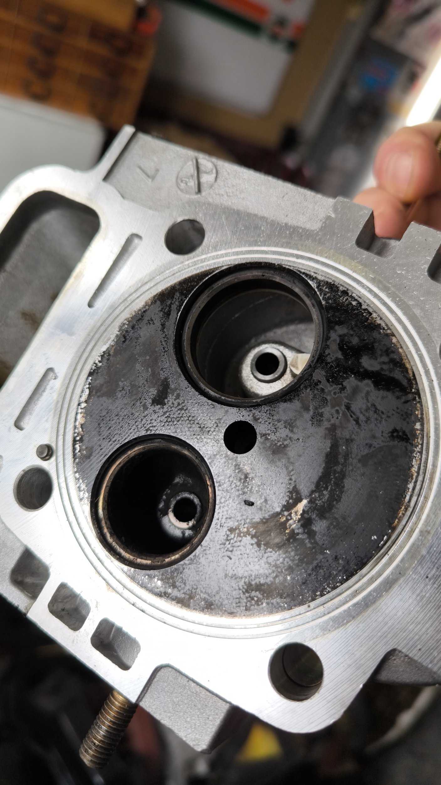

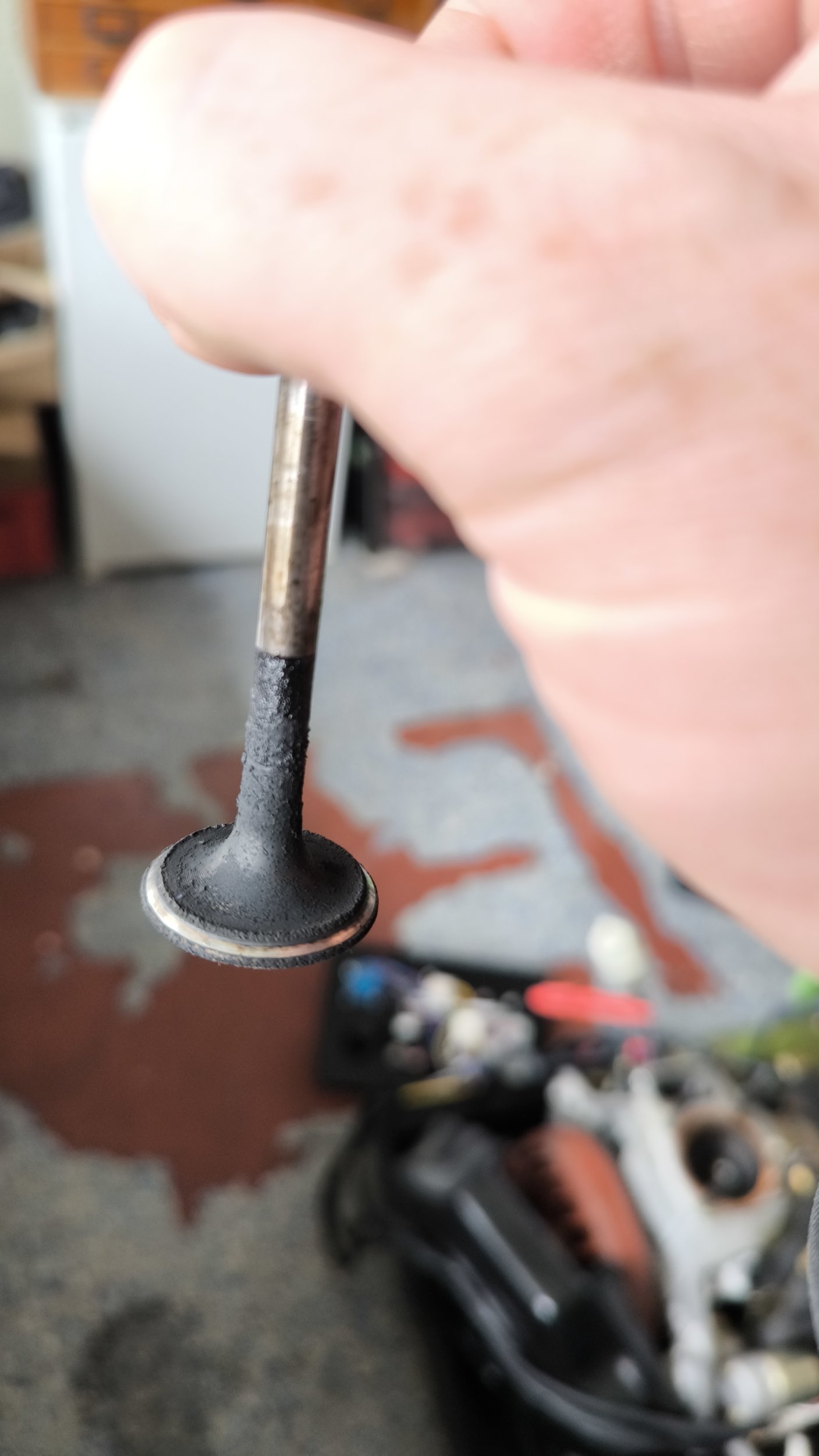

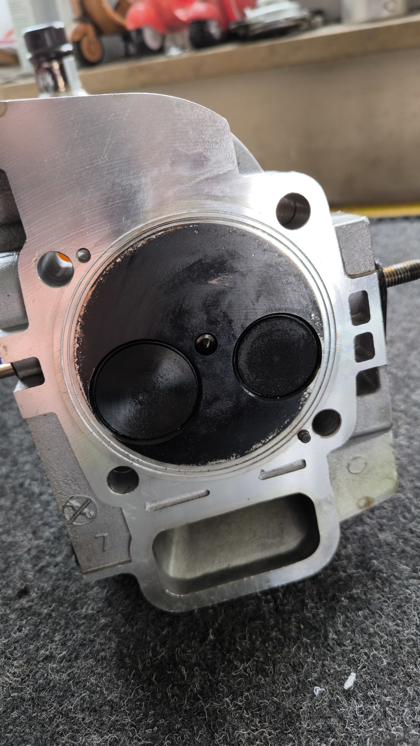

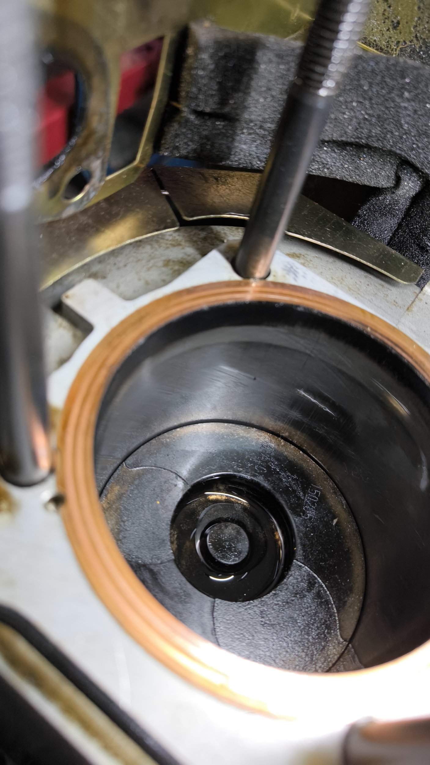

I finally managed to get the head off.
Nothing to see unnormal for me.
I tried some breakcleaner to the intake and had some light dripping through the closed intakevalve. Not much but something

There should be no leakage between valve & seat. Remove valves to see if there is something between valve & seat. Then use lapping compound to clean & verify proper seal. Results will dictate next move.

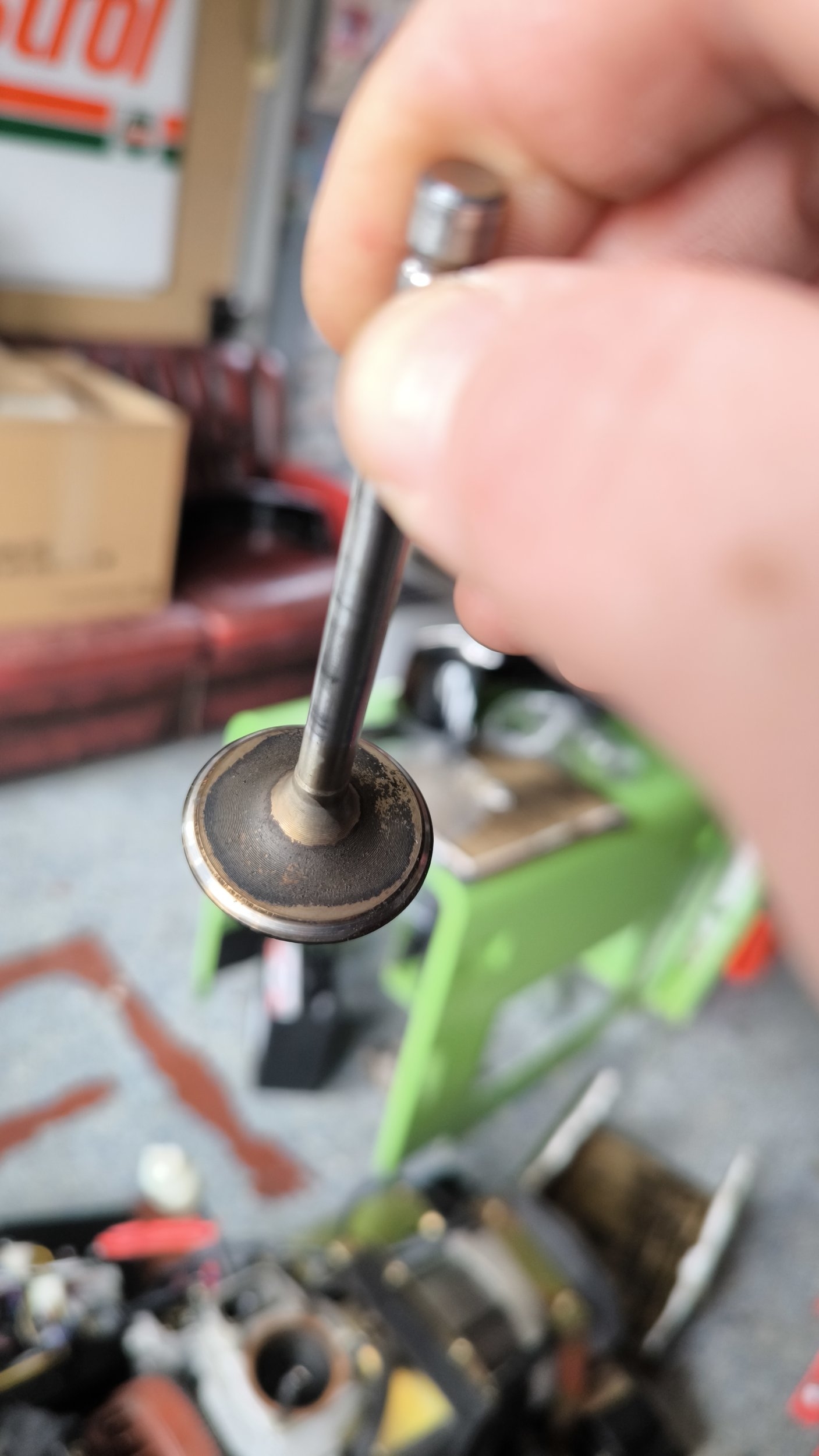

The valves and seats look good. I will refit them after lapping. The leakage was minimal. Also no exhaustgases in the intake

The seats are dirty/pitted and I’m guessing the intake valve has a spot that looks burned. Absolutely no fluid should leak by the valve & seat. Diesels are very sensitive to loss of compression. If this was a 6 cylinder engine you may not notice it but a 1 cylinder engine must be in near perfect condition to start cold.
Use compound to lap valves if they don’t completely clean up for a leak free seal replace them likewise with the seats. If they don’t clean up the seats will need to be machined. As for the head gasket being copper it can be reused if necessary.

After relapping the valves and double check them with break cleaner, the engine still does not start. Next step is to check the pistonrings. I didnt wanted to tear the engine apart but i have no other joice i guess
