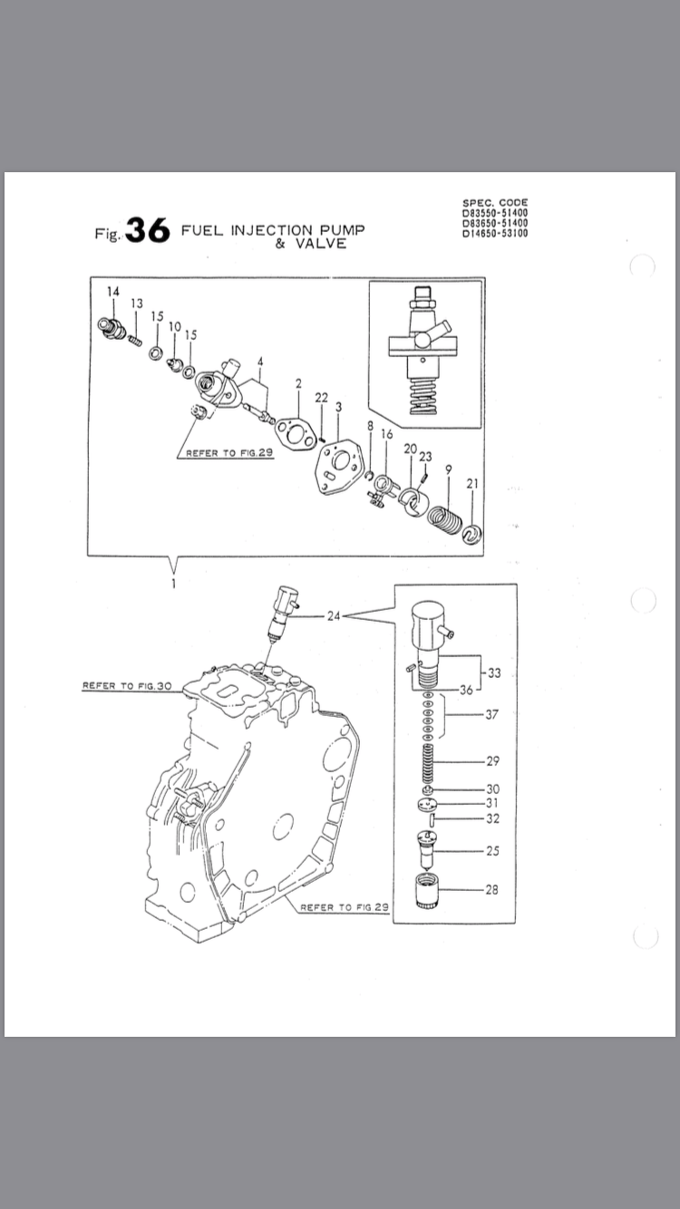

OK, well I must have f-d something up in re-assembling the pump, as now it won't even fire. I was very careful, and clean, and paid attention to the way parts came out, but clearly I didn't get something back together correctly. Does anyone have a link to a exploded parts diagram of the injection pump?

Thanks! It's close, but the delivery valve is different in the one I have, or at least there are a few more bits in the one I took apart. I'll disassemble it again and see if anything obvious is amiss - perhaps I installed the plunger 180 out, but I was careful with checking that...

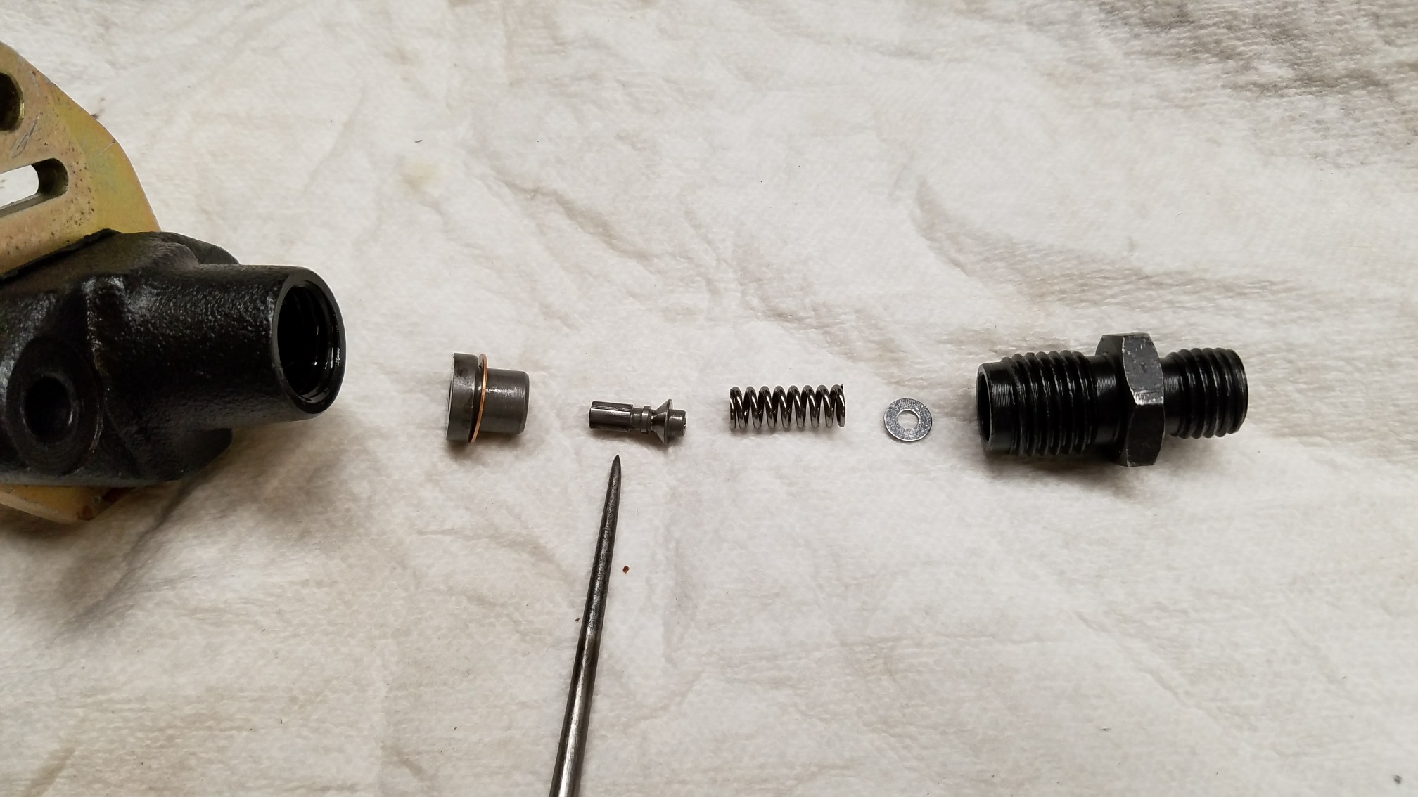

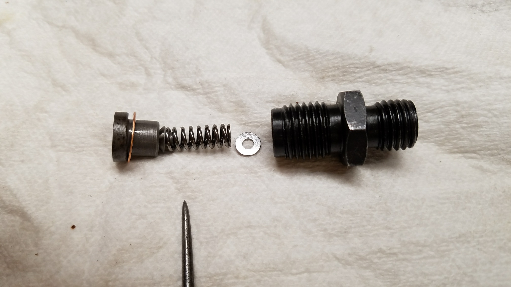

Thanks 90cummins! I think I found my mistake - I made an error with re-assembly of #10 in your drawing, which doesn't detail the pressure valve assembly, or whatever it's called. Obvious once I looked at it again of course.
I had it flipped the wrong way - the inner valve assembly where the awl is pointing. It will go together wrong quite easily if you're not paying attention to how it's supposed to work... looks like no harm done, so one more try tomorrow!
