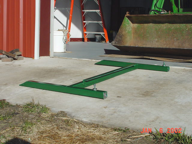

If you have an older tractor without quick attach FEL and would like some forks, here is an idea. I needed something to haul logs, brush, lumber, etc. I have never had need to carry pallets, so I was not concerned about fork spread.
About $15 and less than 2 hours and I had made what I needed. ON/OFF in less than a minute. My bucket already had 2 holes in it, so I just lined up the forks to match the existing holes. See next attachment also.

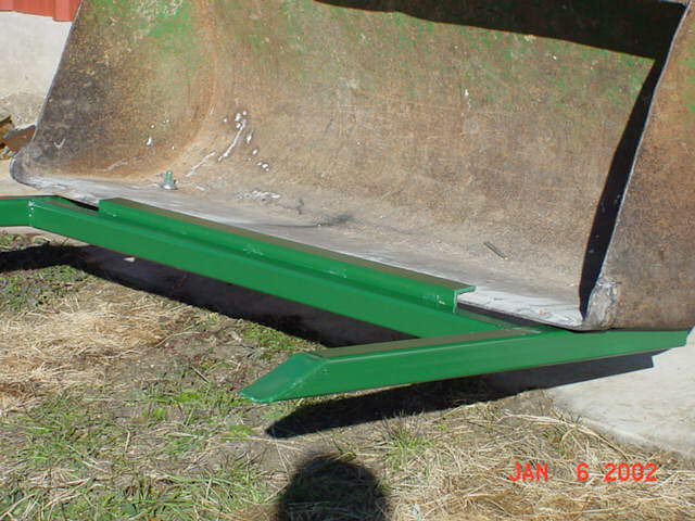

It is made of 2x2x11ga sq tube and 2x2 angle. Angle slips over the front edge of the bucket and the bolts swing up thru the existing holes. One more attachment after this.

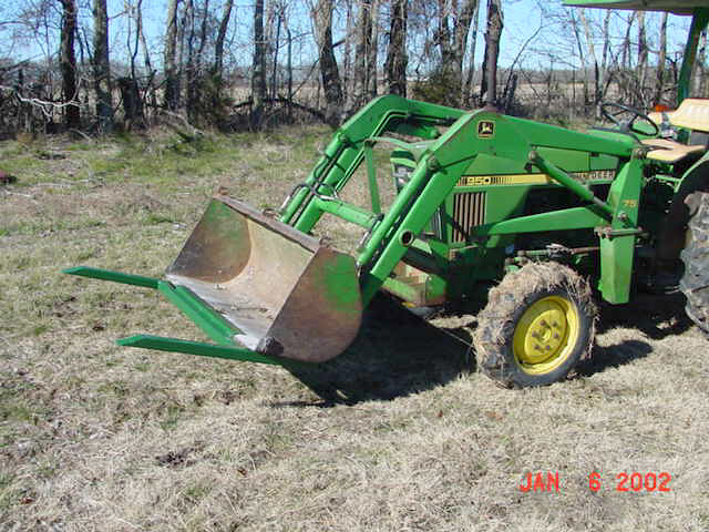

The whole thing weighs probably about 35-40 pounds so you can pick it up and carry it. Load limit? Don't know, but I can stand on the end of a fork with no noticeable deflection (about 190 pounds).

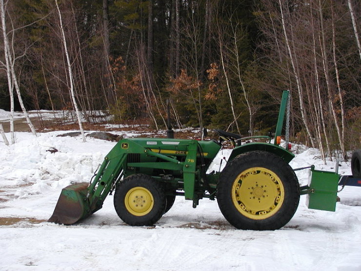

Being a fellow 950 owner, that was like looking at a set of forks on my own tractor. what year is yours ? Nice looking piece of work and a great idea. Thank you for sharing with us. I will have to keep them in mind (I saved your pictures). I also like the canopy, I am still trying to get my hands on a second hand, JD deluxe one from a salesman at my local JD dealer. Attached is a picture of my 950 with backhoe removed.

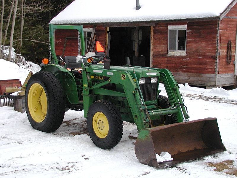

Side view of my 950, shows the new weight box.
