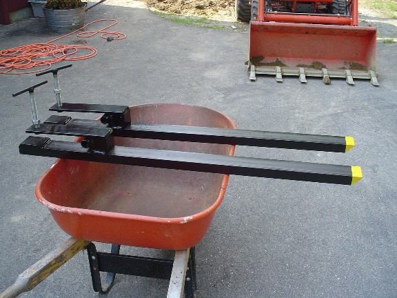

Where is the best place to get forks for a L302 loader,the kind you screw on.

ATI has a pin-type quick attach for LA302 loader type. It weights only 21 lbs. With this you could easily swap between your bucket and forks. About the forks, they have a small pallet fork frame with forks for small tractors.
I'm not sure what you mean by "the one you screw on". Do you mean the one with the pins? It's clear that you're not talking of a Skid Steer type quick attach.
/ forks for L302 loader #4
Do you have welding skills or access to someone who has?
If so then I offer a FREE set of plans to build your own. You can do this for less than $50 in materials. Plans include detailed instructions and a cut list.
The package also includes plans for a clamp-on reciever hitch.
If interested, send me a PM and include your real email address. Over 300 satisfied customers have their set of plans.

I think he meens the clamp on ones
You're right Timber... I feel a bit stupid. :eek: It happens. Sorry wrong information
/ forks for L302 loader #6
I had a set of king cutter clamp on forks for my 302 fel. They are rated for 2000 lbs and work well.

Thanks for all the info.Thanks Mad I'II take you up on those plans,I don't weld I'II check a local welder with the plands a see what I can do.I really need some of these forks.

These are the ones I have, They were not cheep but they were the ones I wanted for what I do. I do a lot of fork work. Being around forklifts all the time it is just a way of thinking
/ forks for L302 loader #9
Just a matter of caution. When building the forks make provisions for a vertical stop that prevents a log or some such thing rolling back and sitting in your seat. This can happen at full height and fully curled back bucket.

The 302 fel is under rated, we planted big trees with those forks, weight well in excess of kubota's specks!

Thanks Mad for the plans,I'II have check on the price of material.couldn't beat the price either.
Timber ,those are someheavy duty looking forks.I see where Northern Tool has some 8000lb.rated for $249.00,they'd probably do for me,the sign doesn't weigh a1000lb or so.
