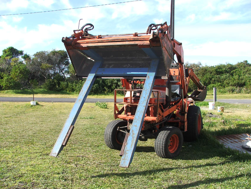

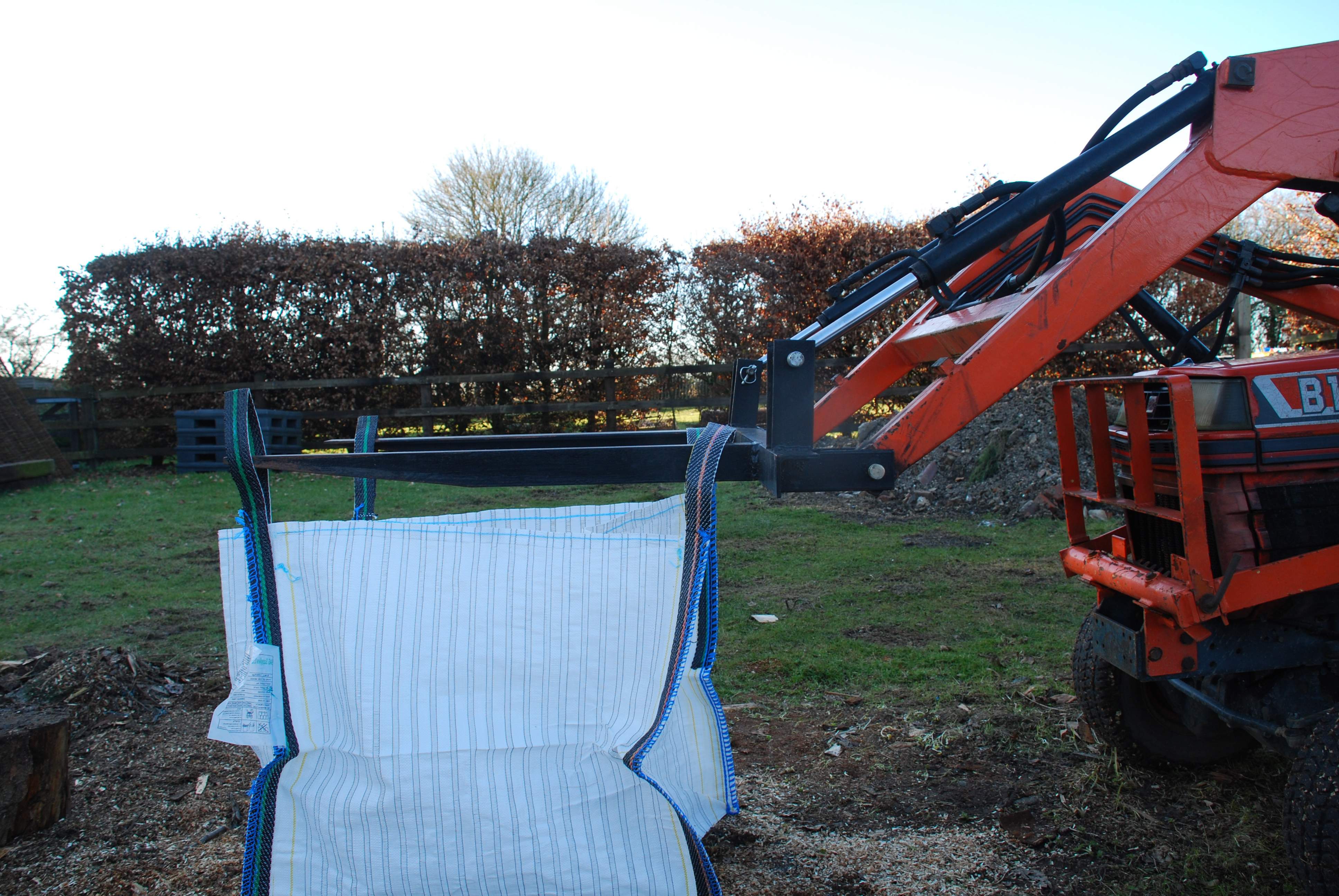

I made one from 60mm x 60mm x 6mm angle iron and a few bits of flat bar. The advantages of this are 1) cheap - just had to buy one length of agle iron and 2) light - lighter than the bucket - the more the forks weigh, the less extra you will be able to lift 3) it is quick to cut and weld.
Initially it was a single length across the forks, however I put a twist in it so I boxed it in between the arms with another piece of angle.
This is good for my KBF200, and I have had a 300Kg pallet on them - but your B3030 has twice lift, so I recon you will need much thicker angle iron - at least 8mm, if not 10mm. I would be wary about making it with much larger angle as it won't fit under some pallets.
I used angle grinder to shape a wedge on front of forks to assist loading. I am going to make a level indicator rod to use the existing mechanism to show forks are level at ground level as they can be hard to see.
Photo attached - albeit holding a dumpy bags by its straps to fill with wood.

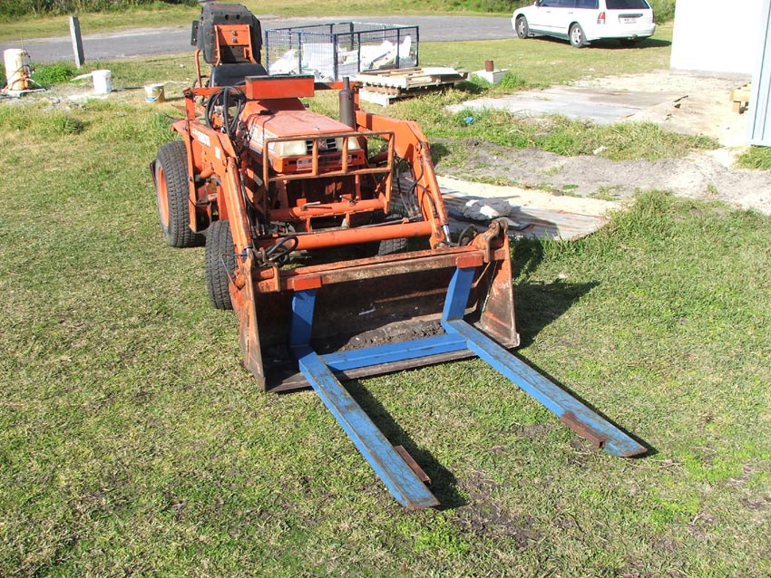

These just slip into the bucket. Take seconds to fit, and the stress is distributed to the top and bottom of the bucket. Make 'em long enough to be seen easily from the seat. Don't make them too heavy like I did. When they are attached to the front of the bucket your lift capacity is greatly reduced so there's no need to over-engineer them or you'll just reduce your lift capacity even further.

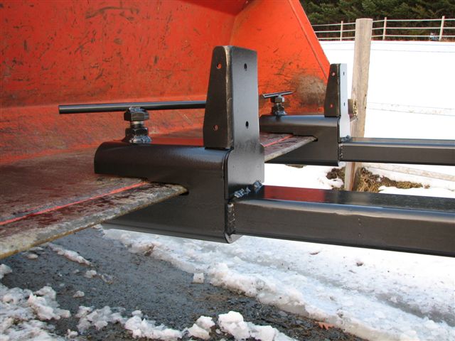

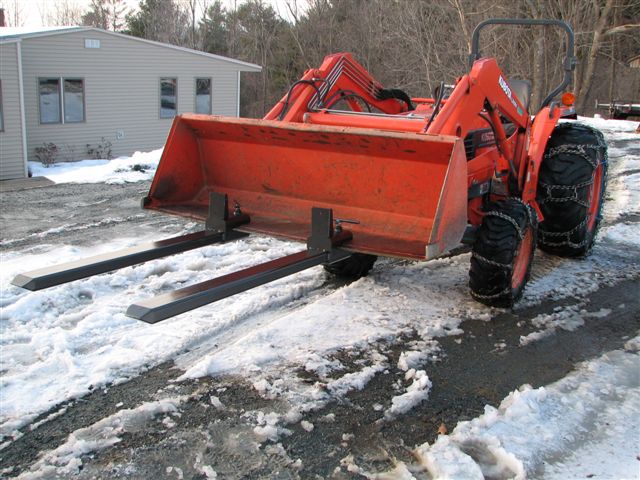

Here are my home made forks. 2 x 4 x 1/4" wall rect tubing, an 8" long piece of 5 x 5 x 1/2" wall square tube.....with the bucket slot cut with a plasma torch (Hypertherm Powermax45)......a few other pieces cut and welded. Material cost about $ 60 per set. I have actually sold a few sets of these!

/ Forks for FEL #13
I sell them for $299. The usable length is 44", you can bolt a 2 x 4 piece of wood to the upright, they have been tested at 2000 lbs....17" out from the bucket. Weight is approximately 62 lbs per fork. The standard clamp slot fits the kubota bucket (4310 tractor) perfectly.....I can custom cut the slot if a profile of the edge of the ucket is provided.....from the cutting edge back 6".
I have used this design around the farm for two years.....can't break them! I will sell just the clamp assembly if you want to provide your own 2 x 4 tubing for the forks...and do some welding. $79 per clamp. Those prices are unpainted. I hope I don't get busted for advertising.....I was just showing a good fork design that anyone with a set of torches and a welder can build.
