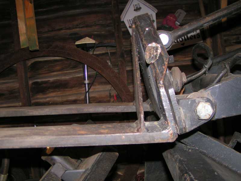

This question is for someone who has pt forks, or better yet, has adapted other forks with PT adaptor. I picked up an old set at auction yesterday that I'm going to have the adaptor plate welded on. What I need to know is, what angle should the adaptor plate be installed at so you get the proper amount or rollback and dump? I am guessing about the same as the buckets but want to hear it from the experts.
/ Fork question #2
Attached is a picture of mine on our PT425(taken just for you about 5 minutes ago).... from the picture, you can see that they are attached to the mounting plate at less than a 90 degree angle, and there is a thinner plate welded vertically at a 90 degree angle.

MR, Thanks for the pic. About what I figured as far as the angle go's. The forks I got are the skid steer quick connect type and the backing plate is straight up and down, so I'll have to have the welder build in an angle for PT plate. By the way, I payed $350 but PT wants $1200 last time I checked. I think yours were less becaused they are fixed rather than adjustable.

JJ, The forks did come with the carrage frame, the type used on a skid steer. I plan to mount the PT attachment plate to the back of it. It looks like the PT dosen't have as much role back as a skid steer so the PT plate can't be mounted flush with the back of the fork's frame, it will have to be angled forward some what. I think the same angle thats built into the large bucket will work but I will study it some before I get it welded up. Oh! one of the forks has that hole drilled in it. You better check and see if you still have yours. /forums/images/graemlins/smile.gif

/ Fork question #11
I added about 3 - 4 inches of steel at the bottom of the plate to increase back tilt. I wish i had added more.

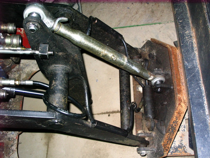

/ Fork question #12
Love to see a pic of that
/ Fork question #13
Here is a picture showing the metal added for the angle of the plate on my bucket as well as the adjustable top link i used to replace the fixed one.
Amazing how rust gets magnified by flash.
/ Fork question #14
What's the advantage of an adjustable top link? I see threads at the top and it appears to adjust by rotating the link body by only an inch. Just curious.
/ Fork question #15
It is a standard tractor adjustable top link threaded like a turn buckle. There is quite a bit of range of adjustment to it (almost double the length of the top link although fully extended would be weaker). It is set shorter than the fixed top link that came with my PT. I seldom adjust it but it is nice to be able to when i do need it. I actually need to find a shorter than normal top link. There are times where even shorter would be nice.
