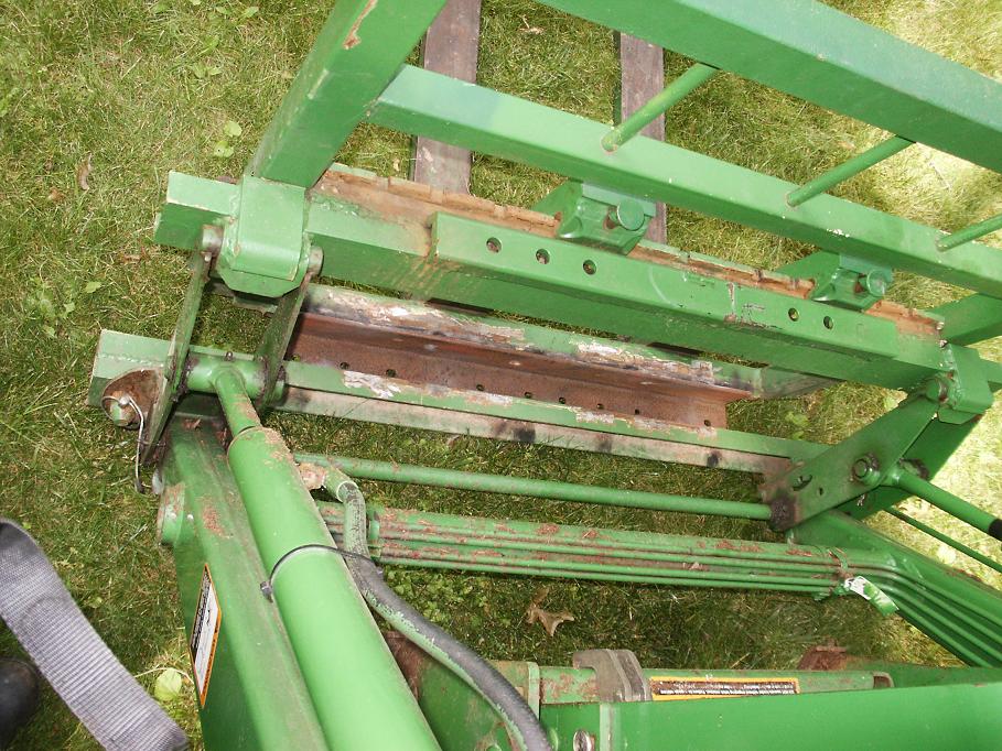

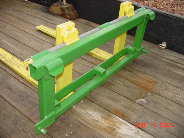

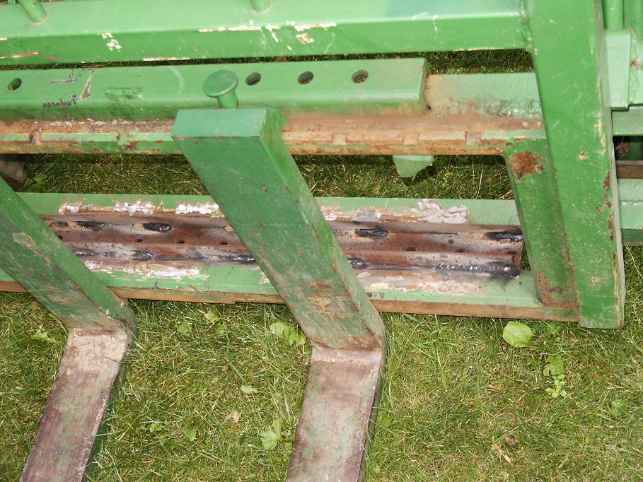

When I built my forks I realized I should have built in more curl when they're all the way down. After an embarrassing mishap that I won't go into I decided I'd better modify the forks. I bumped the bottom out three inches. They work much better now.

/ Fork modification #2
I find it a very rare (and valuable) trait for someone to acknowledge they messed up. Nice simple mod and some priceless experience. Thanks for sharing your mistakes ... your little blunder will save someone out there from making a similar one
/ Fork modification
They worked fine before but when going down a slight incline thing(s) could roll off the forks. Just letting folks know if they're going to build their own be sure to bump out the bottom of the frame.

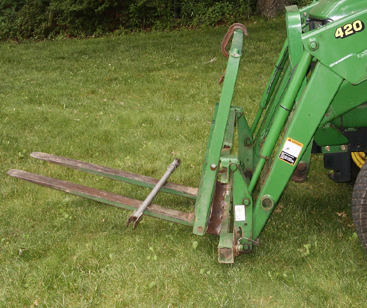

/ Fork modification #5
Same loader, same problem, but slightly different forks. I "solved" it by mounting the horizontal section of the forks at an upward angle, but in doing so I changed the 90 deg angle to the back bracket to about 75deg. Fine for logs but a PIA for things like fridges and stoves.

/ Fork modification #6
MD, don't feel bad-mine have the same problem. Gotta get out my welder soon to fix them, I am just going to put spacers on the plates that hold the pins though.

/ Fork modification
Are you saying on the original design, when the curl was all the way "back" that the forks were level with the ground, so you needed to fix that?
I've the Deere forks, and have never noticed a problem, and will have to check now to see what position they are when "curled back". :)
Looks like you have a good build there.
Yes, when all the way down they had only a slight curl back. I added a piece of three inch angle iron to give them more curl.
