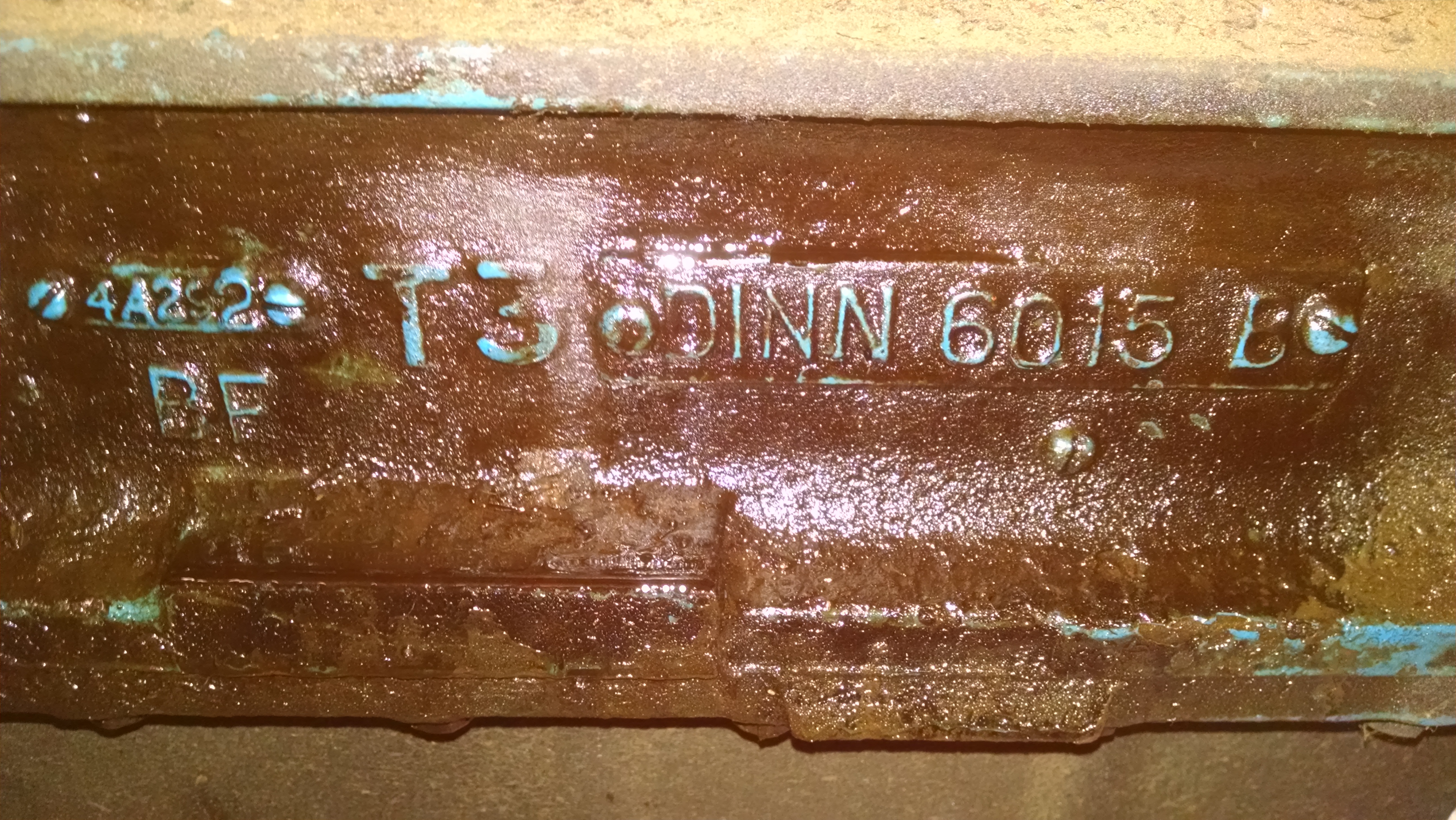

I am purchasing a Ford 5000 from my mom (She's getting rid of tractors to us kids before auction). I have a serial number I just can't make sense out of. Can anyone help me? I will add a pic I took.
   / Ford tractor identification help!! #22
That's a casting number, not a serial number. The serial number, model code and unit code are hand stamped (not raised characters) in the horizontal surface behind the starter and below the fuel tank shutoff. Also found on a foil tag on the underside of the hinged half of the hood.

Thanks Rick!
That would make sense! I appreciate it. I will do some more searching for it. Thanks again!
