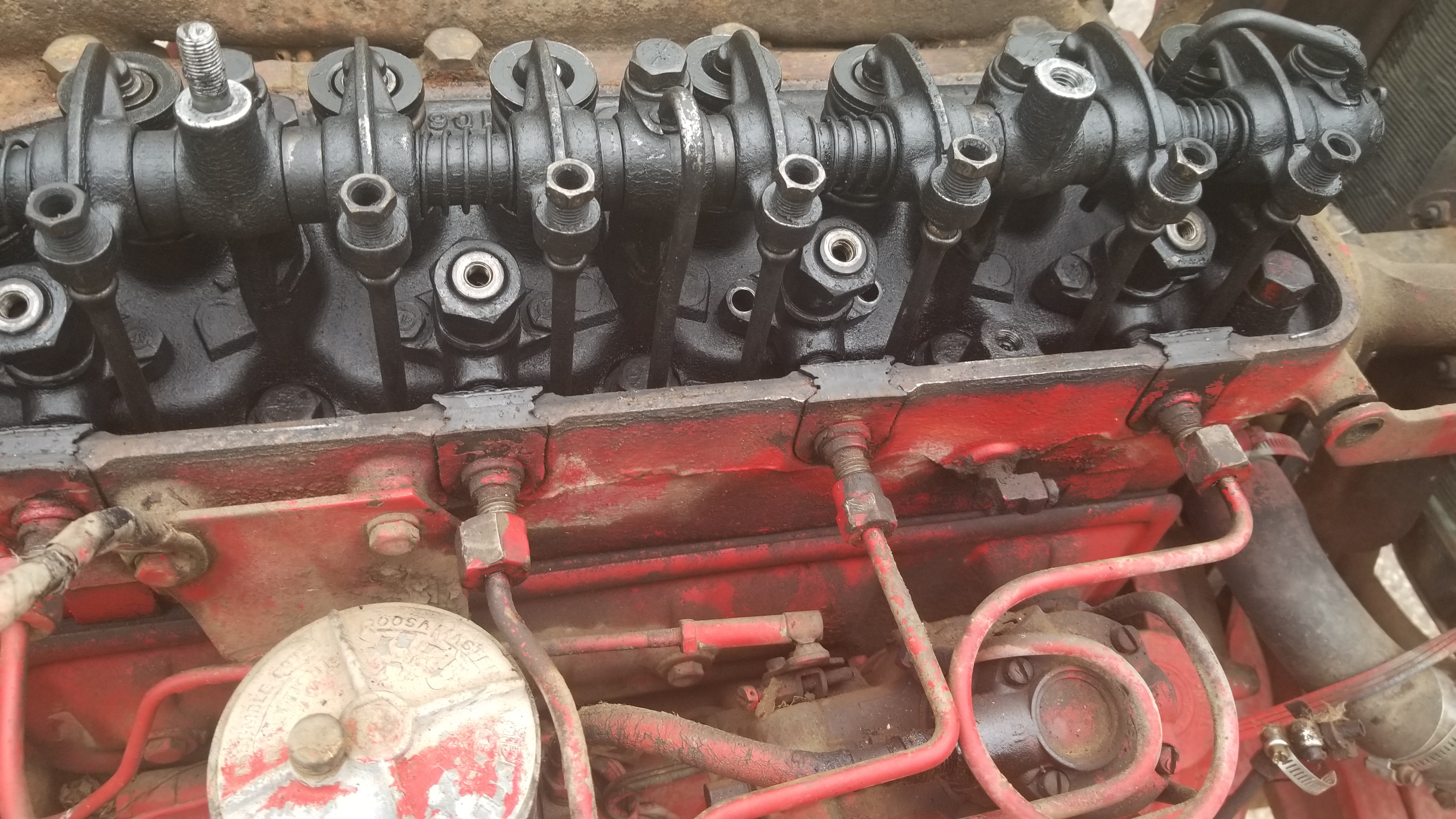

I have what I believe to be a Ford PowerMaster 801 diesel engine swapped into a jubilee. The tractor has been sitting for ten years and the motor is stuck. I wanted to pull the injectors and soak the engine with oil, in hopes I can free it up. Would it be easier to pull the head instead of the injectors? I am having a difficult time removing them. I have a service manual on order, but it won't be here for a few days.

How have you verified the motor is stuck? With the tractor sitting for 10 years the clutch could be stuck as well. If the motor is stuck, you may want to consider searching for a replacement gas engine rather than going to the expense of refurbishing the diesel engine just to tear up the Jubilee ring and pinion. The ring and pinion support in the Jubilee rear might not take the torque of the diesel engine.
