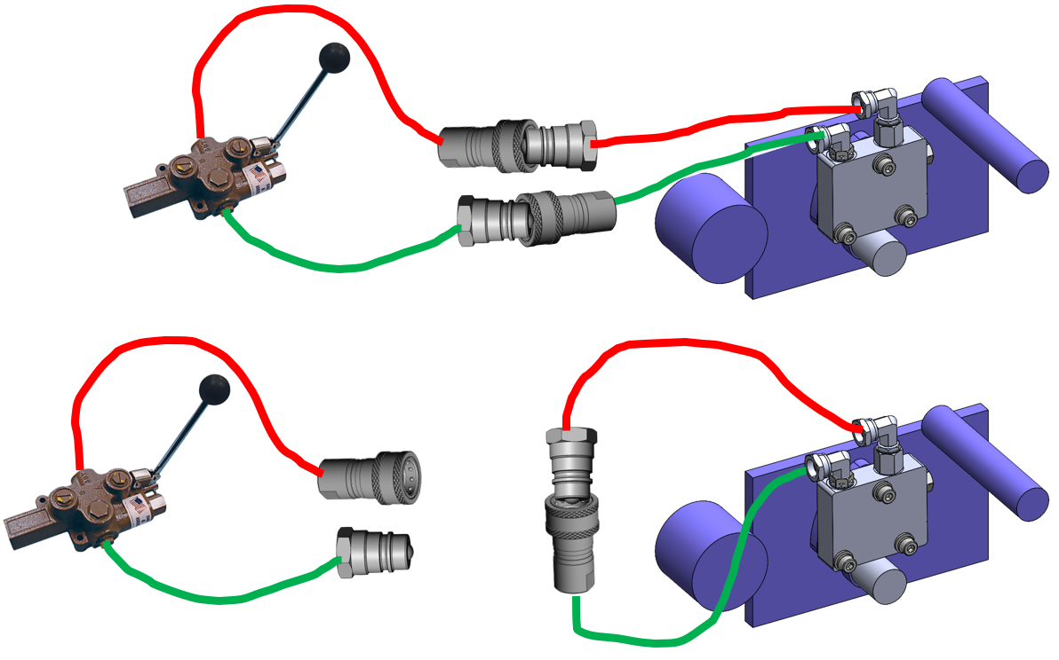

THanks for the info, makes sense why I'm not getting any flow. The splitter does have a diverter valve since it splits both ways. Where does the PB adapter plate mount? At the distribution block or by the sump return?
   / Ford New Holland 1720 (and others) Rear Remote Valve
#52
It mounts to the area below the seat/above the rear axle.
   / Ford New Holland 1720 (and others) Rear Remote Valve #53
So if I buy that adapter plate, bolt it on, I'll get remote hydraulics to run the splitter? Am i reading that all correctly?
#54
Yes, but you have to make sure that the valve on the splitter is open center. You also have to loop the adapter plate outlet to the inlet when the splitter is removed from the tractor or it will block the hydraulic flow to the rest of the tractor. The picture below is an installation diagram of the 1710 power beyond adapter that I manufacture.

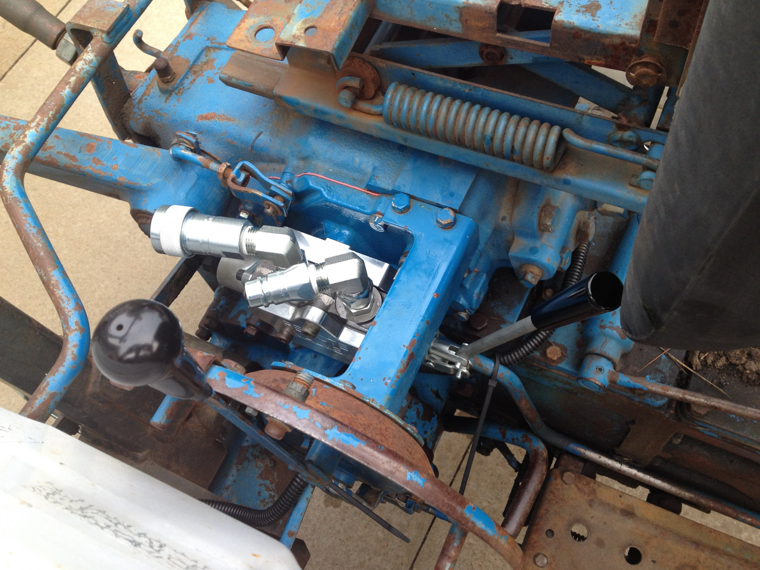

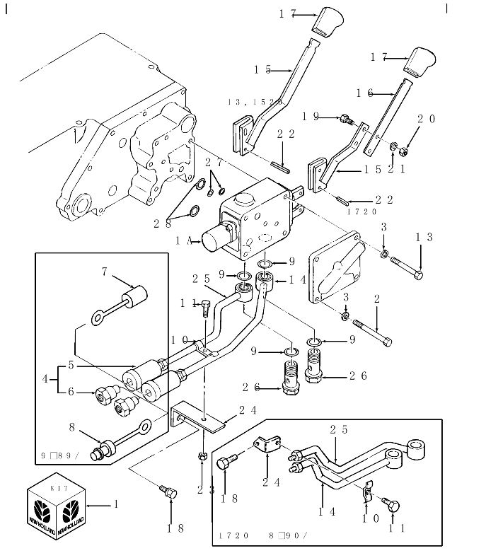

Hi All,
I'm trying to gauge interest on people looking to add a rear remove valve(s) to the 1720. I've been making a kit for the 1710 (see picture) but have come across a few people looking for a kit for the 1720. This would be a replacement for part number SBA340002301, which I think is NLA. I believe this will fit the 1320, 1520, 1620, 1715, 1720, 2110, and 2120 tractors. I've just become aware of a 1720 nearby that I could use for taking measurements and developing the kit if there's actually any interest. This puts a hydraulic valve right under the seat, rather than a power beyond adapter like Tisco or SMA HV4945.
Here's the link to the 1710 rear remote thread: Ford 1710 Rear Remote Valve
Ted
View attachment 717944 View attachment 717945
Crazy i ran across this. I am looking for a kit for my 1720 right now. Would love to see what you came up with.
