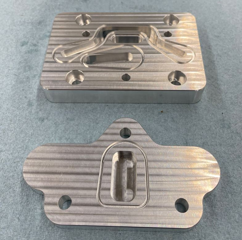

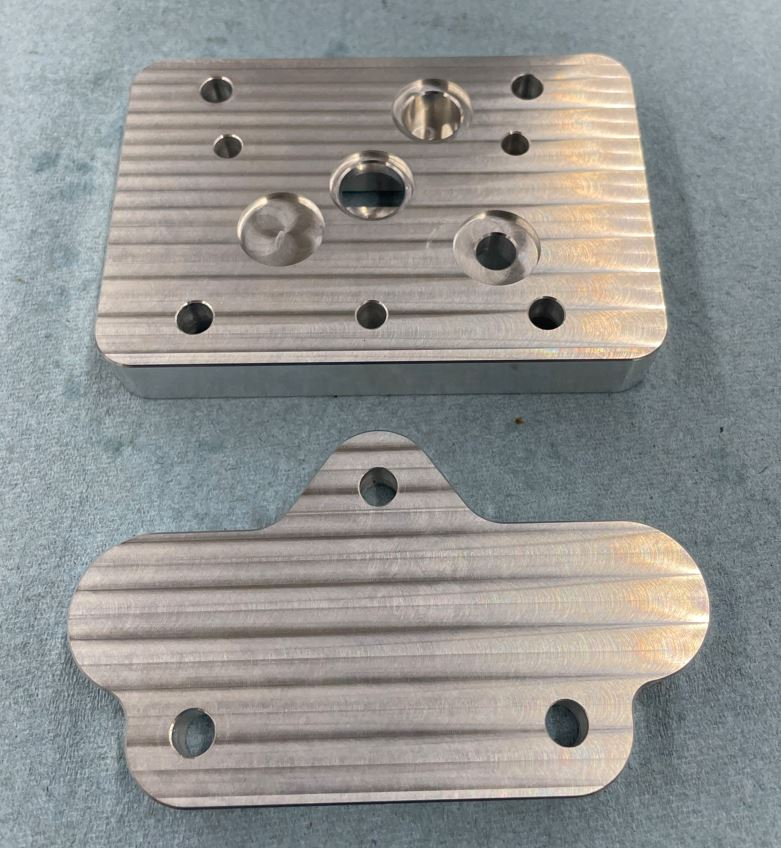

I've been working through a pretty large backlog on both CNC machines, and have a bunch of urgent engineering consulting/design to get done. But, I've made progress on the adapters and handles. I made a few updates to the adapter to make the oring installation easier, and also have a preliminary handle design (for the 1720 at least) based on SJ83's handles. The dual valve handles are a bit tricky, but I should have a good starting point. I did get the first updated adapter set machined last night and it looks good, so I'll be running ~10 more sets shortly.
   / Ford New Holland 1720 (and others) Rear Remote Valve
#30

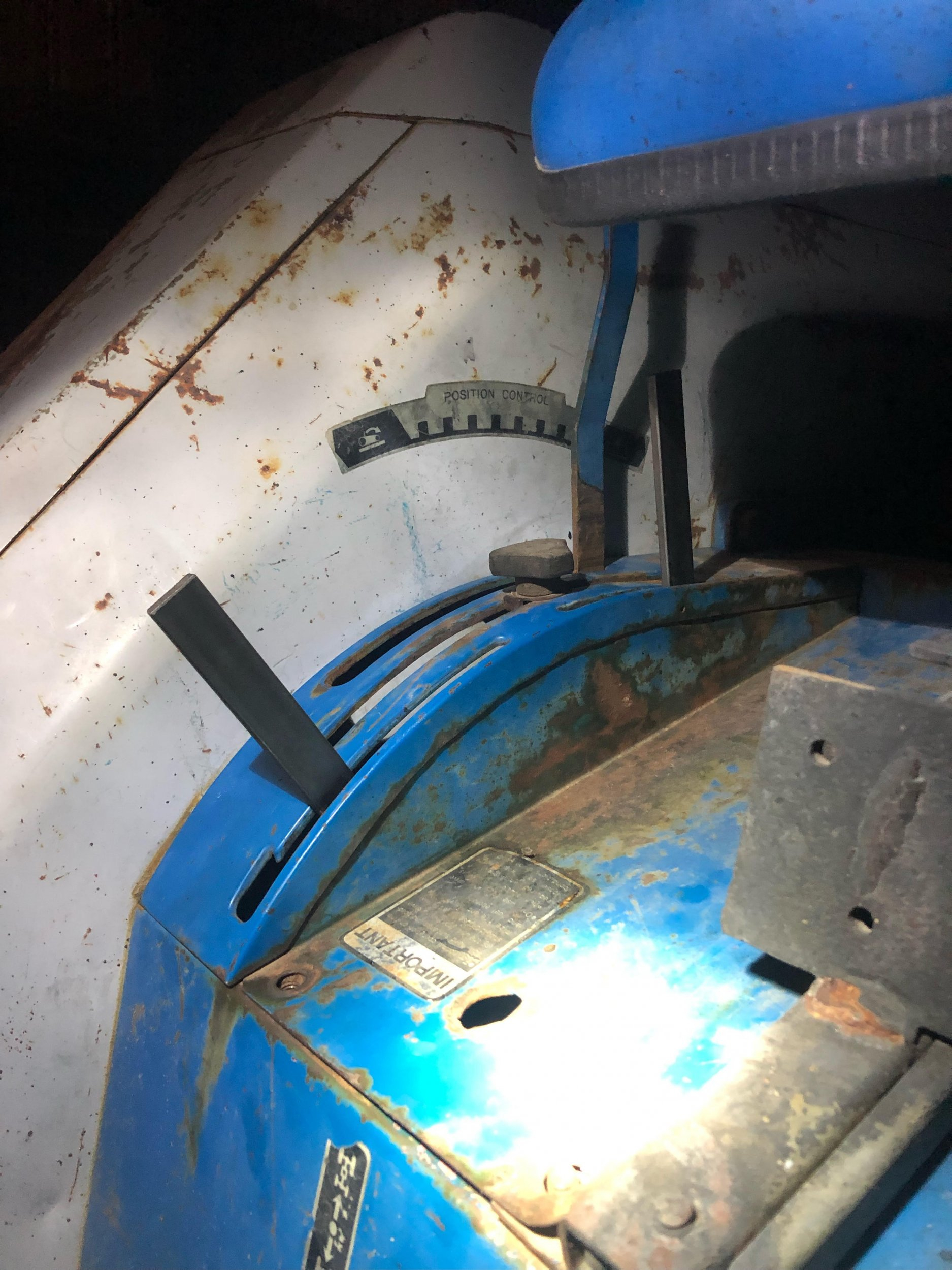

I finally got a batch of adapters machined and the prototype 1720 handle set completed. I think the handles turned out nicely, just a matter of whether they fit correctly or not.

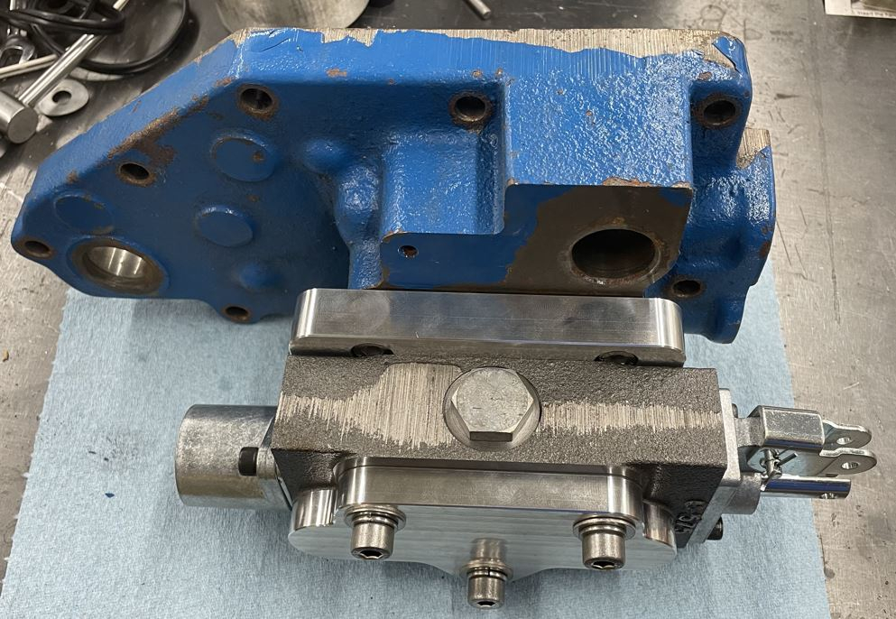

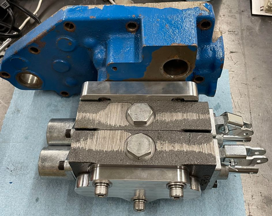

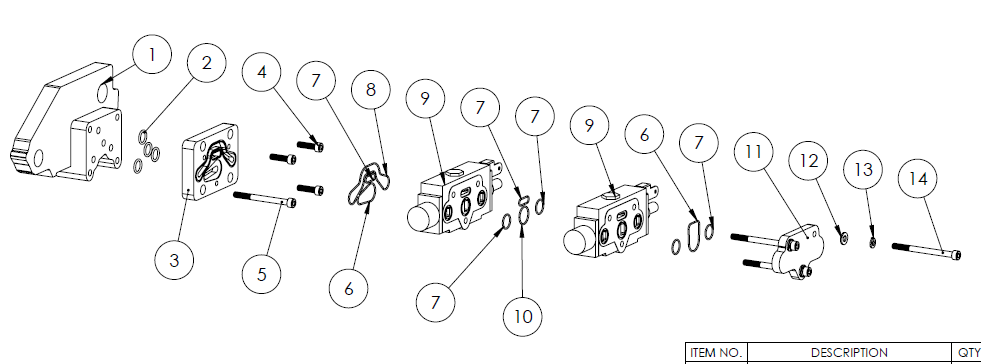

The kit with a single valve, adapters, orings, and handle is $500. The dual valve kit is $650. The kit isn't too hard to install, see the pic below.
The 4 orings closest to the tractor are 20.4mm OD x 2.4mm wide, a standard -114 oring is close and will work.
   / Ford New Holland 1720 (and others) Rear Remote Valve #33

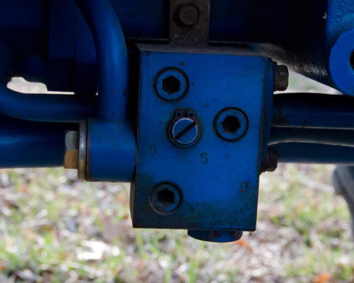

I currently have a loader installed on my tractor. It is plumbed in off the manifold bock below the brake pedals. Would your kit work along with that?

This block?
That's the diverter/relief block. If your loader is plumbed into that then the remote kit would work fine. The remote kit uses the hydraulic flow between that block and the 3pt system.

Actually, maybe I'm not right. Are you able to use both the loader and the 3pt at the same time, or do you have to turn the screw on the block like the manual hints at? Any 1720 owners know the answer?

The loader and 3pt can be used at the same time on mine and my loader is plumbed in to the block pictured in post 36

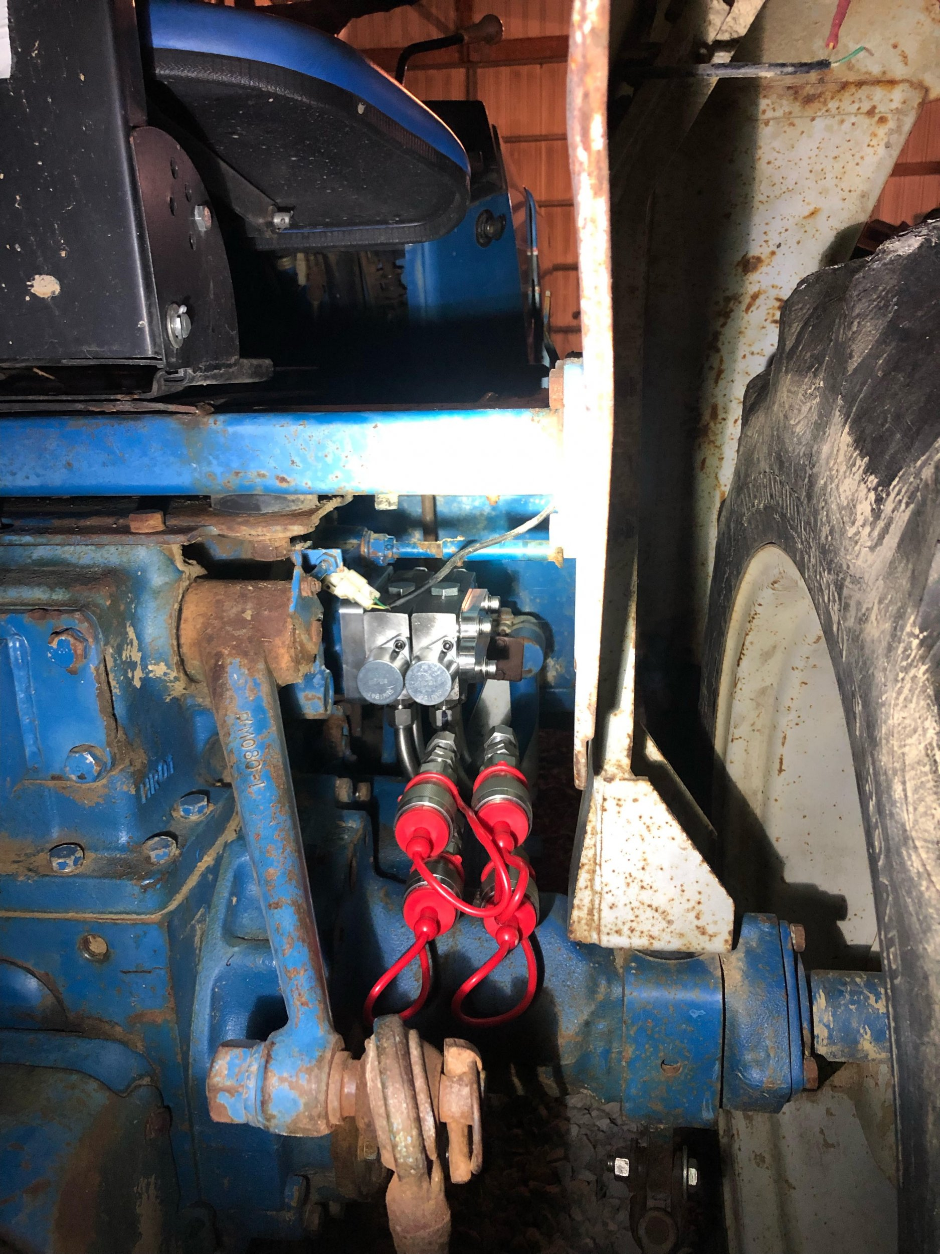

Do you have any pics with your kit installed? Im curious how the levers will be
I assume the rear remote valve is a spring to center valve. loader works fine if remote valve is in center. You won't need to use both at the same time. That is if you are actuating the rear remote, you probably are not simultaneously activating the loader.
