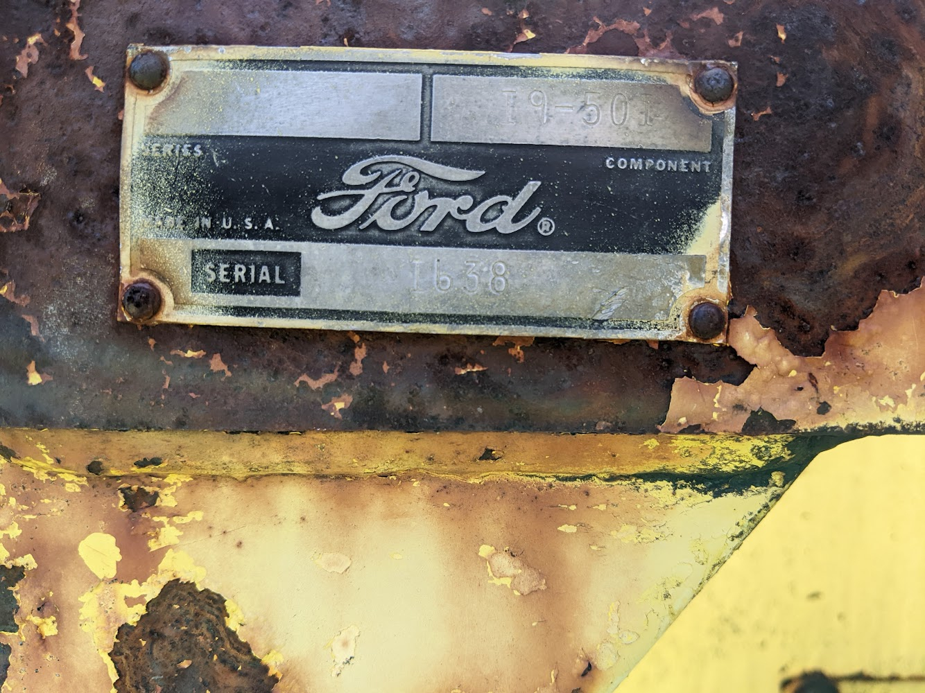

I have a 1968 4500 ford tractor , with a frontend loader marked I9-50I , That wont find any part's for it , I need the bucket cylinder rebuild kit's . any idea's on a ford model # for that loader?
Thanks Daniel

The recommended loader would have been a 740 but I don't know if that's what you have. You could remove the cylinder and have it rebuilt at a local hydraulic shop rather than trying to track down a kit. I used Tractor Data to find out what loader should have been on the tractor.
TractorData.com Ford 4500 industrial tractor attachments information
